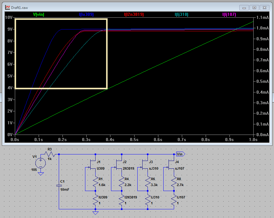

No more J310 in my stock.... can I use J107 instead... seems to have comparable Idss but much higher Cdg.... ?!
Yes you can 🙂 but change the resistor (from 3.3k) to 2.7k (the current set should be (about) 1mA).

Can I also use J107 in the amp's output buffer ?
Thank you Frans.
I did that and it works fine, the "problem" being that there is a -1.5V offset now, since the J107 has a larger IDSS. That is no issue for circuit performance, just limits a little bit the headroom which is still very high...
But it is a compromise... I will keep searching for j310 then 🙂 What Idss would you recommend ?
Try the J109, at IDSS = 40mA (thats the center value for J310 but the lower datasheet limit for J109). That should be fine, as at these currents the threshold voltage impact is pretty big, so the devices will perform quite similar.

A picture tells more than a thousand words, so here is a picture.
The voltage (Vgs) of the mosfet is about 4V, the current that is (selected by me) wanted in the Jfet is 1mA. The picture shows resistor values for popular Jfet's to accomplice this (1mA). What can be seen is that, in fact, the J310 is the most marginal of the shown Jfet's (it is just capable of supplying the wanted 1mA).
Any of the Jfet's shown can be used (and I am sure there are many more) but you need to change the resistor value and indicated.
