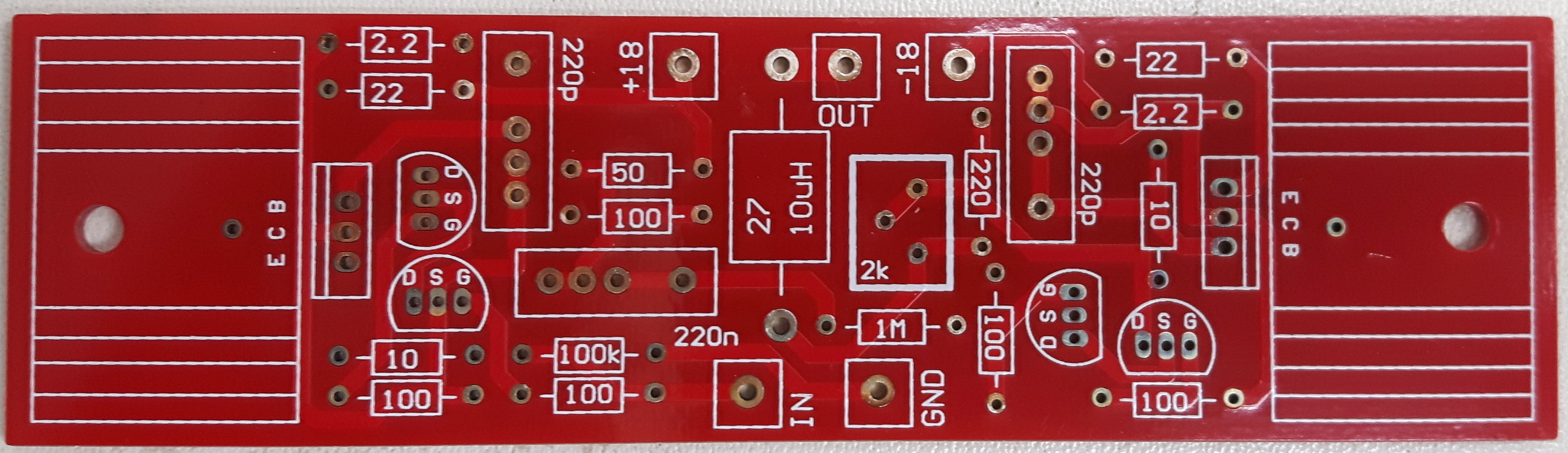

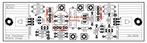

To get back to the Paradise build, just finished unsoldering and resoldering the capacitors on the Calvin boards, because the silkscreen and the markings on the PCB seem to be in conflict with the traces on the PCB.
The image shows the actual connections on the PCB.

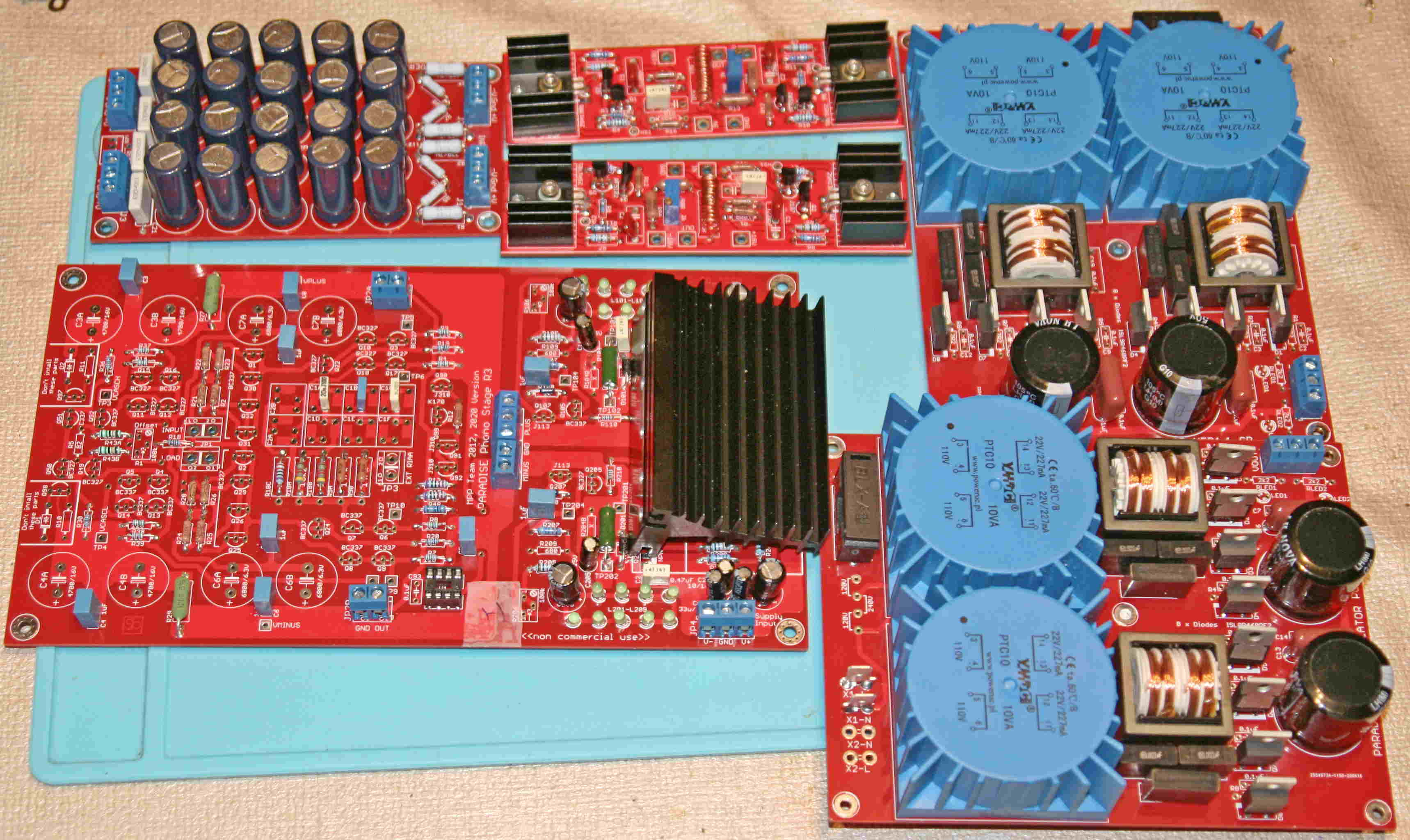

I bought some Paradise boards made by one of the guys from here but they don’t seem to have any of the compensation caps fitted .While regulator caps is not a problem as I can solder them underside I’m not certain about SMD in the amplifier stage , anyone built these new boards without SMD caps with no problem with oscillations?

It seems I am blind and have missed your post regarding SMD caps , I take you have tested boards with a 70MHz or higher scope ?Sebs boards doen't have them, you'd need to scrape the gnd plane off in many places to fit them, its not in any way practical to implement them. Ive built three on sebs boards, never had issues without them. Ime stick to below 450hfe and match super carefully and its not an issue.

Caps shown on underside of original boards. They can all be fitted by removing some solder mask.
Yes, I measured with a 100mhz scope.
