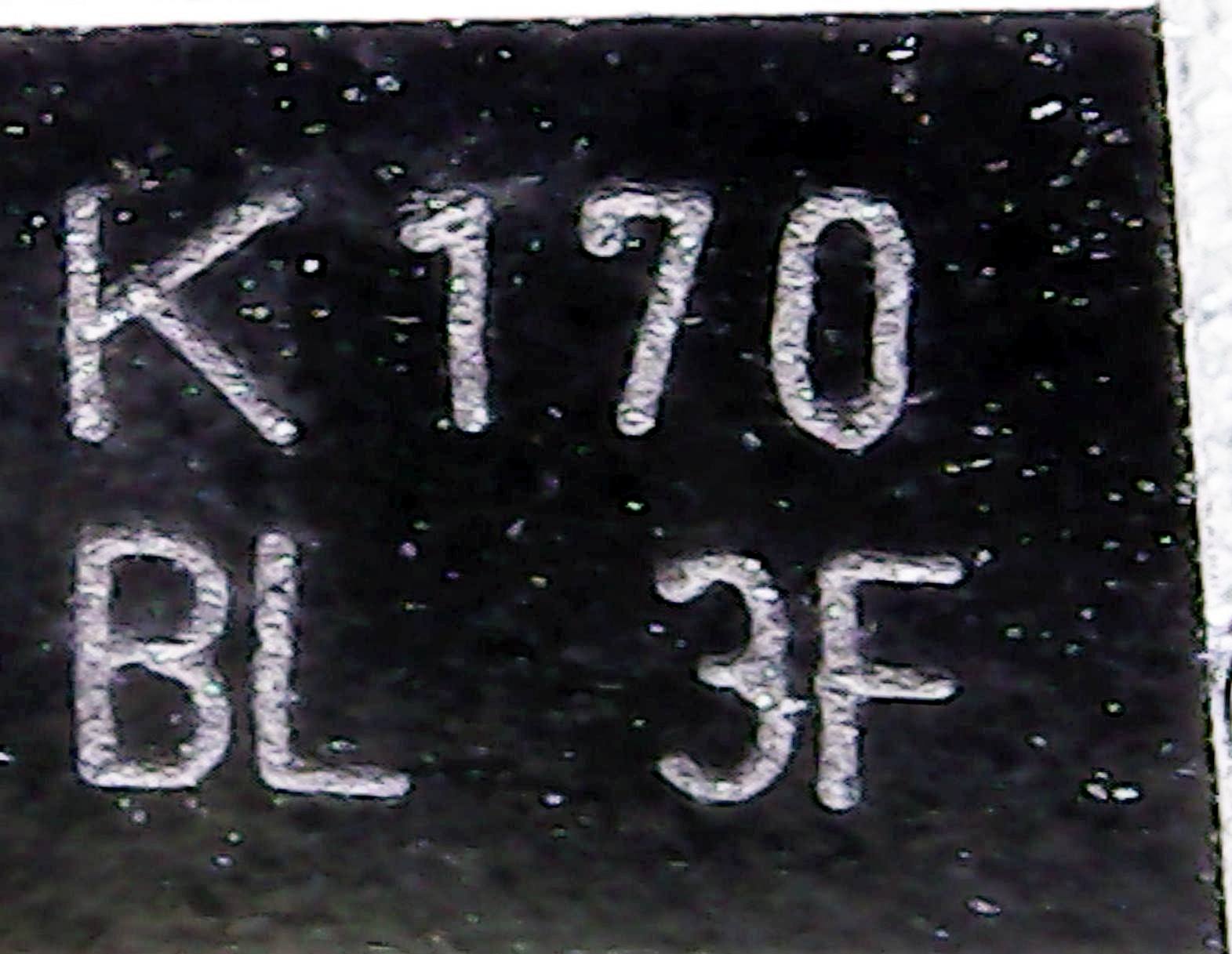

Is that of any importance? Excerpt from Store:
Note: The DCA Peak Atlas Pro semiconductor tester will give inaccurate results for testing these JFETs as it cannot provide adequate current during the test. Please refer to the user manual for more information on its specifications. This is a great tool but should not be used for testing high current / high voltage devices.
If Idss is high it only reports "Idss > 12 mA". I can confirm that. Tried to test J310. Not enough current do that. Other parameters are displayed.
It is also a "small signal" curve tracer when connected via USB. PC is then the display. Joachim showed some of those screenshots smoewhere in this (or MPP) thread.

Interestingly the 170's i bought earlier with a marking quite different from the Tosh one are shown to be N-Channel JFET's by the DCA75, but the Idss range was between 5 and 5.8mA. In order words - no fakes, but a bit out of spec.
