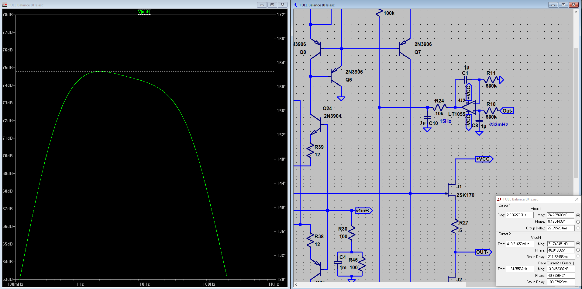

Did you remove half of capacitance and 1uF bypasses from all emitters - 4700uF &6800uF ?It was measuring 62dB on mine (Rev2 PCB). My RIAA values twist was Paradise Builders - Page 199 - diyAudio
I had also used half the total mF at the emitters and deleted their bypasses. For earlier subsonic roll-off.
The 6800uF doubles are the input stage emitter bypasses, there I deleted one per side. The 4700uF doubles are part of an RC filter with 120Ω resistors for each rail, they won't influence the infrasonic curve. You may keep them all four. And yes, I deleted those 1uF. To avoid possible resonances with the large capacitors supersonic impedance which may lead to some sharpness. Again if you like the result with those 1uF, keep them.
