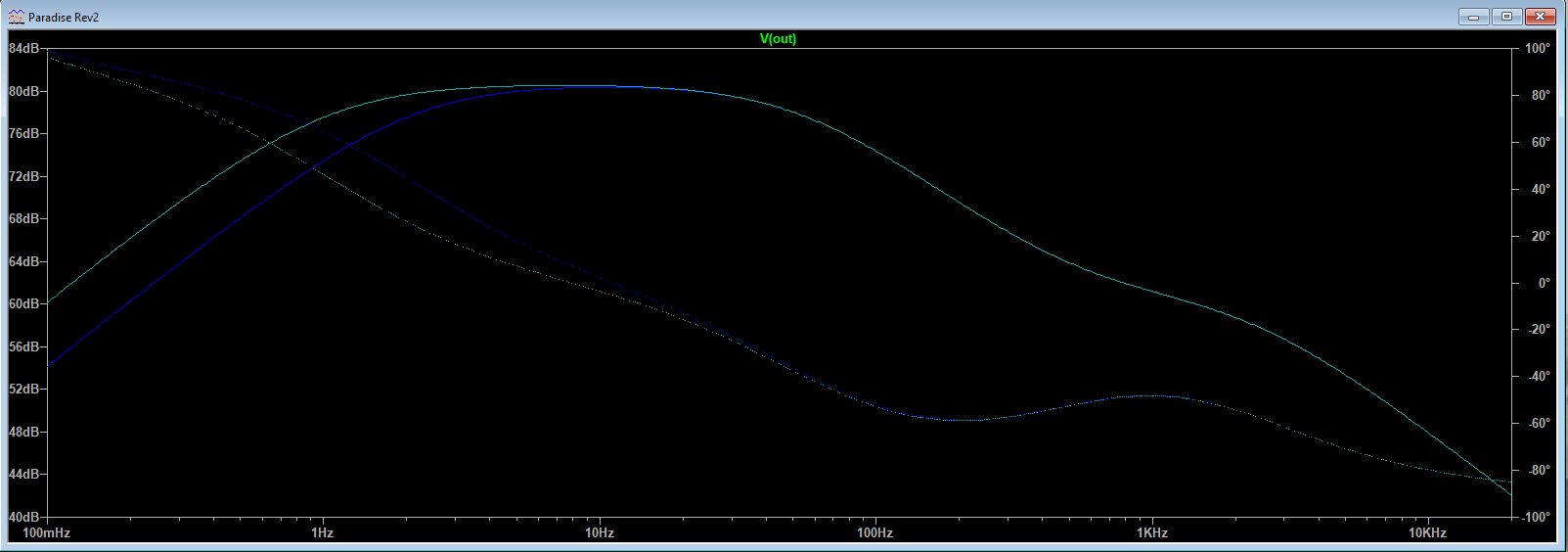

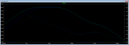

At what freq. does your Paradise cut off with these changes?I had also used half the total mF at the emitters and deleted their bypasses. For earlier subsonic roll-off.
Link takes me to the last page of the thread , I found your values in the manual: 12nF, 34.7nF, 9.1k, 67.8k , are these correct?It was measuring 62dB on mine (Rev2 PCB). My RIAA values twist was http://www.diyaudio.com/forums/analogue-source/218625-paradise-builders-199.html#post3438188
Looks like you're cutting bit of LF and HF , I listened last weekend to Paradise and it seems to over emphasise a bit HF in my system your values might be a way to go .
Link works on me, so here is my old post's text:
"Miib tuning has a bit more treble and bass. +0.4db HF +0.2dB LF in my build by measurement. Add 1nF to the treble caps C2a, C2b and parallel 820k-1Meg to R9a R9b. Matter of tolerances. You are looking for 67.8k net. That way it goes near neutral so you can have an alternative listening session. Its a matter of taste and system integration mainly."

LookAt what freq. does your Paradise cut off with these changes?

Until Jason will take the forum to a new platform there are various buggy things going on with browsers it seems. I have copied the original post's text four posts above anyway.
That makes for 33n3 12n 9k1 67k8
