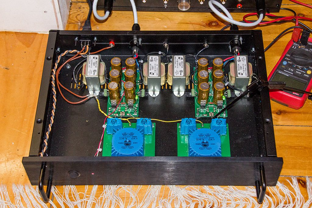

Hi Garf, this looks ok to me. The final proof will be if the system hums or not....
Are you sure the GND of the new arm is not connected to the metalwork of the TT? Also, it would be interesting to check if the downstream equipment (amp and anything connected) is eventually grounded, and you may see a "Earth" connection that way.
By the way, I think using one box for both Paradise channels might be better, probably because it is easier to avoid unwanted ground loop impedance, but I never tried - personal taste, I guess....
Let us know how it works 😀
I am trying the PSU with the Paradise connected to it,and the voltage I get out of it is 23,5-24 volt.I have 1,5v over the resistors,I guess the only choise I have is to short the resistors,If I dont wanna change the transformers (I have the 22v variant).
How much CCS current is your PSU's drawing? If you have alot of headroom current, then lowering the CCS-current will give you a bit more voltage - since the pre-regulator drops more at higher currents..
I actually even had to drop the 10R resistor to 5.9R to have enough voltage out of the pre-reg, even though i have 24v secondaries.. But that was very low voltage in the wall outlet.. 220v.. But now it works fine all the way between 220-240v, with no heating issues at 240v AC-voltage..
No I don´t have much current headroom,as I have the original current resistors
and I use the optional buffer.
I messaured the incomming voltage,and it is 240v AC.
Will shorting the resistors raise noise?Is the regulator/CCS sensitive for this?

Remove the 10r resistors on the psu smoother board, that will give you nearly 1.5v back which will put you at 25v+ into the psu, which is enough.
Also, which diodes are you using? They make a difference, using the LQA10T300 gives me half a volt more on each rail than using the LQA05TC600.
Also, do you only have one of the common mode coils wired fully wired to the other psu board? It looks like you have one wired with two wires and the other wired with only one. This means only one is giving you common mode rejection, the other is bypassed on the coil.

At 240v AC I have about 23,5v and the regulator is working,If I take it down to 220v ,with an adjustable trafo I have about 21,5-22v and the led string under the heatsink stops lighting,So sure it would be nice with 2 (ac) extra volts.

You are on the harmonised mains supply.
You country operates on the same voltages it used before Harmonisation was introduced.
You are on a nominal 220Vac supply +-tolerances.
Your minimum supply voltage should be 216Vac.
That is the voltage you should test for "no drop out" of your regulators.
If your regulators go into drop out, the glitches in the LV supply repeat at 100Hz and sound horrible.

That's where you have to design the system to work properly and safely over the range of mains supply voltage from 216Vac to 253Vac.
The same as the manufacturers have to do if they want to sell a product for use in the EU.
Ryssen : i have 2x24VAC r-core from selectronic, with those i had to to lower the 10R to 5.9R to have enough voltage at 220VAC mains. It is fine, but if i ordered today, then i would probably go for 2x25VAC rather, more headroom, and the possibility to increase CCS current a few mA extra.

How much Lv do you have at 240v?
With my calculations with a 2x25v trafo I will have about 27.76v at 241v ac in.
But then I have a 20 ohm resistor with one 18ohm in paralell,Iguess I could tweak the resistor a bit then.
With my test with the Lv bench PSU the CCS current went up a bit when I raised the voltage ,I think I used around 26-26-5v with the bech PSU
