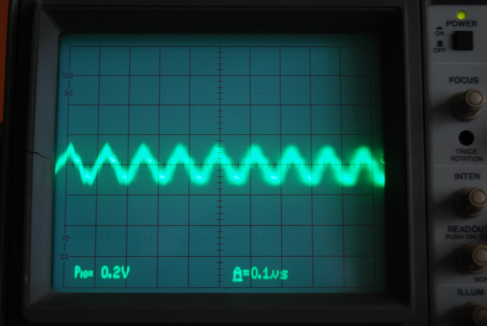

Here is a picture of the output with a 1k cart loading resistor at input. Approx 7-8mV @8MHz (ignore displayed vertical scale).
When the input is loaded with 47ohm oscillating frequency stays the same but amplitude triples.
So far i have not played with PS decoupling of the input stage or mirrors as presumably the layout works with the particular combination of parts some builders have already tried. Why it doesn't work with what i got from the group buy is indeed a mystery.

I am aware of the discussion - it seems to be based on the general discontent of one contributor, rather than any solid fact.
The problem most probably has to do with the particular batches of transistors, or maybe only the Hfe. Hopefully someone will come up with a solution. Shame about the pretty boards, at least those seem to withstand quite a lot of abuse...
Wasn't the initial version scrapped because of oscillations blamed on the output bipolar buffer and hence the fet update? Looks like it wasn't the buffer.
In R1 it was pretty much the entire board oscillating, I was trying to implement a fancty-pantsy-ground layout which basically didnt work. The R2 and R3 (which you have) now have:
1. one BIG ground plane with short connnections
2. SMD footprints on the bottom side of the PCB, right at the mirrors, for local decoupling
3. Much simpler (voltage follower) output stage, which is significantly less prone to oscillation than the R1 output stage
My experience seemed to indicate that high HFE will increase the tendency to oscillate. FWIW, I had transistors at around 400 for NPN and PNP, worked beautifully. My recommendation would be to put 400's in the input stage, and use the decoupling caps in both mirrors (100...1000nF X7R ceramic caps, size 1206 or 1210).
Keep posting if the problem goes away!
