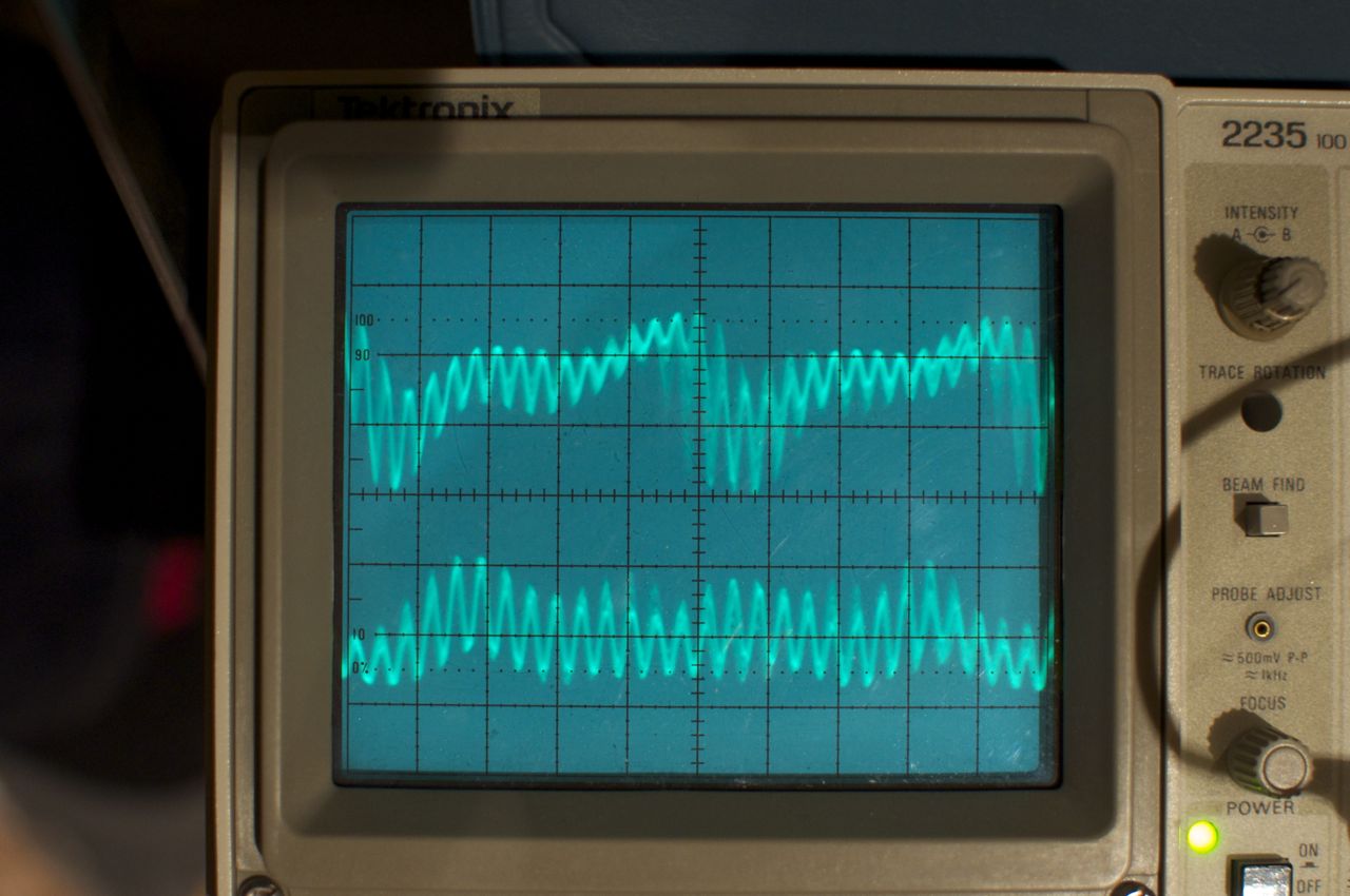

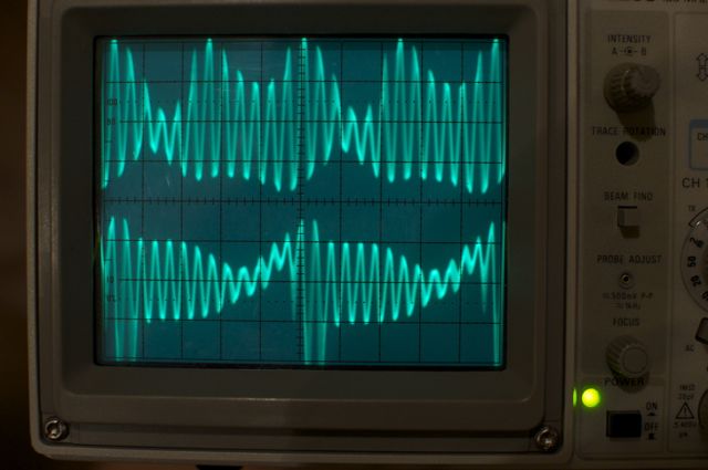

Right channel board, with low hFE ZTX450 and ZTX550. Back to 20 mV per division. Unfortunately this board keeps oscillating.
Right channel, after changing the two J310s for J113s, and their Rgs from 3.3K to 1.0K. Current through the resistors is 1.15 mA. Scope now set at 50 mV per division. The time scale is unchanged at 0.05 us.

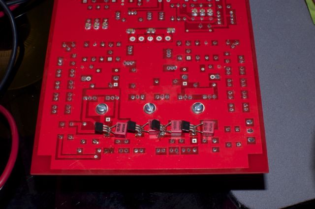

Pictures of the right channel board (top side), and left channel board (reverse side). The reverse of the right channel board is identical. Yes I was carefully with the pinout of the ZTX devices.
As you can see, I was able to replace Q102 etc without removing the heat sink. This is a nice design and I am keen on solving this problem.

Thank you for asking.Do you have the compensation caps mounted?
Yes, between the base and collector of Q102, Q104, Q202 and Q204. This is version R3 of the pcb so there is no dedicated footprint for them: I soldered them on the pins of the transistors on the bottom side of the board (a pain!). 3300pF on Q102 and Q202 (the middle two transistors in the right-hand picture of the previous post) and 680pF on Q104 and Q204.

The problem in the right channel board is a tough nut to crack… I've tried increasing the b-c compensation caps in the CCS up to 12 nF, then tried the same in the CVS, but it did not help much...
What I am thinking next is playing in the shunt, starting with Q105. Since changing Q107 worsened things, perhaps the BC337-40 in Q105 is "too nervous". (I'm guessing here). Will try a ZTX450, and if need be, a small cap between base and collector.

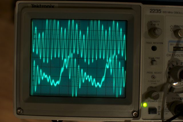

Hi Pierre, changing Q105 and Q205 should not make much of a difference. Are the collector voltages of Q105 ad Q205 at around +/-15V alright?
Can you please remove C104 and C204 just for a moment, to see if it makes any difference?

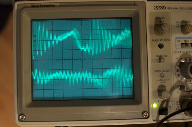

For the left board, which is on the bench, the collector voltage of Q105 is 15.07V and that of Q205 is -13.66V. For the right board, they are 14.35V and -13.68V.
Here's a photo before removing C104 and C204. 50mV and 0.5us per div, with BW limit (20MHZ).
Sorry for the delay, I have been away a bit 🙂. The correct JFet to use is the J113 and the current set should be (about) 1mA. This should result in a Vds of about 1.5 Vols.

Most of the boards that I did have, and that oscillated, needed replacement of the power transistors. What power transistors are you using (D44H11/D45H11?). Some of the links that I just posted do discuses the power transistors.

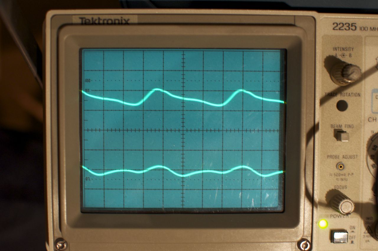

Now after removal of C104 and C204. 20mV and 0.05us per div. Looking better!
