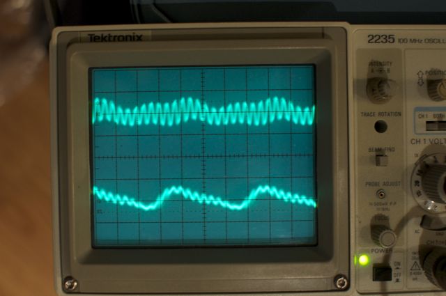

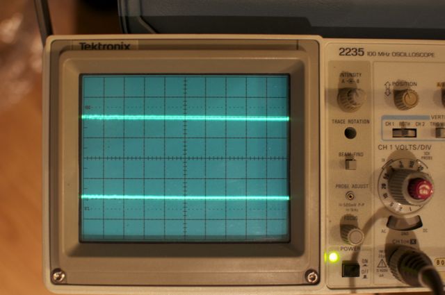

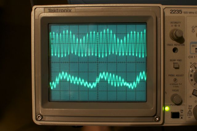

Help with PS please
Hi all
I have assembled two R3 boards and cannot get rid of oscillations in the power supply. The LEDs turn on, the voltage at the output is close to +18V and -18V. The current through the 3.3K resistor next to the J310 is about .75 mA. The positive and negative rails of both boards oscillate at a few MHz plus ringing in the tens of MHz.
Q102 and Q104 are high hFE BC337-40 from ON SEMI. Q202 and Q204 are high hFE BC327-40 from Fairchild. I have tried adding the film caps as is now recommended. This reduced the amplitude of the oscillations, but did not eliminate them. I added small resistors to the last filtering electrolytics (to lower ESR) without results.
The most significant progress resulted from trying for Q102, Q104, Q202 and Q204 lower hFE NPNs and PNPs: the ZTX450 and ZTX550. Pictures to follow in separate posts.
Pierre

The bottom trace shows the positive rail, and the top trace the negative rail, after powering up the "left channel" board.
