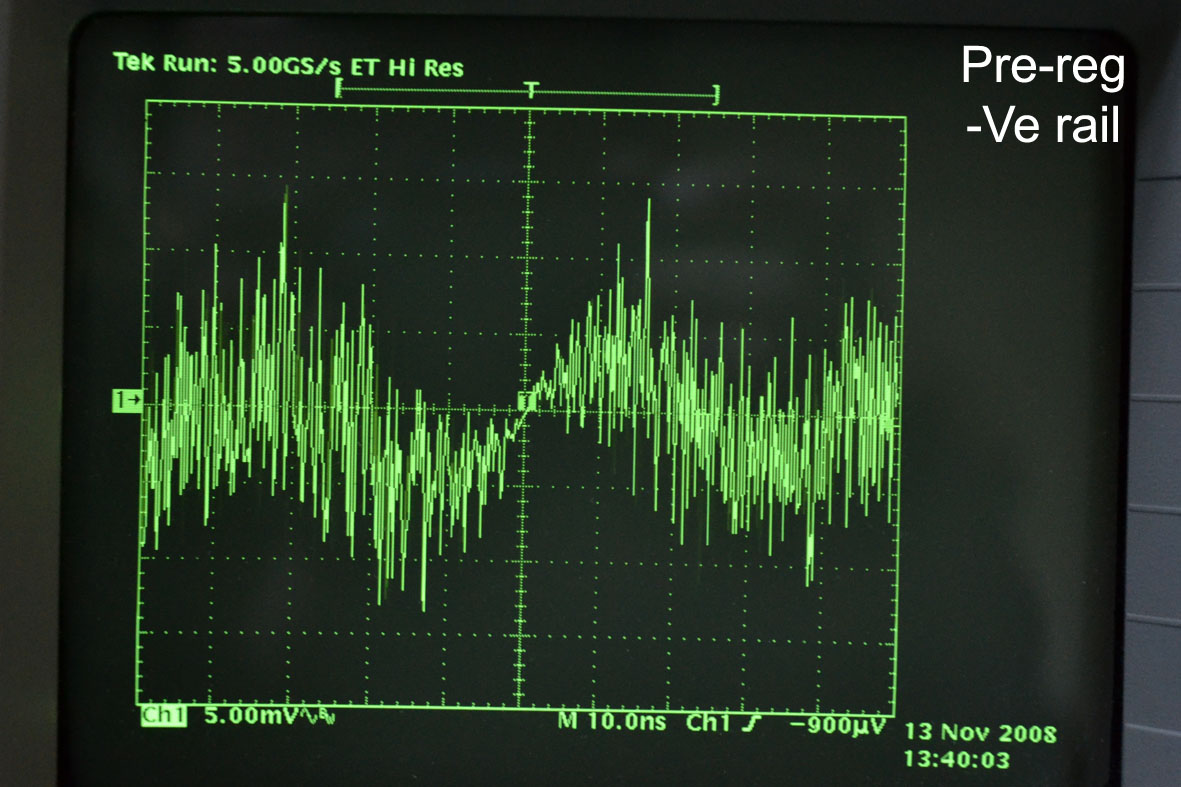

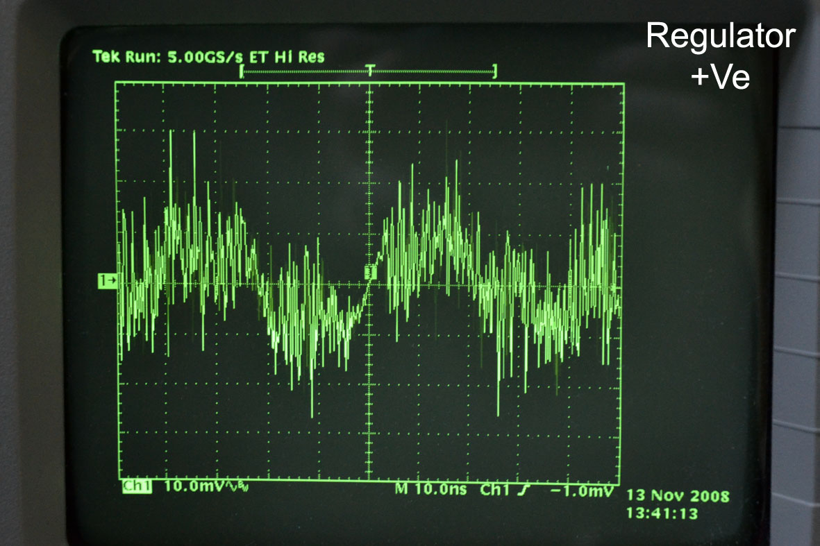

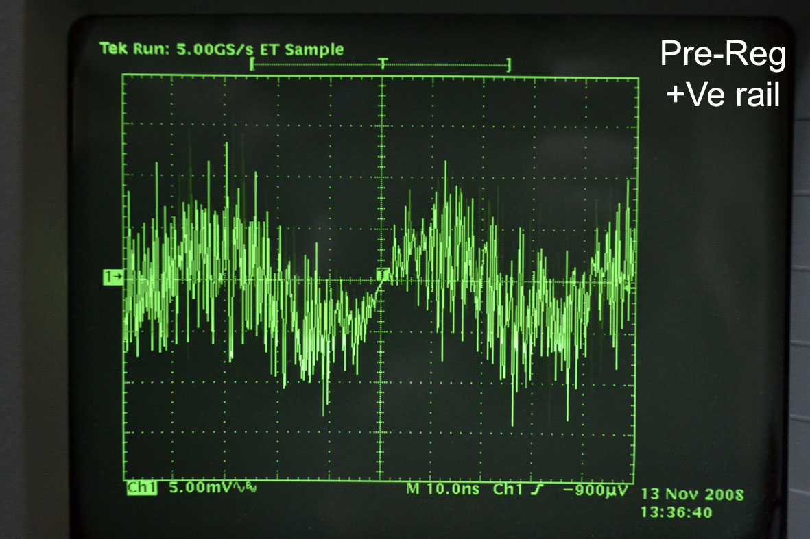

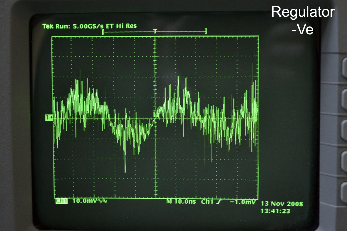

Finally got around to putting my Paradise boards (boards and parts from the original GB plus BC327/BC337 that I sourced for matching) together and I have a few issues. I'm using the 'official' pre-regulator boards to power and these were built up first. These produce around +/-43.8V with no load which seems about right. I hadn't measured the rails for noise until now but we'll come back to that later...
I built up the Paradise boards using bi-polars that matched to 1% or better across the board (all measured at hFE 492 +/-2). The input trannies were the very best matches although I don't think the accuracy of my meter (Peak DCA55) is better than about 2%. On power up of just the regulator sections it all looked good, all LEDs shining and, after trimming, a nice stable +/-18.2V on both boards. A good start.
I inserted the bridges to power the amplifier and did a little initial trimming of the input offsets then left to run for a few days to let any necessary cap forming happen. I then added a 47R resistor across the input and re-trimmed for 0mV, both channels seem very stable in this respect. I then checked the output for DC and found an offset wandering from roughly +100mV to -100mV but I also found about 14V of AC voltage! At that point I had no RIAA caps so added these and the AC on the output (as far as my Fluke 179 reads) was gone. Clearly though that level of AC on the output was not right so I got the scope out and found that both channel had an output of around 150mV RMS at about 73 to 77MHz. For good measure there's also some much higher frequency components in the output, up in the low GHz region albeit at a lower level.
I decided to focus on one channel to start with and did the following. Checked the power rails after the regulator, these looked very noisy with around 50mV of crap in the high MHz region. I added the compensating caps to the regulator section and this improved matters a little but the noise remains. I measured the voltages around the board and they're all very close to what they should be. The only 'imbalance' being +.6V -.54V either side of the 82R resistor, R5. Where I do have an 'issue' is the output from the servo as this floats from around +5V to +8V which seems high although not entirely out of spec.
I put the scope on the output from the pre-regulator and, perhaps unsurprisingly, there's noise present. Now I'm not saying I expected to see perfect DC but surely there shouldn't be much noise after the pre-regulator has done its job. There’s an even higher level of noise on the power rails coming out of the regulator, ground is also similarly noisy when measured at the regulator-amplifier bridge.
The "wandering" of +/-100mV is quite normal and due to the thermal variations of the input stage. Others have reported that when they put a shield or heatsink there this stuff is gone. The high frequency stuff you are seeing is the amplifier oscillating, not the power supply (that would be a couple MHz).

The servo output variation is due to whats described above, not unusual. Check the assembly guide, there is some information on the compensation caps for the amplifier as well. BTW, did you put the SMD caps on the bottom side of the PCB?
If that fixes it, this will be the second confirmed case of Paradise amplifiers oscillating, not too bad I think.....

I'm not too worried about this, as you say it's quite normal and the boards are in free air currently. Yes, I have fitted the SMD caps.
Well, I suppose that depends on your perspective 😉 After all the transistor matching and careful stuffing it's pretty depressing from where I'm sitting. I'm going to take a break from it for now, I'll have a hunt for some suitable compensation caps and try that later in the week.

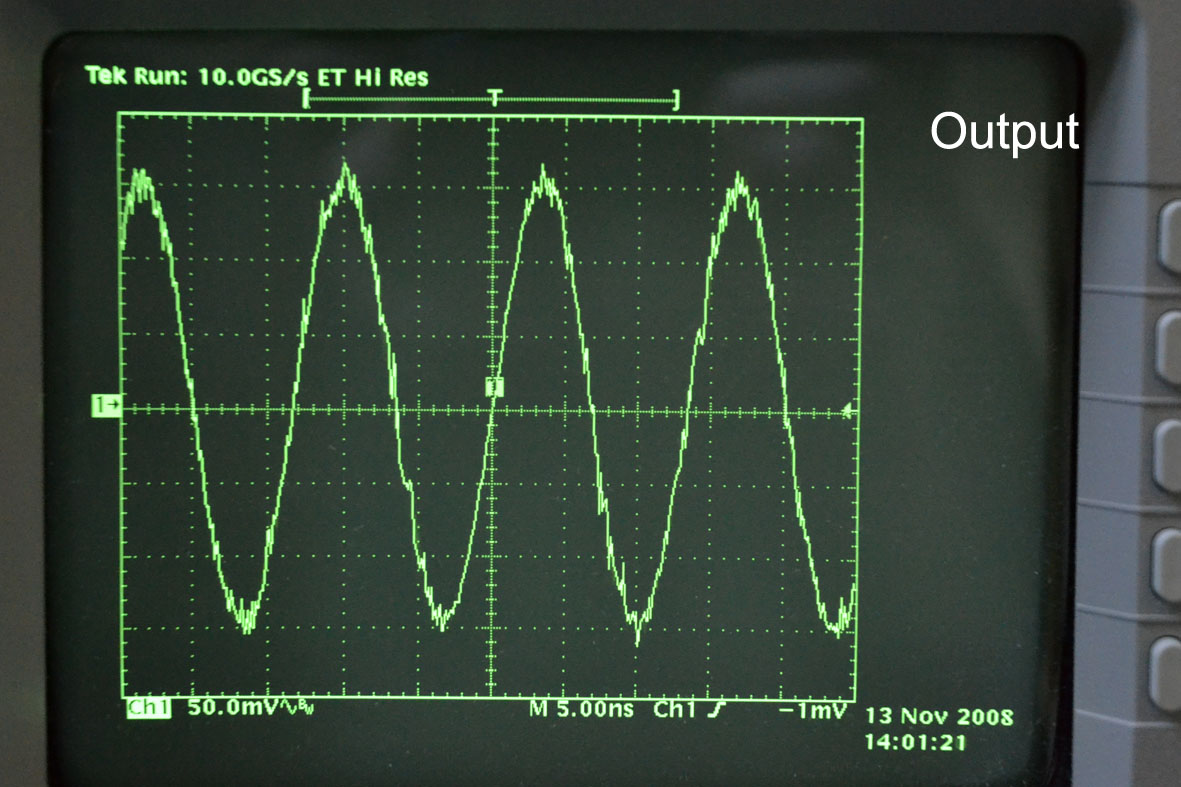

Managed to find time to bung a couple of cheapo 33pF ceramics on the board and decided to skip the 'scope and just go straight to listening to the output. Yes, I'm impatient! With a old (missing half its cantilever) Linn Arkiv connected to the input we've definitely got a working amplifier. There's a little hum (not surprising as it's not cased or properly grounded) but very little noise. Will put the 'scope on it tonight and see if the oscillation is gone, fingers crossed! I've also got to replace the J109s and resistors in the PSU but will do that once it's stable.

After re-reading the last few posts I see that it is the amplifier oscillating (not the PSU) so, it is not needed to swap the PSU BC's (sorry for the confusion).
No apology necessary, I think it's my fault for confusing the issue by posting the 'scope traces from the PSU rails which was just noise and not oscillation. Anyway I'm relieved that I can leave that heat sink where it is🙂.
Hopefully in a couple of days I'll get round to sorting out the case for the Paradise boards to nestle in and see how they sound once they're properly shielded and grounded.
Thats good news Paulski, so this did fix the amplifier oscillating - glad its working now! BTW, how do you like the sound?
