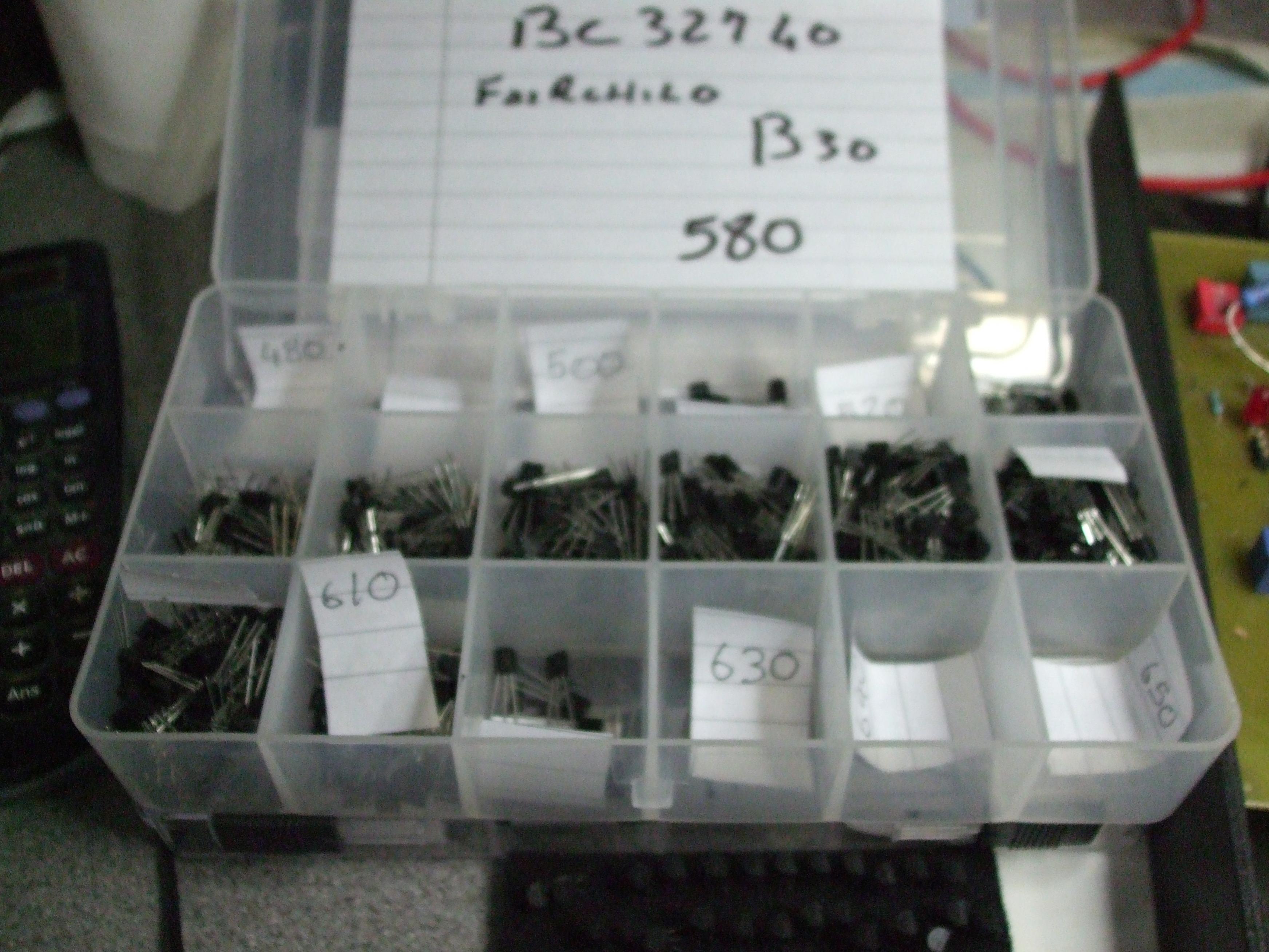

In the mean time I have started to re measure my transistor batches
I have a few hundreds BC327-40 from Fairchild direct whit Hfe above 560 and up to 600 (al measurement taken with hesener circuit at 5.00V)
Any one interested in swap with similar Hfe BC337-40
Simon let me know if you want them I can send you enough PNP (matched Hfe around 600) for the Input stage

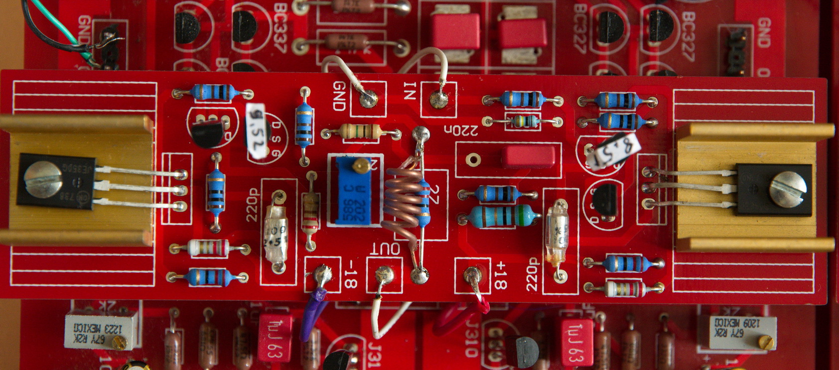

Hi there,
sitting here with allmost stuffed Calvins...
Only those J107/PF5102 are left to be stuffed.
Fisrst idea was to compare circuit schema with
the boards. This makes me mad because some
of the values mentionend in the schema appear
to be different on the actual boards.
Therefore i got that nervous to be not able to
pinpoint where to drop them.
Help me please.
Hi Peter
Trying to help you with this photo.
javascript:;
When you zoom in you see 2 trannies with twisted Pins.
There I have fitted befor 2sk170 and that is the place for
the PF 5102. Now I have PF5102 sitting there as well😀
Take it easy
Werner
Once again
I hope you can see it here better.
Right-hand side is't the right one. Left-hand side is't the one behind.
http://javascript<b></b>:;
Omittance of R15 is in fact not an option here but a must, as it´d be parallel with R9a,b which is part of the RIAA-equalizer network.
As R9a,b are 73k5, R15=100k would modify the amplitude response considerably, as the combined value of R9a,b and R15 woukld be 42k36.
The reasons for R15 are twofold. One is to define the input impedance and the second is to supply for a bias current path for the input JFET.
R15 may only be omitted within circuits, where a bias path -like R9a,b in the Paradise- exists. It´s value may be chosen anywhere below 1Meg.
jauu
Calvin
