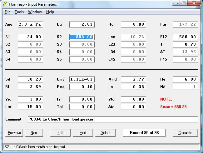

No problem. Keep in mind the throat opening is for a PC83-8 which has Sd=30cm^2. Yours is probably different. I plot the hornresp csv export with numbered axis (cm) to check the dimensions after printing.

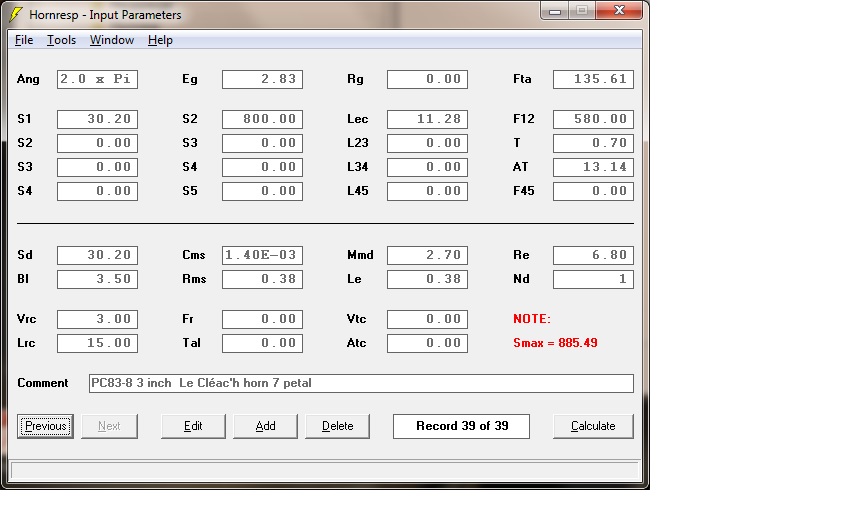

I guess you had a good reason not to construct the Le Cléac'h horn with a full 180 degree roll-back at the mouth?
(To do so would simply have required S2 to be set to the given Smax value of 885.49).

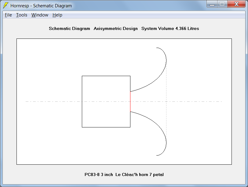

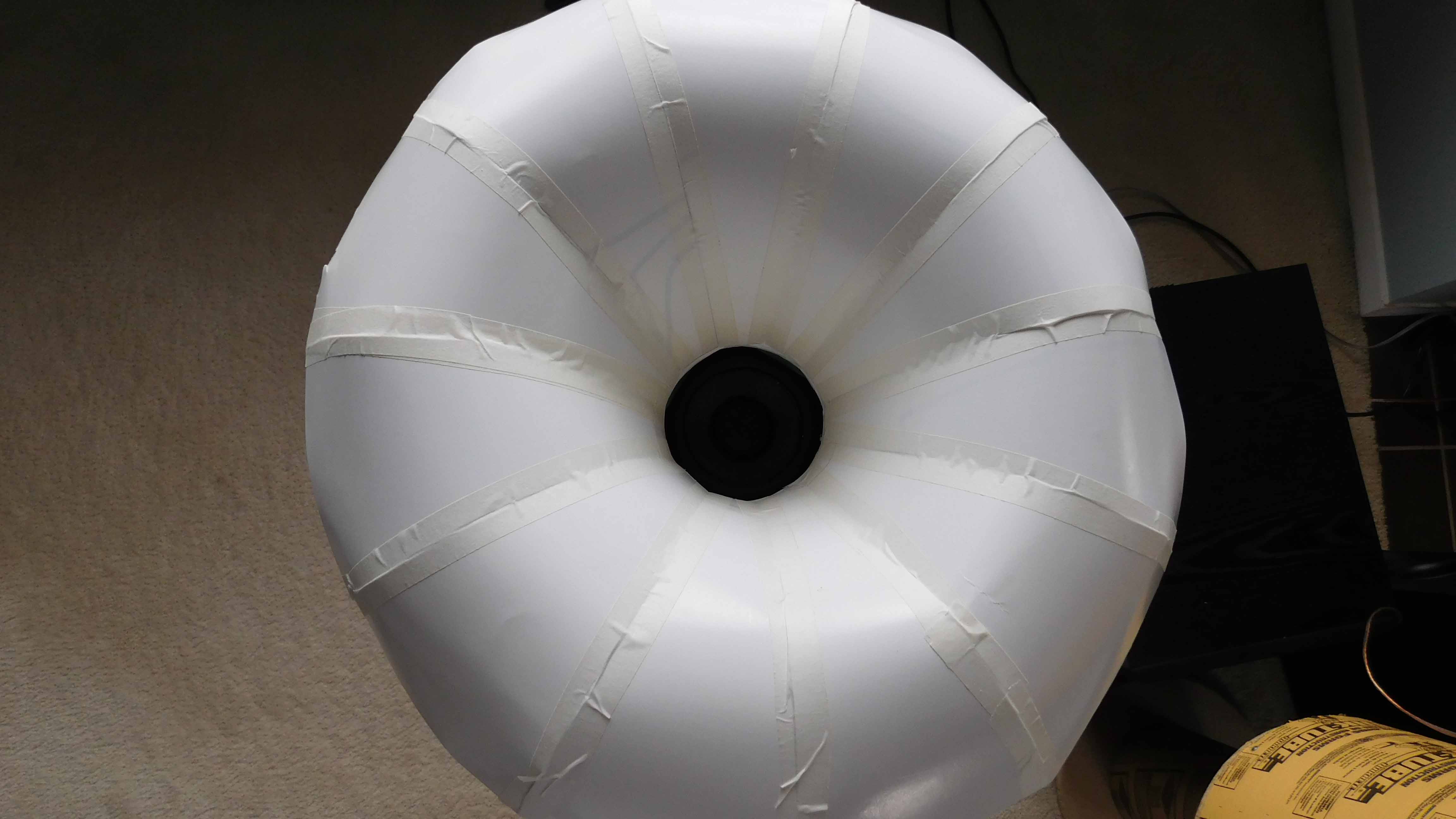

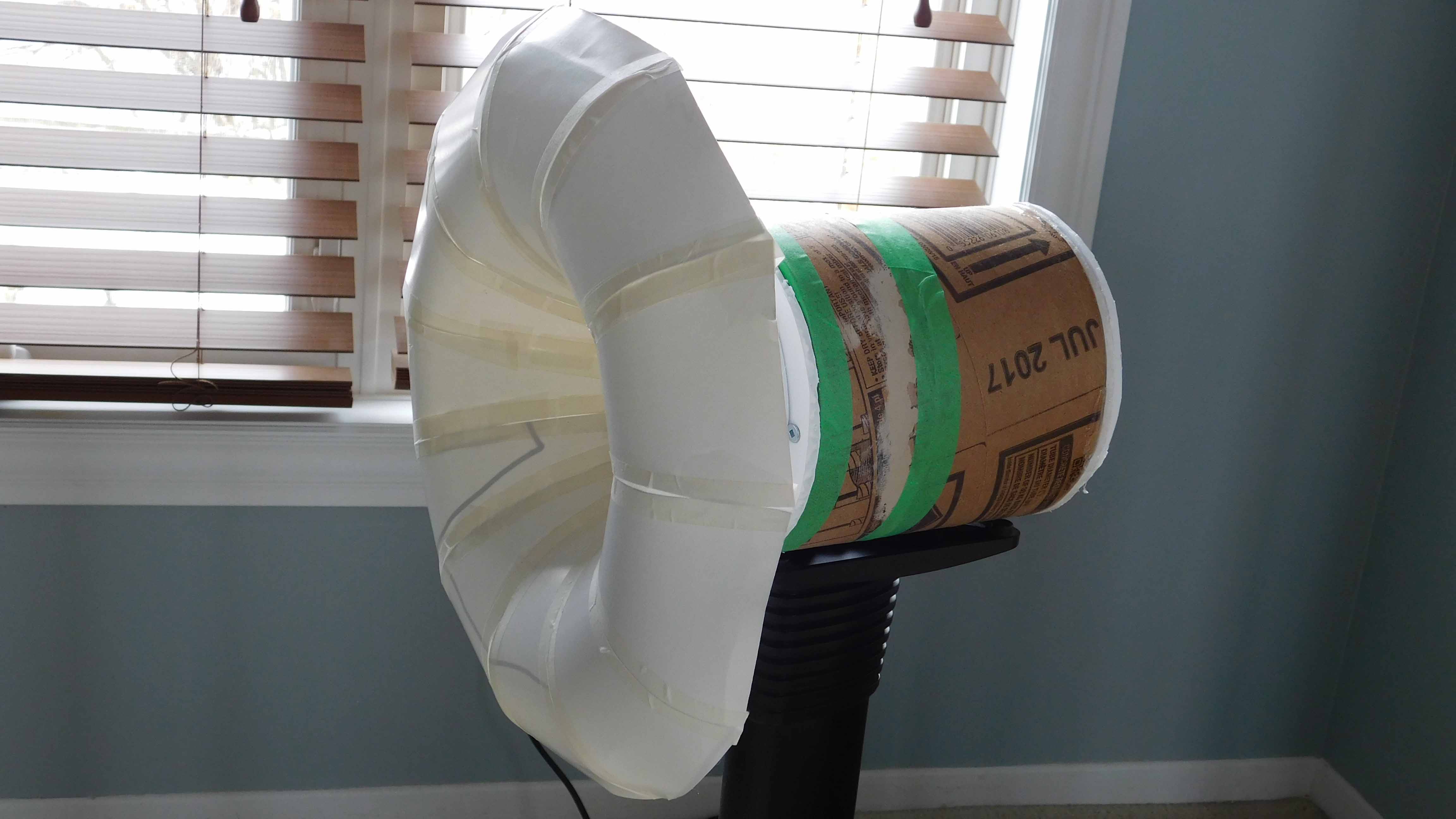

The first 7-petal design was a trial run. I was resurrecting an old inkjet printer and trying to fit a petal 1:1 on a single A sheet (8.5x11).
I retried another horn using an 11-petal design and increased the mouth area to get a fuller roll over as you suggested. I also increased the throat a little more to better match the driver. The rollover assembly is more difficult from bending and accumulated assembly error 🙂 (more pieces). It's an improvement, the measurements are at Dayton PC83-8 (3") test results with the rest of the PC83-8 collection.

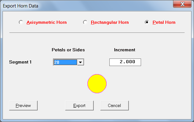

I chose 20 petals as the limit because by then the horn cross-section is effectively circular (see attachment). Also, with more than about 11 petals assembly could become quite difficult. There is no practical reason though, why the limit could not be lifted higher if so required.
