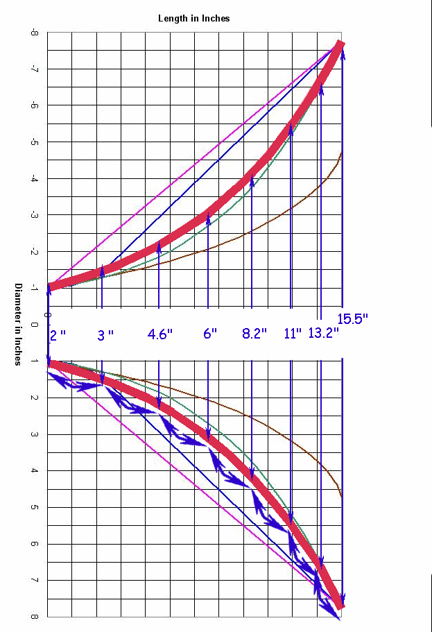

No problem. Keep in mind the throat opening is for a PC83-8 which has Sd=30cm^2. Yours is probably different. I plot the hornresp csv export with numbered axis (cm) to check the dimensions after printing.

Hi DonVK,
Many thanks for posting the pictures, it is reassuring to see that the Hornresp calculations appear to give the correct profile. I have never actually built a petal horn myself to check 🙂.
I guess you had a good reason not to construct the Le Cléac'h horn with a full 180 degree roll-back at the mouth?
(To do so would simply have required S2 to be set to the given Smax value of 885.49).
It would be interesting to know if it is any more difficult folding and fitting the petals making up a fully-formed 180 degree horn.
