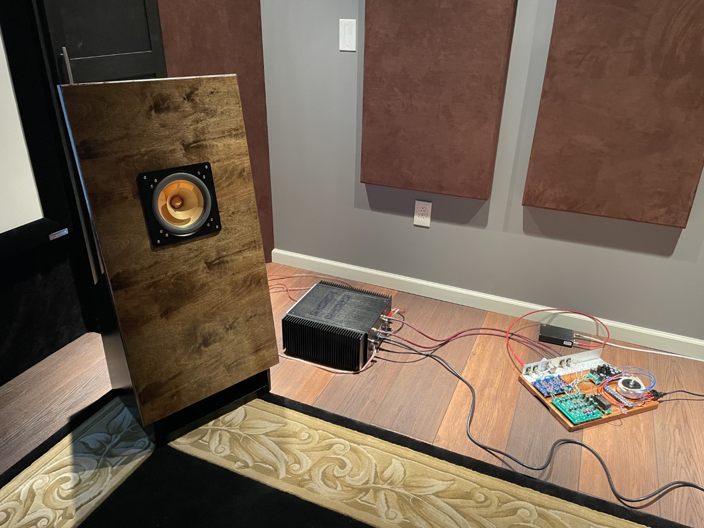

Some progress made on the prototype, it makes music. No measurements yet, using the values from Papa's Cube full range schematic. Spent as much time trying to work on techniques for finishing the wood, baffle turned out decent, frame for 15" needs some work.
Looks really good! And the electronics prepared on the cutting board are... appetizing 😀
"It makes music" 😀 okay, but how does it sound?
Sounds great, but early days for sure. I only fiddled with basic tones (40-80 hz on low end and 1khz on high) and an iphone app to set the levels. Used what I had on hand for plywood and didn't know how it would turn out, so I only built one channel for now. Planning on measuring/tweaking this before finalizing the second channel of the cross over.
Cutting board is Waynes BA2018 (supplied by VRDN) and ACN supplied by little 24V SMPS (yes, slowdiyer's design). Had a muses volume control on there, but keeps giving me trouble, so it was replaced with a PEC pot.

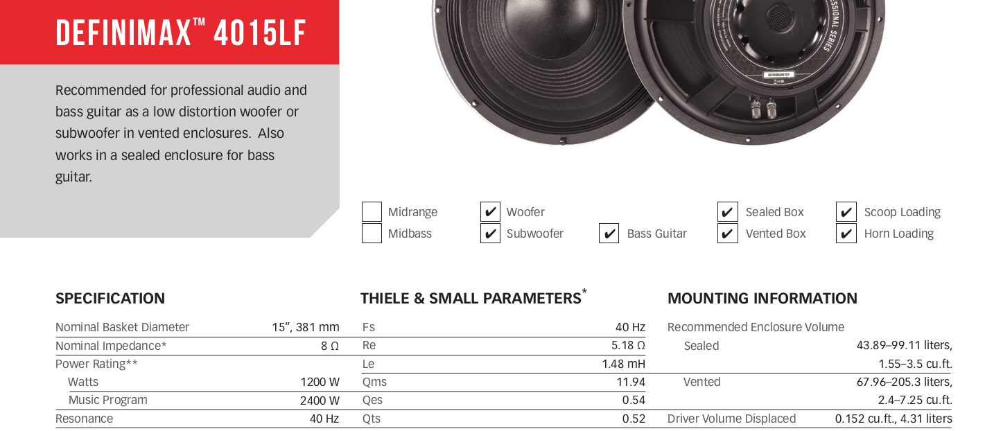

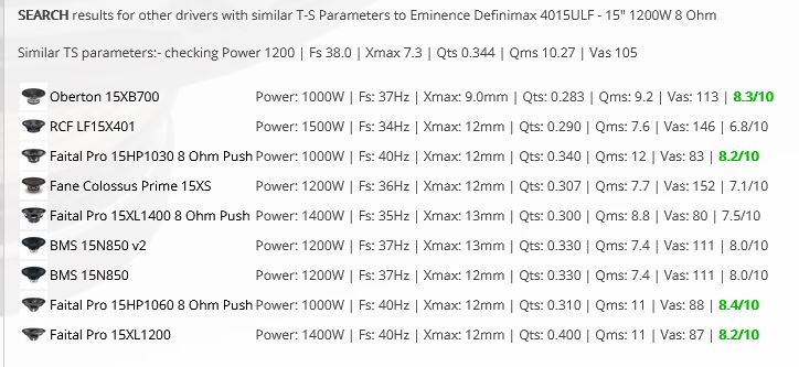

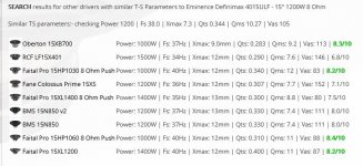

As the Eminence Definimax bass units originally recommended for this are now discontinued and I've been unable to locate stock in the UK I've been looking for an alternative.
Based on the TS Parameters these look to be a close match - just wondering if anyone has any thoughts/experiences?

nope Qts is only 0,23 vs 0,52....As the Eminence Definimax bass units originally recommended for this are now discontinued and I've been unable to locate stock in the UK I've been looking for an alternative.

Same @ Faital: QTS is no more than 0,37 on 15" but Xmax >9mm is promising with bass EQ and a good power reserve

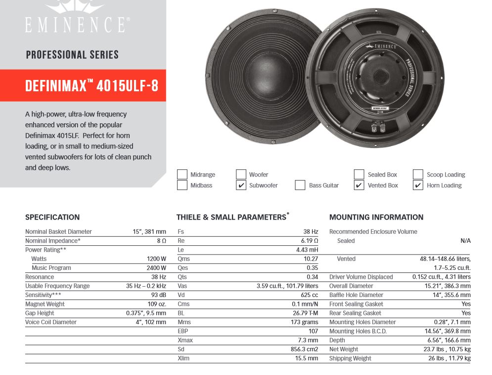

Except that the Definimax has a QTS of 0.344 and the Oberton is 0.283
Definimax lt are 0.52

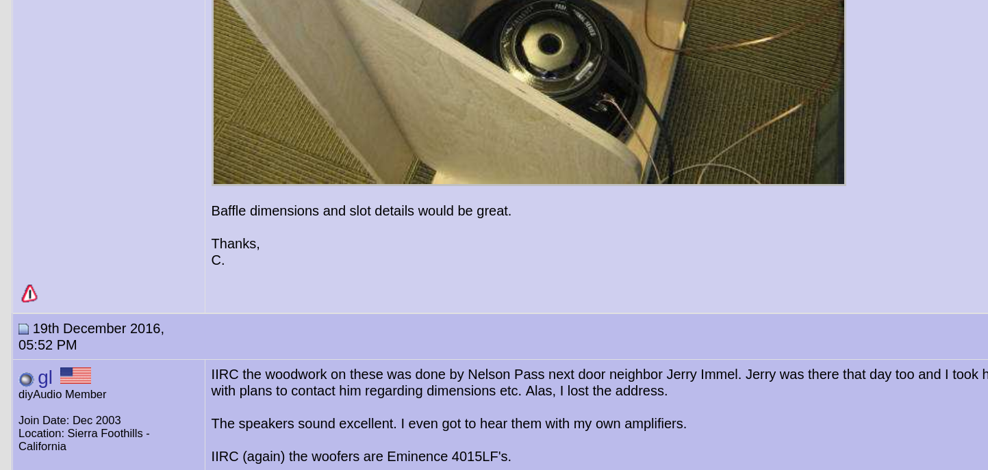

Wrong drive unit, the recommended bass unit is the Eminence Definimax 4015ULF, you're referencing the 4015LF.
you are wrong 😛you know well that are the LF ,forgot... ??Wrong drive unit, the recommended bass unit is the Eminence Definimax 4015ULF, you're referencing the 4015LF.
btw just look:
- Papa’s slot loaded open baffle version #2
