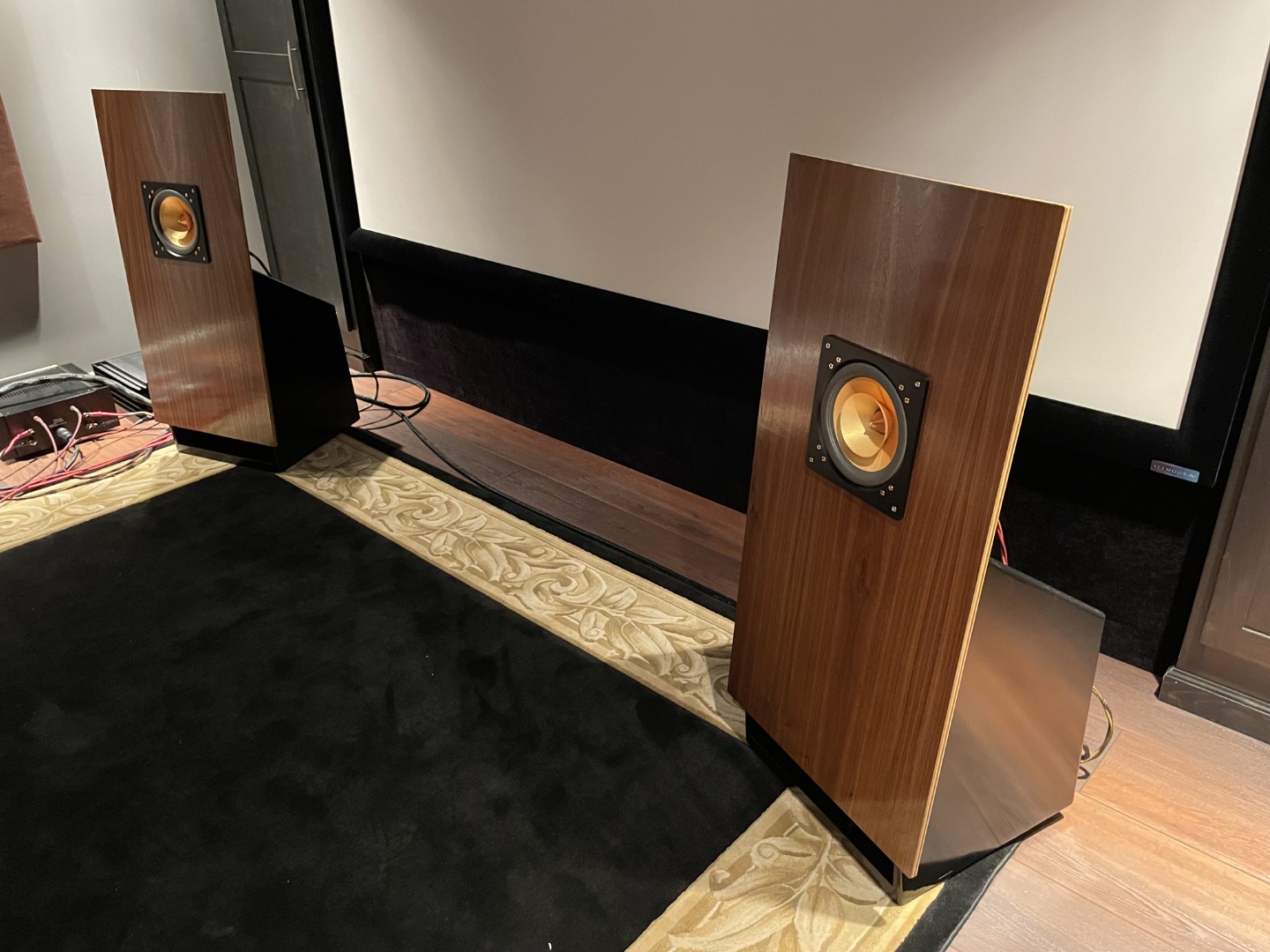

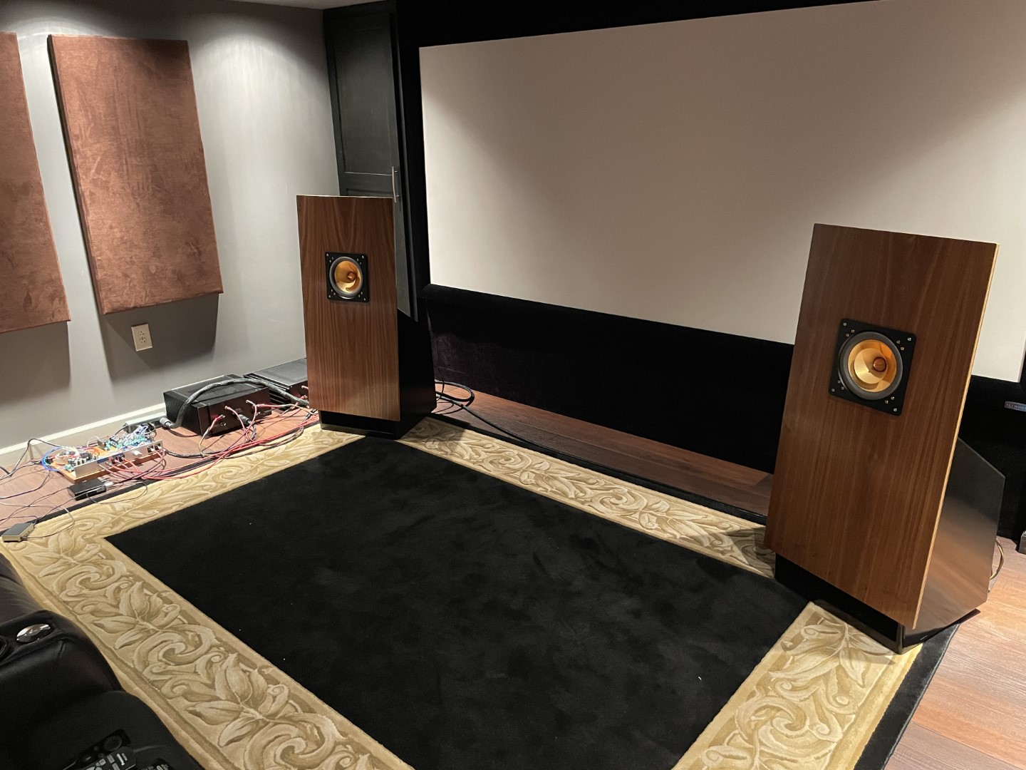

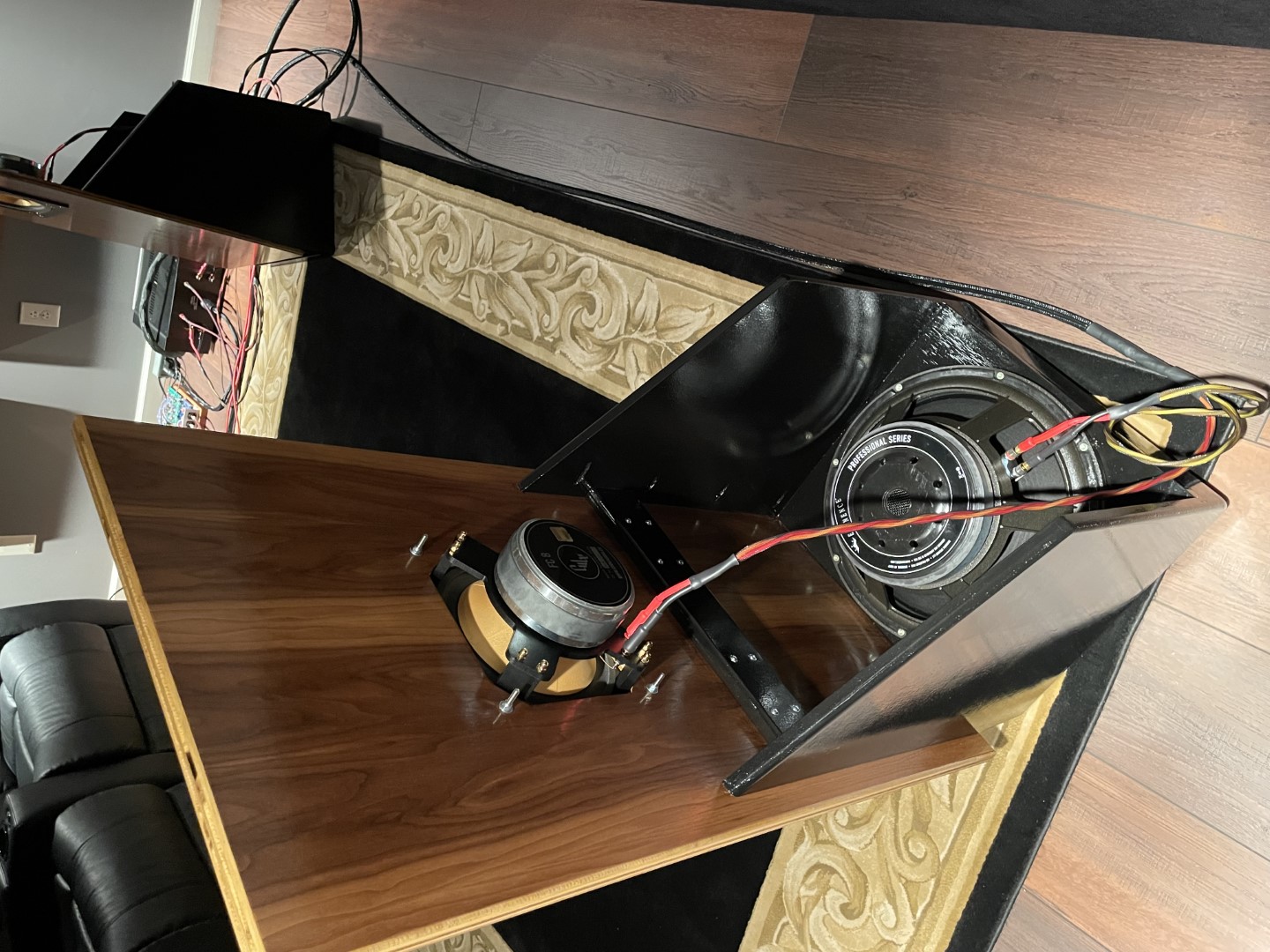

Final baffles made, they turned out nice and the construction of the second base went smoothly, but I am a poor paint finisher, fortunately the room is dimly lit!
Still not measured anything yet besides simple check on iphone to set levels, but using the baseline Cube crossover value from Nelson, it sounds wonderful. I spent ~15 yrs with various versions of Zu speakers, so it is a general sound signature I am familiar with, but in this room (theater with front wall treated/relatively dead behind the acoustically transparent screen) the bottom end is excellent.
Working on an F7-ish amp for the bottom end and need to bring down SissySIT from upstairs to give a listen!
Thanks to all, a fun project and something to keep tinkering with.
