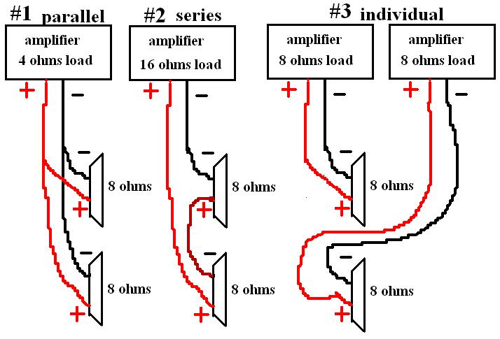

Yes you could do that, but those drivers are not 4 ohms drivers.
You would need to go with different drivers if you want to use two amplifiers to their full potential.
What ohm drivers are they then? 2? 8? 16? sigh.
I have been wrecking my brain trying to suss out this parallel stuff and what not and I still don't understand. If I wanted to power these drivers individually with an individual amplifier for each, what ohm mono load will I need to feed them?
Thanks, grrr this is getting annoying.
NOTE: If you could PLEASE try and explain what feeding them in "parallel" means, that would be great. In terms of actually plugging in a lead into the drivers and how it is configurated, that would be awesome.
Each driver alone is a 8 ohms driver.
When you put two 8 ohms drivers in parallel, you get a 4 ohms load.
You could also put two 8 ohms drivers in series, you get a 16 ohms load.
These amplifiers deliver the maximum output in a 4 ohms load. What to do? Use two 8 ohms drivers in parallel.
You could also use different drivers, some drivers are 4 ohms instead of 8 ohms.
Here's an example, I hope you'll understand better.
