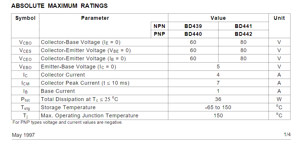

Where did you say you GOT these BD441/2? I might want to try them and see if they really DO hold up on +/-50 volt rails driving a 8 ohm speaker directly. In my experience, no little 4 amp 40 watt device has survived the attempt**. Either someone is lying, or you could repackage them and sell them as 2SC5200’s. With better luck than the usual fakes with 2N3055 dies inside covered in white goop.
**ST:TOS, “The Corbomite Maneuver”, which may actually be applicable here.
Reactions: cumbb
If voltage were the only concern I bet it would. Try connecting one to a 100 VDC supply collector-emitter, with base open. With a 100k resistor in series. Measure the current. I bet good money it’s negligible.
But turn up the volume enough and watch for fireworks. Half way up the rail you hit maximum instantaneous dissipation into a resistive load. This is the best possible case. 25 squared divided by 8 ohms is 78 watts. A 40 watt device will only take so many excursions of this before it tells you to eff off.

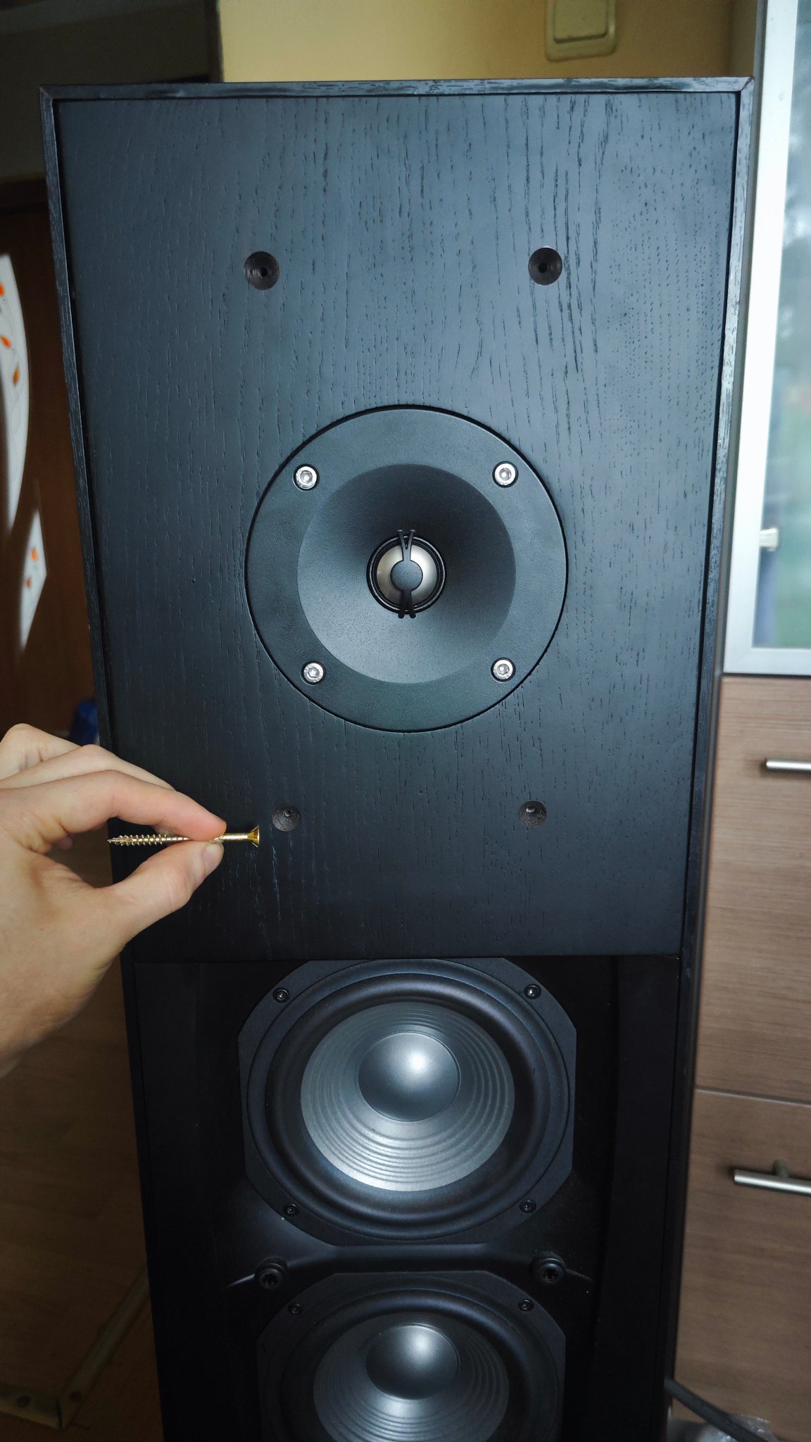

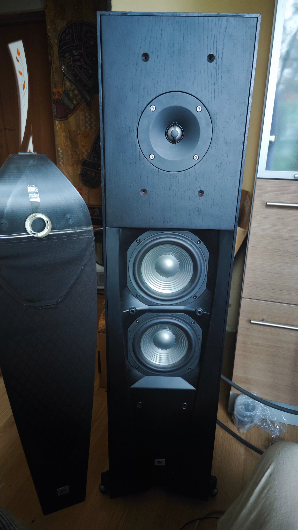

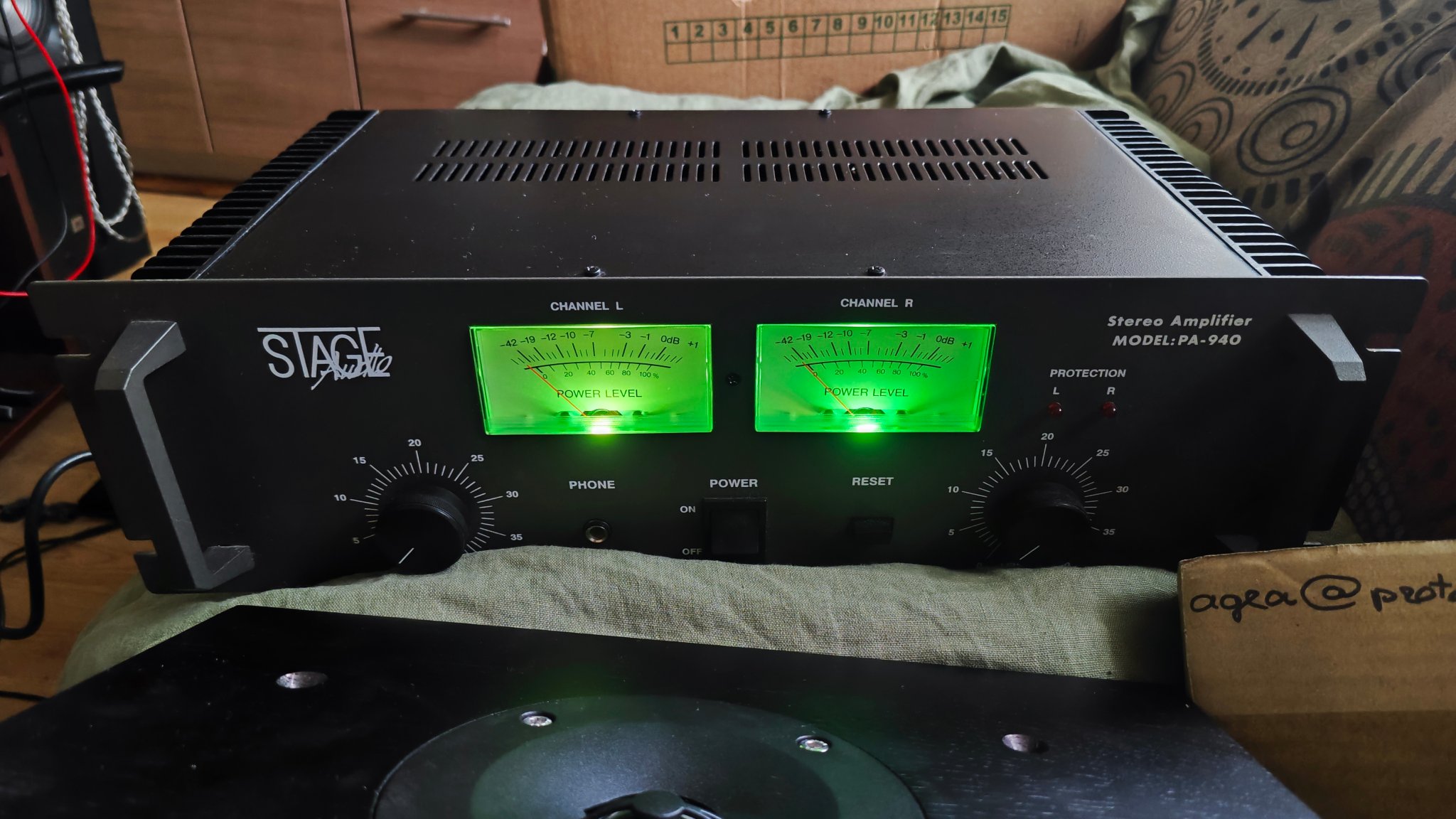

So, this thing of beauty is in my hands!
And finally my speakers are finally looking presentable enough to post on the forum even as not fully finished yet. The grills will be cut to fit and the screws will be painted black.
They sound amazing

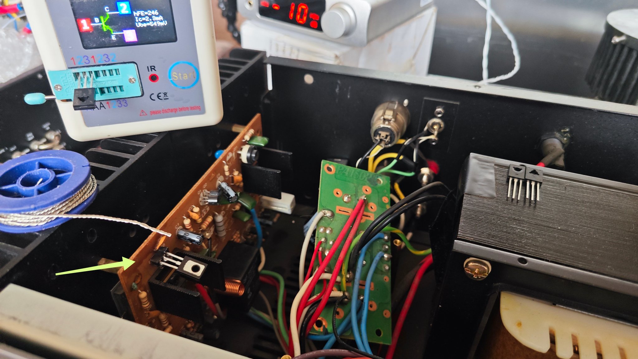

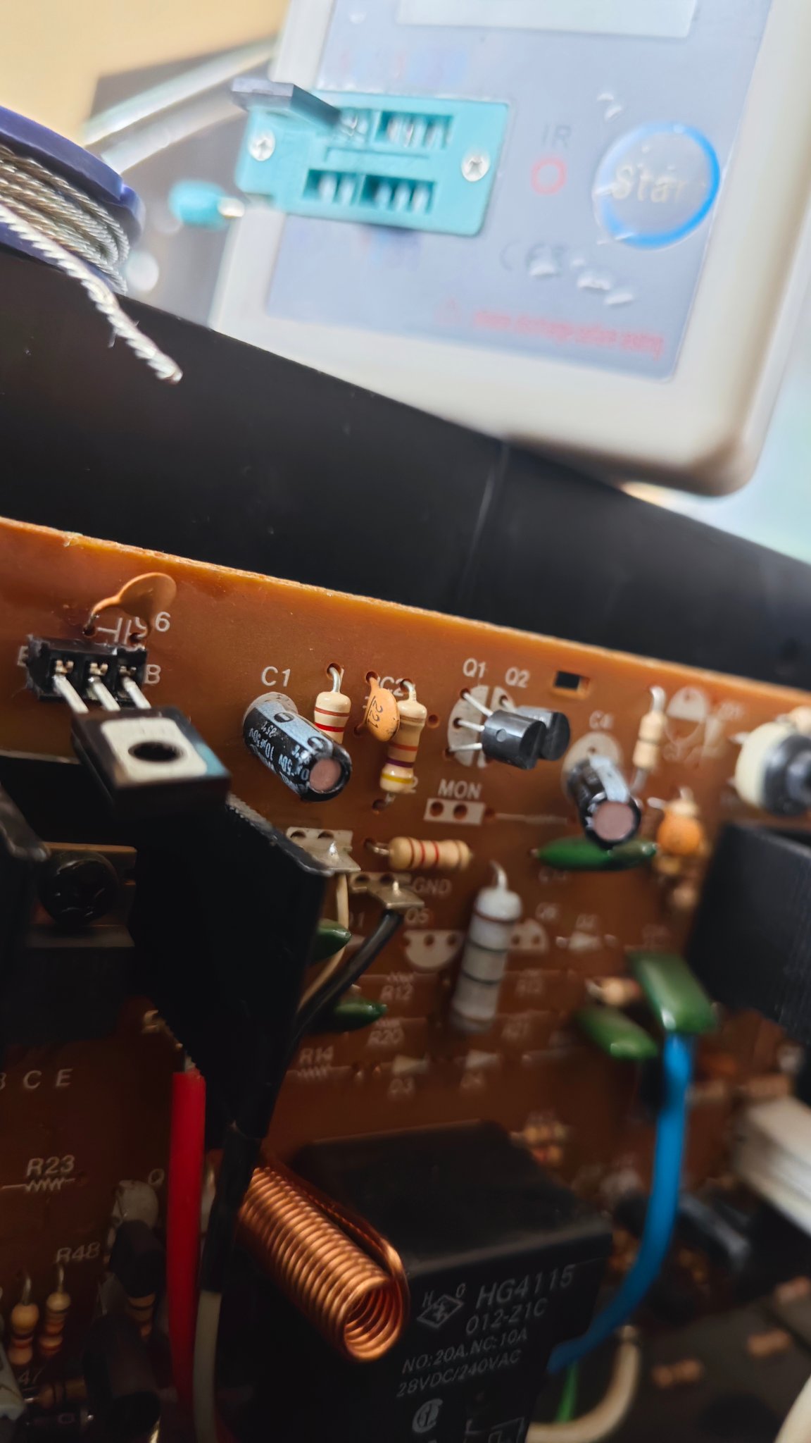

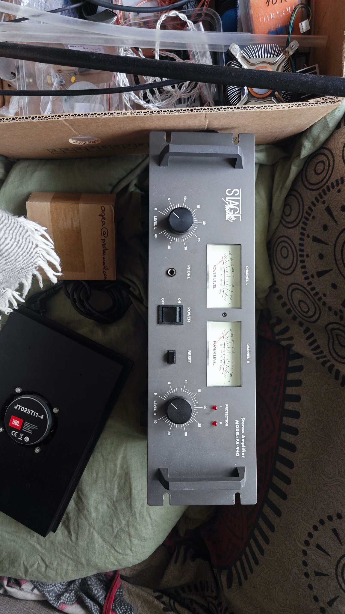

Btw on this PA-940 at Q4 I installed a three slot socket so I could change the transistors in around 10 seconds in this algorithm:
1. Turn off amp
2. Unplug current transistor
3. Install new transistor
4. Power on
And did a lot of testing (~50 or more changes between around 8 different batches and or types of PNP BJT TO-126 transes). Very very insightful. Indeed the gentleman was right - the differences and sound between the different batches of BD442 were profound, except I never had it done so easily and quickly. As a general rule the more doped ones (higher hFE) sounded better but not always. As for the original ones - they made much duller sound in this position. GREAT LITTLE EXPERIMENT! And proof of one of the concepts the controversial gentleman wanted to establish, even if he his tactics ended up getting him banned.
Anyhow - AMAZING LITTLE AMP! Indeed quite unbeatable for the price. I have many more amazing amps and projects of greater costs and qualities, but this thing will not become a dust collector on the shelf, I can tell already, it will see some use. Many would be surprised by how cool this is. So these are my words of encouragement if anyone wants to pursue the ideas in this thread (other than changing the output transistors, I'm still using the originals). But we can talk about potential alternatives.

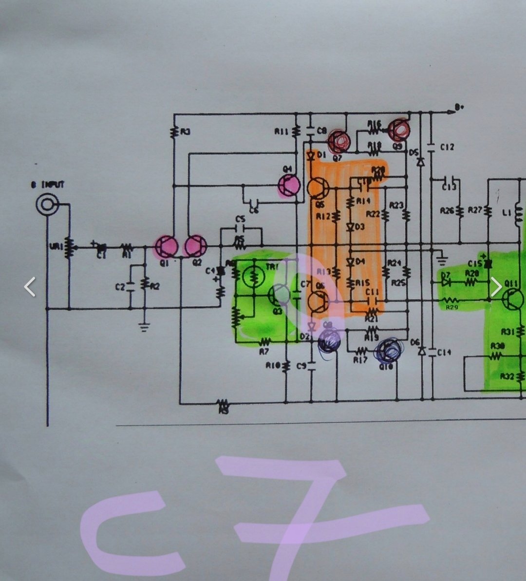

The only “screw” that need turning is that R10 is technically incorrect. Implementation without a bootstrap is wrong from a purely technical standpoint, although it MAY result in something that subjectively “sounds good”. Other than that the only thing I’d jack with is the ratio of R3 to R11 to ensure differential balance, after ensuring the match between the transistors is 5% or better. Because the folded cascode is resistive loaded as well as not using a CCS in the VAS or LTP tail there is probably no benefit to matching differential current down to .1%. But certainly make sure it’s not just totally out of whack, which it could be as stock.

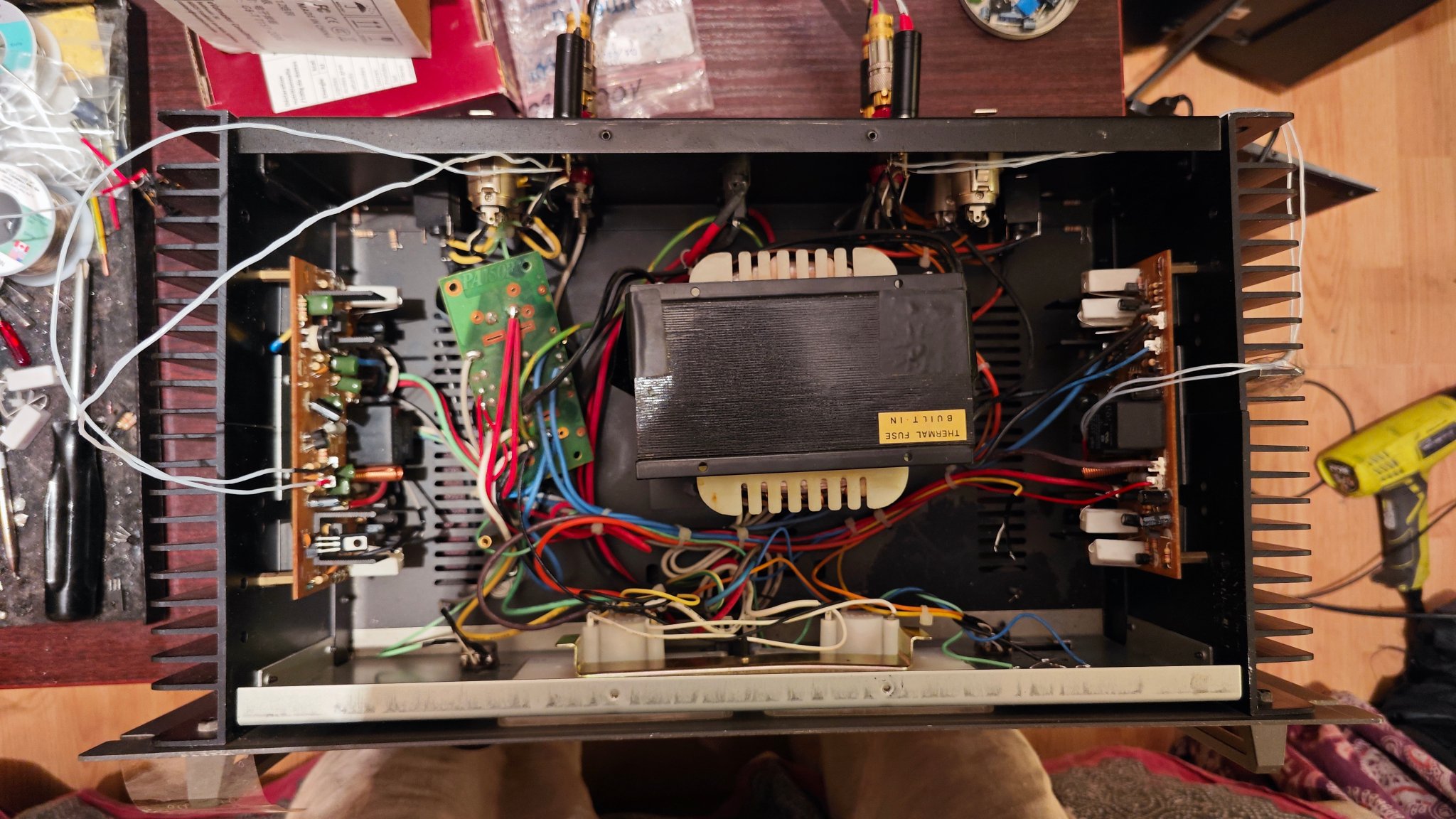

Well, this (see pic of right channel) actually solves at least 33% of my the noise, so with shielding, I should be pretty much good. But the original filter has really small caps for this kind of beefy device, only 6.8mF, so I'll add additional high voltage caps that I already have laying around.
BTW modifications done so far:
R24 and R23 - removed
Current limiter - removed (this is what makes this amp worthwhile)
Q4 - replaced with BD442, most likely any of them will sound better than original, but some batches (higher hFE usually)(which varies a lot) sound even better.
Volume pots - removed
Left channel ground wires connected to the amp section ground instead of protection circuit ground. Speaker output ground moved to amp section ground. (At this point I think I heard slightly Superior sound on Left channel. I was ABing using -30dB DSP on one channel.)
C7 replaced on left channel (KS-A 220 uF, 10 V) there is no doubt that left channel sounds better. Can someone please help me understand what voltage this cap is exposed to?
Added 15mF 80V cap on positive and the same on negative rail. Not even 0.2dB reduction in noise, which was 40.4dB in close proximity to the speaker. Soundwise it's definitely not detrimental, but it takes too long to attach and disconnect to be able to tell in confidence.
Crackling issue was a stupid mistake - I forgot to remove C10 C11 C12 C14. Idk the reason for C12 C14, they aren't current limiter and it wasn't mentioned ITT, but judging from pictures cumbb had them removed so I did the same.
Noise will hopefully be improved a lot by shielding input cables otherwise I'll have wrap the whole trafo in something or make a steel box. Aluminum wouldn't work, now would it? Easier would be just to move the trafo outside of the chassis.
