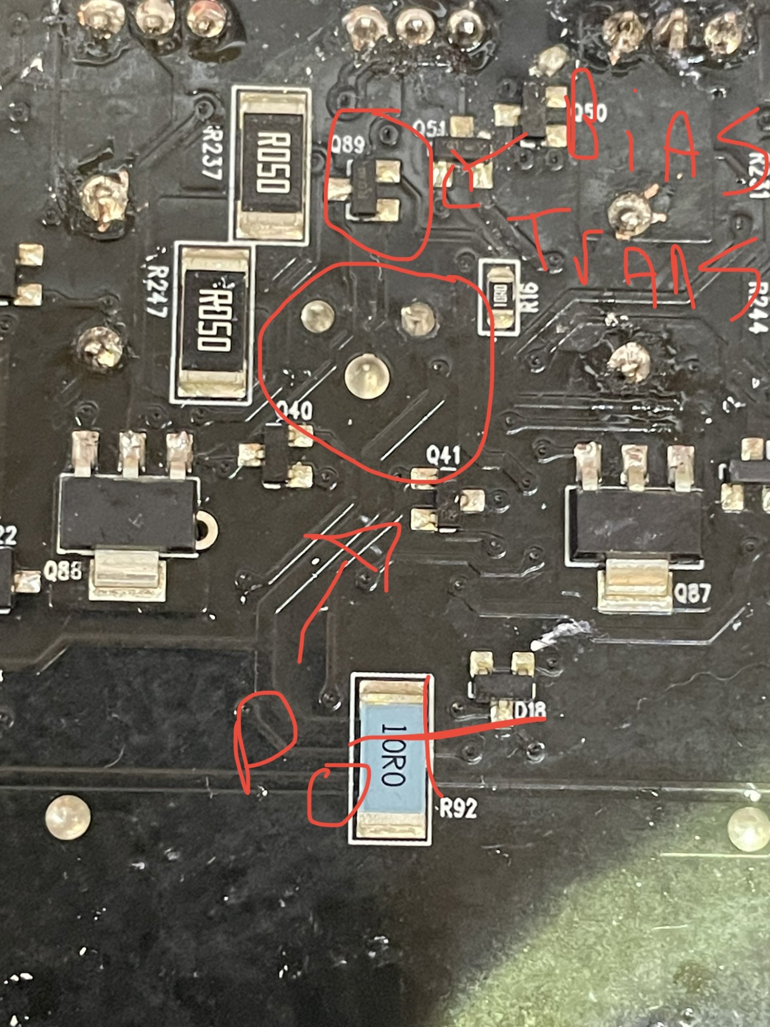

P600x4 keep blowing same channel
Is there a trick to getting the epoxy off the pots for adjustment?
Desolder and replacing it would be my course of action. I wouldn’t bet another set of mosfets on the integrity of the wiper contact after pulling the epoxy off.
It could be a bad pot. It's relatively rare but it happens.
I experienced symptoms that would come and go without any pattern. The DC offset would dance around +/-15mV and occasionally turn to thunder. In my case, it was corrosion/tarnish on a DC setting potentiometer wiper, so I replaced them on both channels with modern o-ring sealed types. If that had happened on the idle current setting pots it would have been terminal.
As seen here

I did know that about the canned air.
Hitting anywhere near the pot with heat drops the mv across the the resistor dramatically. This all without pushing or pulling on anything. That being said. The other channels are behaving the same when heat is near the pot.
I get a bit nervous without the mosfets being clamped down because the 317t gets quite hot.
The only reason I wanted to know where it was was to prevent you from spraying it with the refrigerant. That could make the idle current spike.
Between heating and cooling and pushing, I was hoping that you could find an intermittent problem.
Instead of just pushing, did you try tapping?
At this point, I don't know. It's the randomness of the problem that makes finding it difficult.
Is it possible that you inadvertently solved the problem the last time you repaired it?

So far heating up the area near the pot and fets (hard to isolate the heat) lower the current from about 1mv down to .3mv within seconds.
I wonder if it’s possible that the push pull drivers could be an issue. I do have those transistors. I wonder if I should change them out on that channel?
What I was looking for from the heating and cooling was something that was going to try to cause the amp to fail, like a heat sensitive component but there doesn't appear to be any.
Heating of the bias transistor (through the board) is supposed to drop the idle current. The bias transistor compensates for the properties of transistors that make them pass more current (when passing minimal current) as they heat up. During normal operation, without a bias compensating transistor, the current of the amp would do just the opposite of what you see when heating the bias transistor. Eventually, as the amp heated up in a sort of snowball rolling sort of way, it would self destruct.

I have done the heating and cooling with idle at 1mv on the bad channel.
Heating does as you stated and cooling down to frost with the air can took it to around 14mv which quickly dropped.
I did push all around the board and noticed no significant changes in voltage across the resistor.
Amp is currently running again for now.
Do you figure 1mv on all channels at around 70deg Fahrenheit should be ok?

1mv should be OK and it should hold at all temps. That's what the bias circuit does. Not all are perfect but most are pretty close. There's nothing stopping you from running the amp hard enough to get it hot (normal operation, not spot heating) and re-check the bias. If you do this, check the biasing at several points as the amp heats and cools.
If you're concerned, run a 20kHz signal through the amp (about 1v at the loaded speaker terminals) and see if the signal is distorted.
