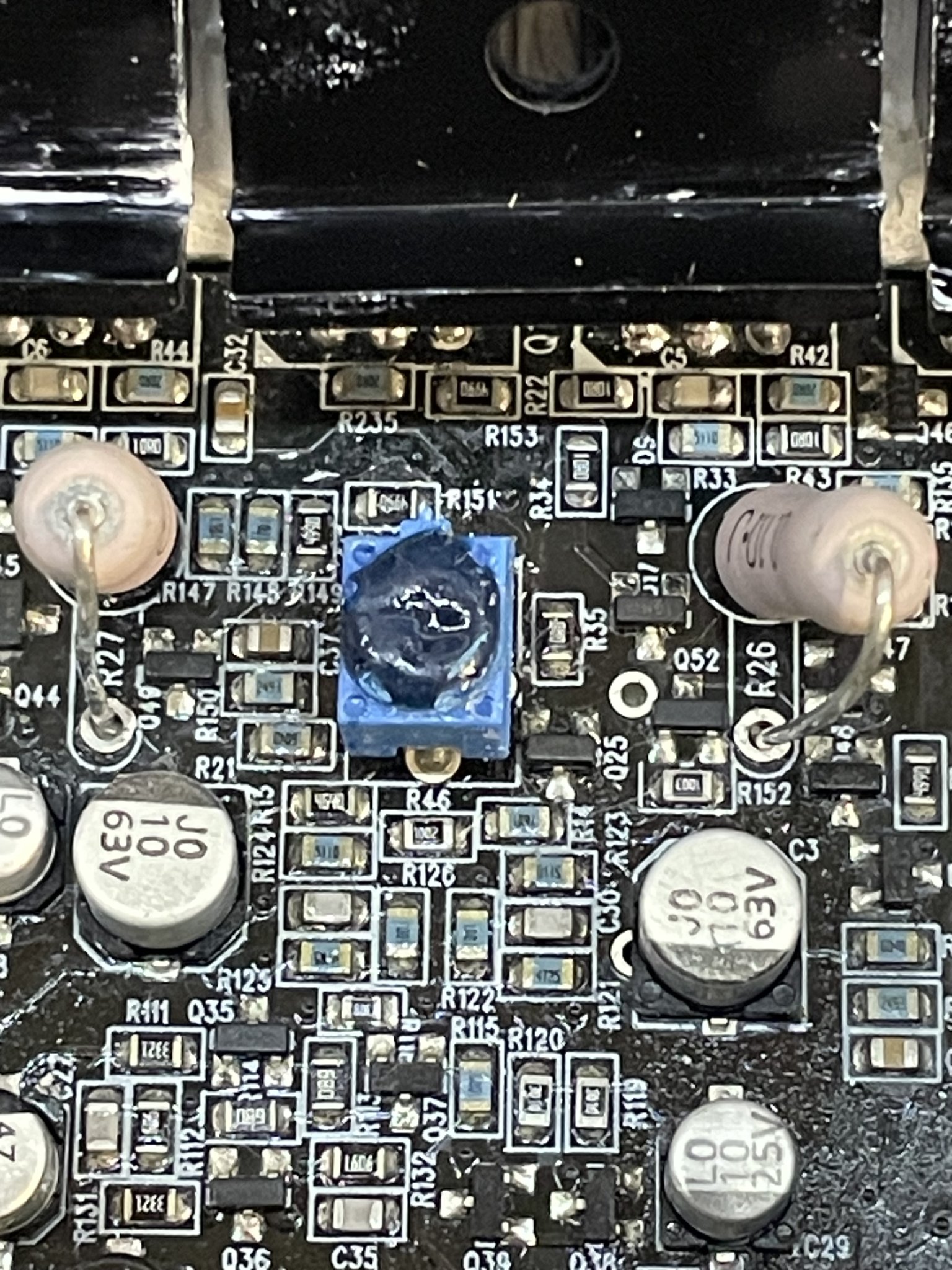

I ran it hard with a dummy load. I have high wattage 4ohm resistors. One thing I just noticed is that when I touch the ground on the left rear channel rca. The amp goes real hard into clipping (red) and the mv goes up to about 150mv .
That is also the bad channel
The other channels do not do this to that extreme even with the gain the same.
I’m questioning that maybe the shielding is bad on the channel

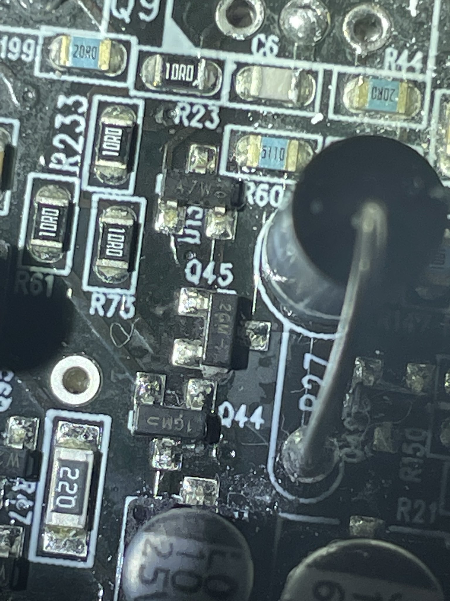

Currently the amp is running again. The only change that was made was biasing the bad channel up to match the rest (around 1-1.2mv).I ran it hard with the dummy load on the bad channel for hours. I also manipulated the board with a non conductive pencil using hot and cold as recommended. I still have no confidence that this will not randomly blow the channel again as this has happened a few times before.
One thing I failed to mention whether it matters or not is when the channel blows the affected speaker (channel) pops at a relatively low frequency while the others just turn off. This in turn did unfortunately kill one of my speakers. (Melted the voice coil)
