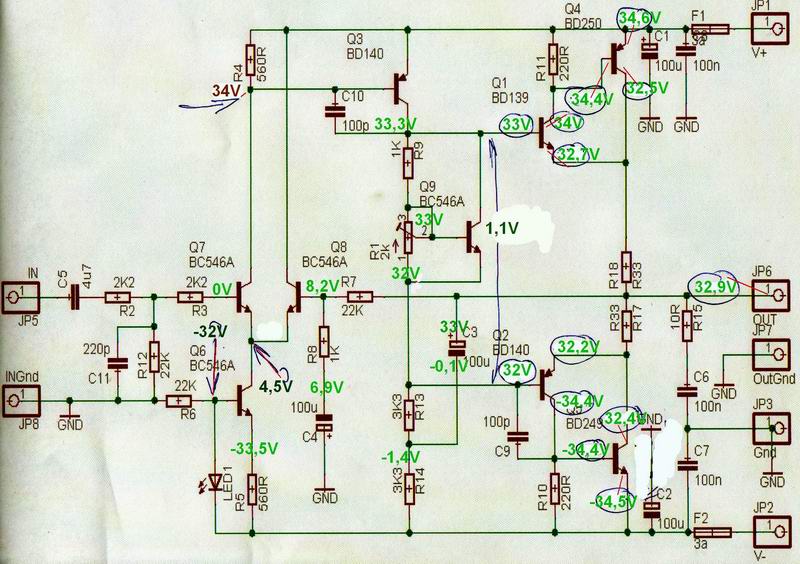

i have constructed a P3A amp and when i powerd it up the replace transistors C546 burned. :hot: (i understand that that was the problem with the transistors)
after that i have build the amp again using new part (others) and I get 33V on output.
I am using BD249C & BD250C with BD139/140 and BC546A.
I measured the voltage and all the results are presented in the picture:
the reverse voltage on BE of Q7 and the 3.7Vbe of Q8 probably mean both these are damaged. Replace carefully. Do you sink the small device legs while you solder? I don't and I get away with it. I know I should!!
That 1.1V across the multiplier may indicate that the output stage is undamaged.
Why is there only 6.9V across the DC blocking NFB cap? Is it leaking badly or damaged or is that normal for a high output offset? C4 is back to front. It is normally biased the other way when the circuit is operating correctly. That probably explains the ONLY 6.9V across it.
Hi adi81bv,
The voltages around your diff pair are normal for this fault condition. They have been damaged. They may still work but the hFE may have shifted and they will be noisier than they were. Replace for that reason and match for beta. Andrew is correct in that your emitter voltages should be approximately -0.65 VDC from a ground reference.
Q3 appears to be biased on but should be off (ie 0.00 VDC from emitter to base). You should check it to make sure it isn't shorted, also check that R4 is soldered properly and measures correctly. If Q1 was shorted or your output, you may get these readings also. However, Q3 should be off and it could be Q7 in reverse breakdown.
Thermally couple Q7 and Q8 when you replace them with a matched pair.
-Chris

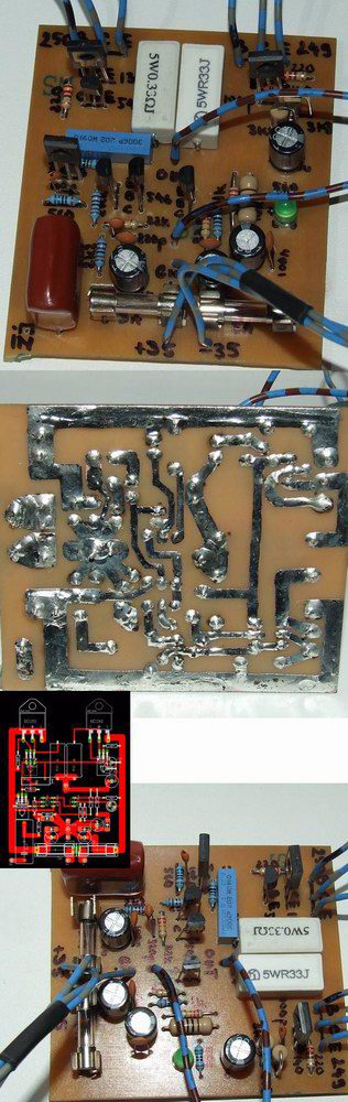

i verified every transistor. hFE, and resistance - they all seem to work fine. I verified 4 times the tracks and the solder. I verified the correct soldering of the transistors on the pcb.
anyone have another ideea? i dont know to much electronics.... i was told that this is a easy amp to build, but i build 2 of them and both are dead. 🙁 dont know what to do....

At least you are consistent. There is something that you think is right, that is not. At this point you need someone more familiar with electronics to look over what you have done. Perhaps if you could take a picture of your work and post it?
-Chris
i checked R13. it is correctly soldered. may be the transistors? there can not be the resistors (it's the second amp that i am building; the first didn't work either and i changed the pcb and all parts) i measured all the resistors prior to soldering and checked 3 times the circuit for correct alignment and short-circuit.

As Andrew pointed out a few posts ago, C4 is reverse biased and very leaky (there should be no DC drop across R8, because no DC should be flowing through C4.) A leaky or shorted C4 will still sort of allow a working amp to work, it just will not take DC gain to unity.
If (when) the cap blows open, you have no feedback and the amp will not function.
When you get done with transistor swapping, check all your caps for overstress.
- bkb
Hi Ken,
The root of the problem seems to be an output condition that the differential pair could not correct. So the cap and several other parts are what we could call collateral damage. The cap is but a victim, not the cause.
-Chris
You haven't accidently put the wrong polarity devices in on the front end? Re-check your diff amp transistors - also check that you have sired them, in correctly wrt Base, emitter and collector. Seems you have a problem in the front end you need to fix.
