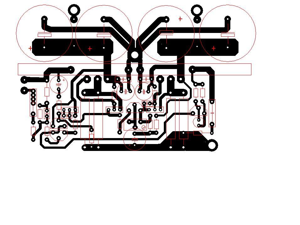

PCB by sakis
Signal GND does not connecting to PWR GND.
FB cap must go to the signal earth, and it's better to take the FB resistor before Zobel. And one of the PSU caps is reversed.
Anyway looks OK.
Anyway looks OK.

Re: PCB by sakis
signal ground is connected to the power ground through a pin that you can see in the midle top left .... there is suppose to be a link placed there .... the FB resistor cannot be placed other wise as fas as i can understand
fjr said:Signal GND does not connecting to PWR GND.
Anyway looks OK.
p3a layout
i'm afraid there seem to be a couple of errors on this pcb:- the drive to the vas transistor, and the connection of the vbe multiplier to the vas(no connection) hope u don't mind me pointing this out!

p robertson said:i'm afraid there seem to be a couple of errors on this pcb:- the drive to the vas transistor, and the connection of the vbe multiplier to the vas(no connection) hope u don't mind me pointing this out!![]()
you are very correct ...thanks for pointing this out i will fix it tomorow ...
thanks !!!!

hello everybody.......within 3 weeks I managed to design a new layout for P3A amplifier but with 2 pairs of final transistors......I don't have the time to build it but maybe some of you have (and post some pictures if you want).......I made some minor modifications against the original schematic......I hope you will like it.
PS: in front of the pcb is the signal gnd and this will be connected directly to the main power supply.
sorry for my english, I translated with google 🙂

it will be more wise to read the P3A tutorials to see each and every small detail of the construction ( since it perfectly analyzed ) before starting to modify things arround
your layout is not bad but has some small details here and there to be looked at ( small details can make the diference from a good amplifier to a perfect amplifier )
Beyond that you have some design troubles that you have to look at ...example adding miller caps to all drivers and VAs stage will not do you any good
Final advice will be to costruct the P3A as is if you like ( even better with original pcb ) and then go for EFP design and not an sziklai (CFP circuits are more easy to oscilate than EFP ) and if so go fro a prooven design and skip the expiraments
to modify one amplifier cannot be done with adding a few things of this and a few things of that .... it will take more than that ...since we dont talk about modify but actually redesign an amplifier ...
regards sakis
