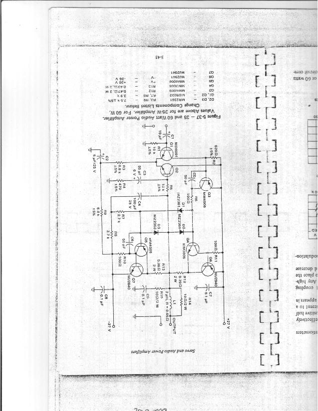

foto: nice little substitute for an amp(lification of emotions);
annother theme:i found an old schematic (perhaps late 7ties,mullard?).i think it looks like the p3 a little bit.
greetings all to you.................
