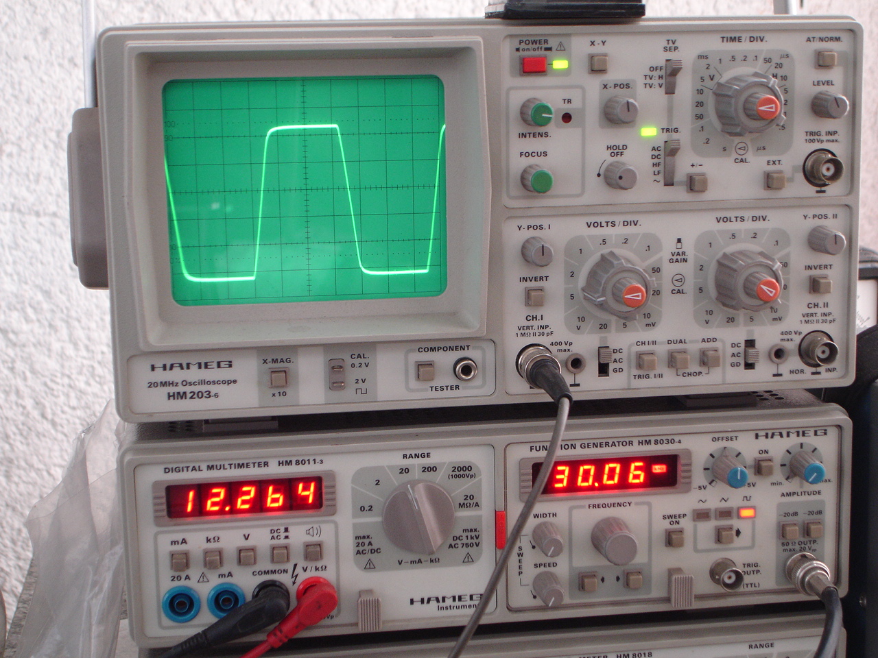

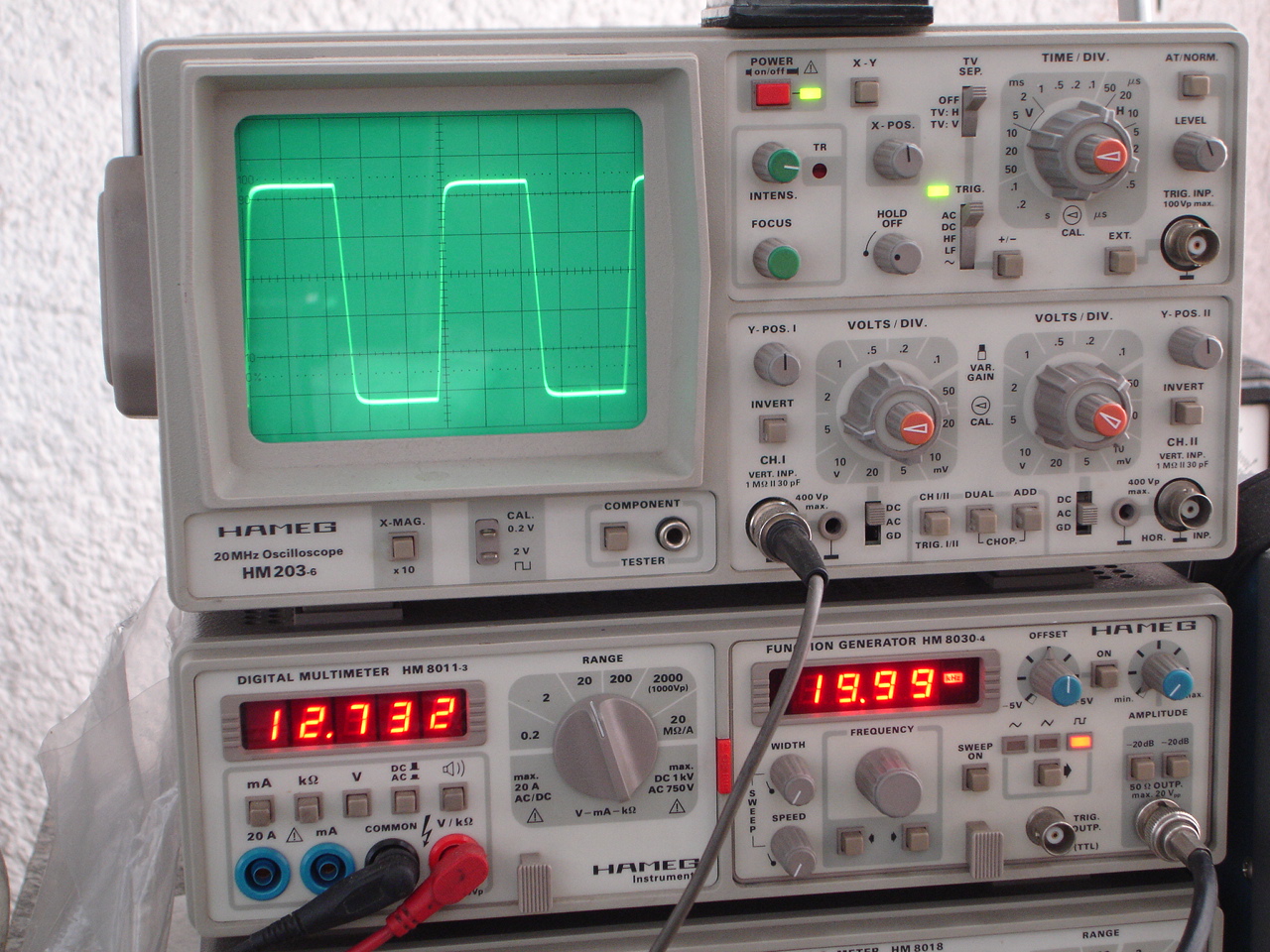

P3A

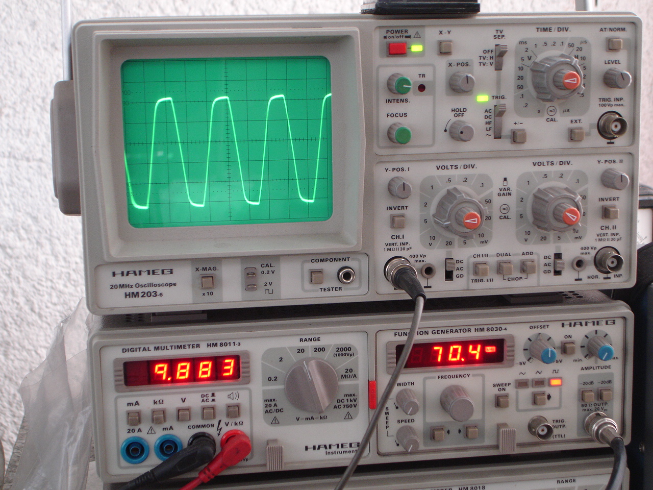

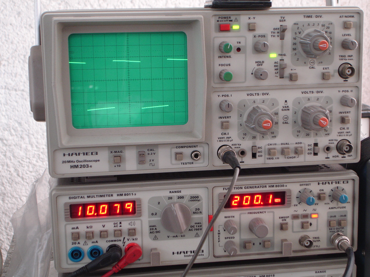

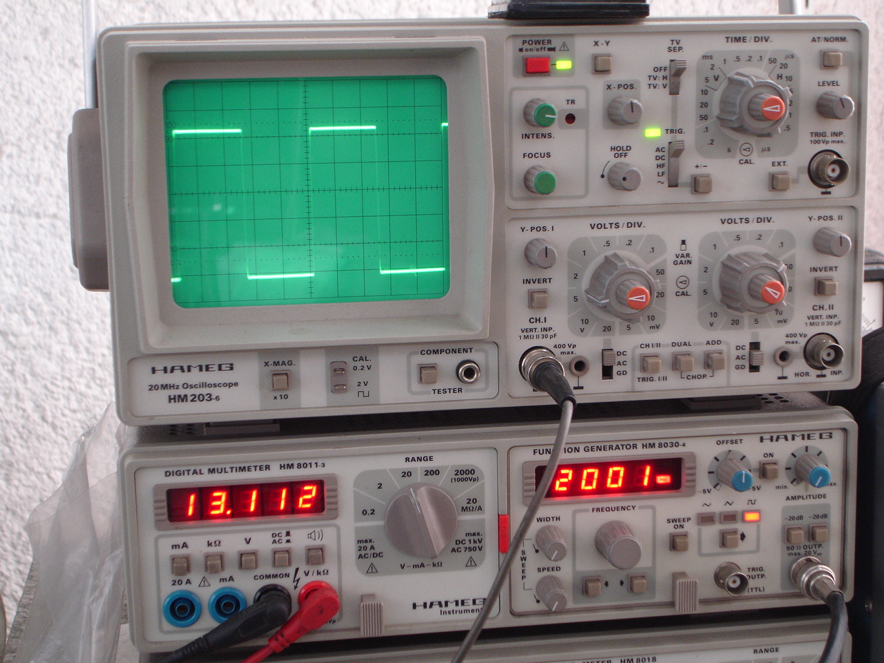

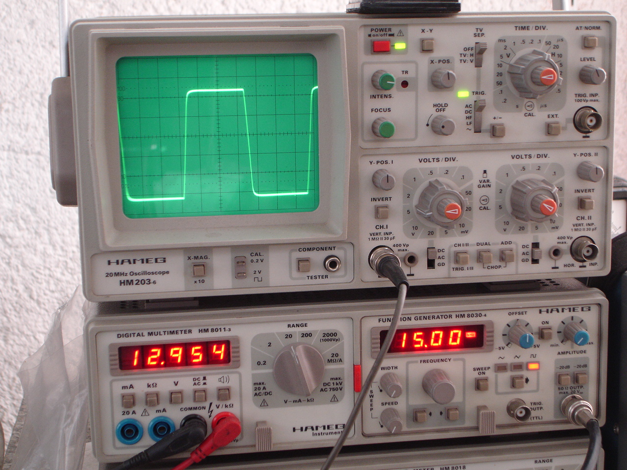

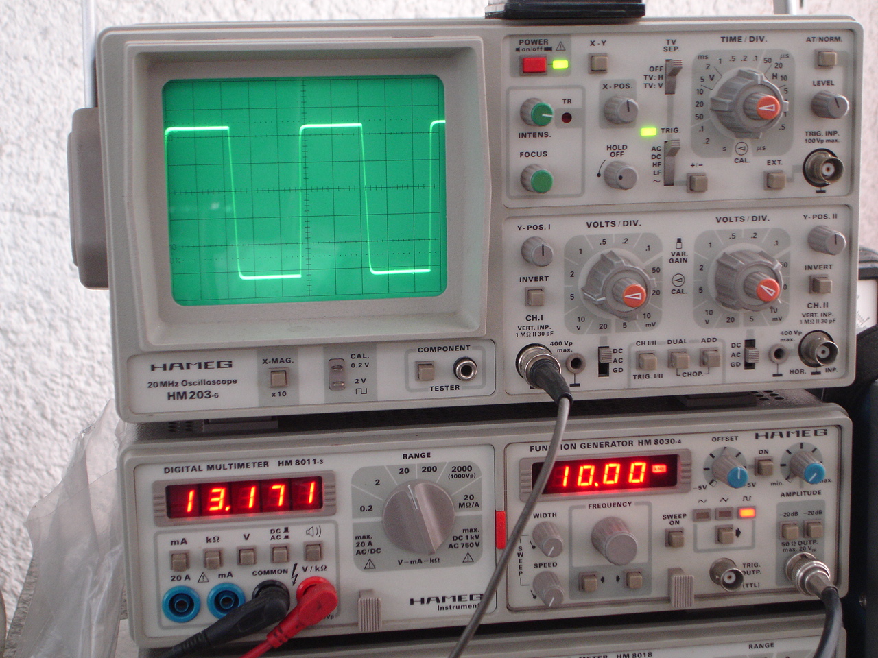

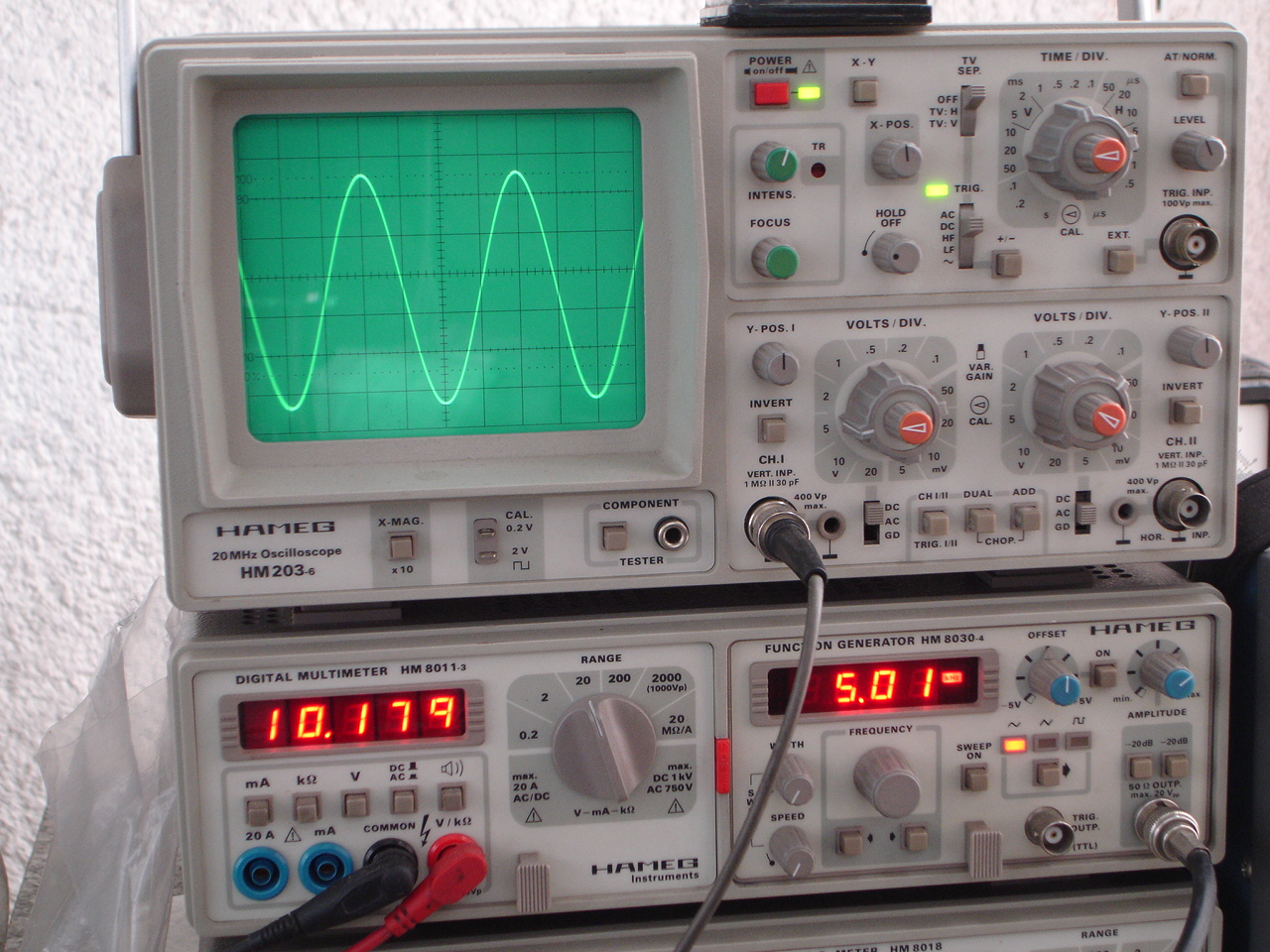

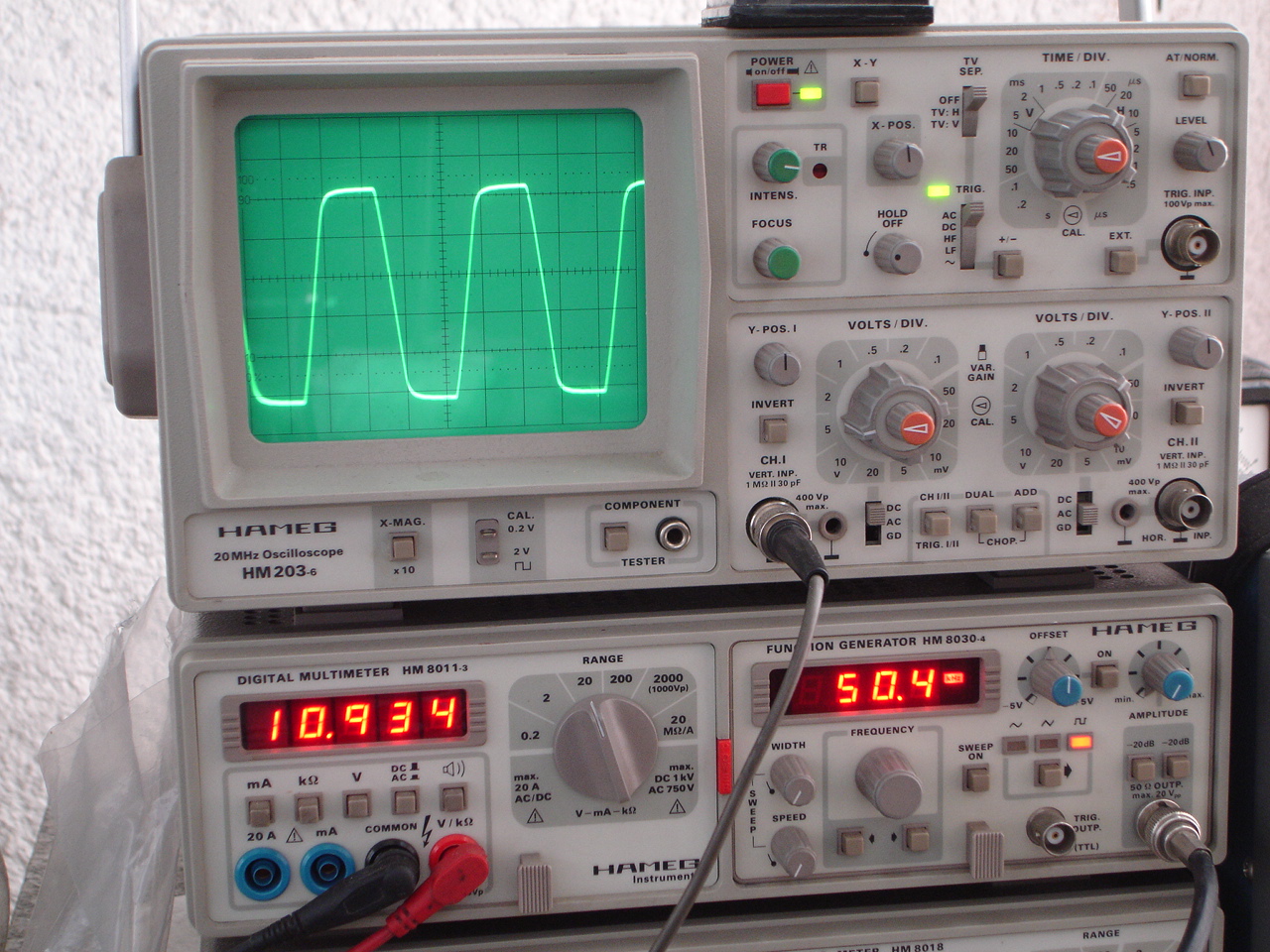

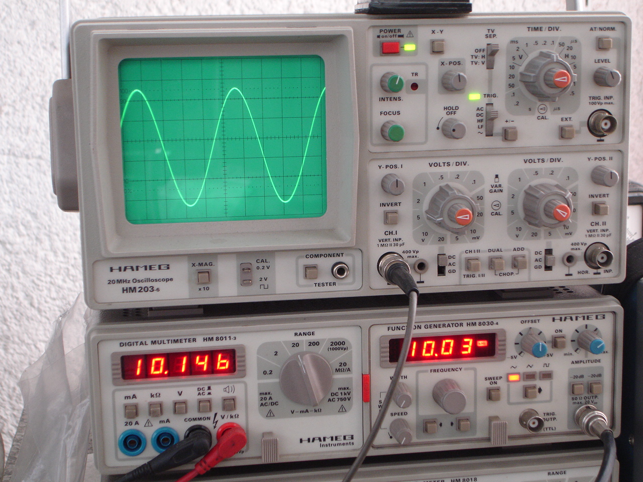

Some measurments.
Some measurments.

Thimios ... measuring square wave in such a low frequency ( if i have seen correctly ) no more than 1KHZ will not tell you much
Expect 10 or 20 khz at very low power to present problems if there is any ...
Kind regards
Sakis
Kind regards
Sakis

I have 1/10,000th the experience of you Sakis so please be patient as I have a different thought on this.
Firstly, a square wave, if an ideal one, has only rising and falling edges. We are looking to see how the amplifier responds to these edges and less at how it behaves during the time between. So at first we really don't care about the fundamental frequency, if it is 1kHz or 10kHz doesn't matter. We focus on the behaviour of the amplifier to the signal where it is changing rapidly.
There is a big danger in working at 10kHz or 20kHz - you increase the power dissipation of the amplifier by an order of magnitude. If you apply a large 20kHz square wave to an amplifier and into a load there is a good chance it is the last time your output devices are functioning.... it is a little safer at 1kHz.
Getting a good square wave isn't always easy. You want really good quality rising and falling edges with no nonsense going on. Well, the oscilloscope test point with 1KHz has been engineered for as close to perfect square wave as possible (within cost of unit) so you have a very nice test signal.
Just a thought.
Just a thought.
Gareth ..
testing an amplifier to these edges and above 10KHZ as said it only takes place in very low power ...But yes square wave with capacitive load is a nightmare for the amplifier ..
Ringing there is expected and from the looks of it you may understand many things .
A test as described above will not help much when you spec the amplifier ( except speed probably) But can and will present stability problems if any exist
I like the P3A i make to go easilly above 40KHZ square wave with no problems at all
Kind regards
Sakis
Kind regards
Sakis

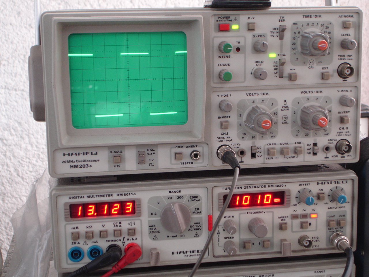

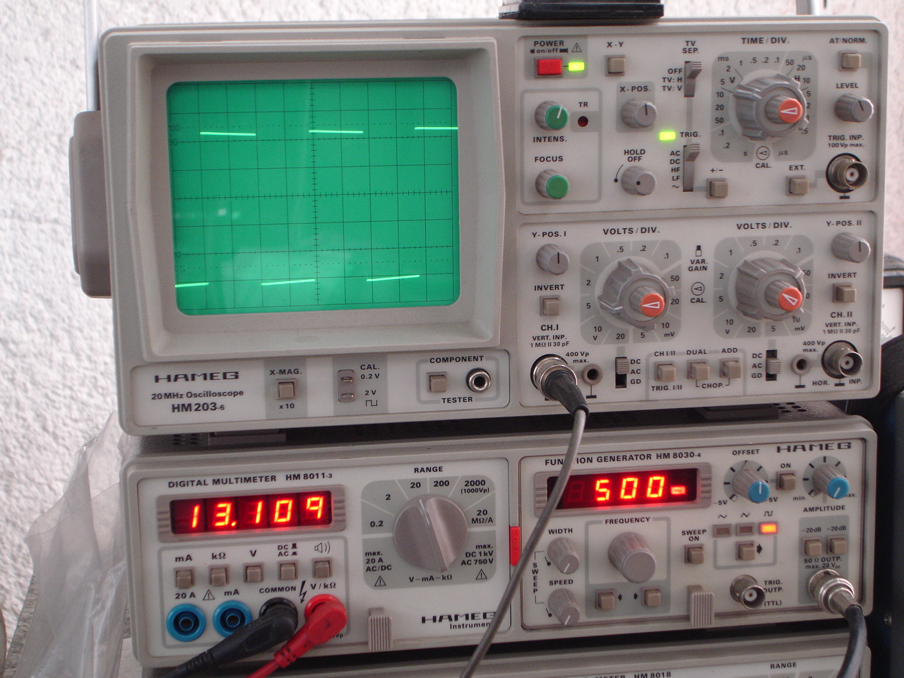

POST#370 Last picture 8W 100KHZ
That is why i always put a paper sticker with the conditions makes it easier for people to read .
You are doing better than fine !! i hope you enjoy listening !!!
Kind regards
Sakis

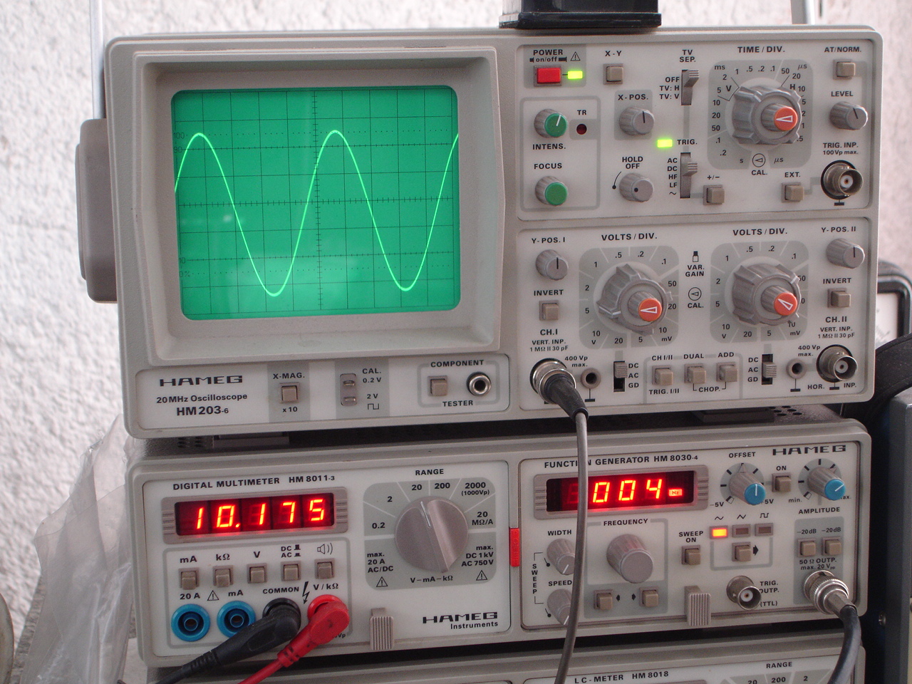

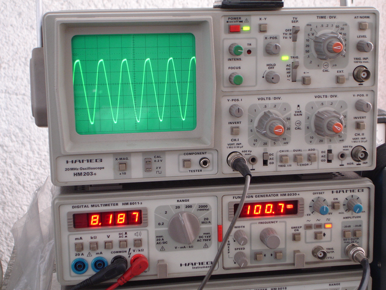

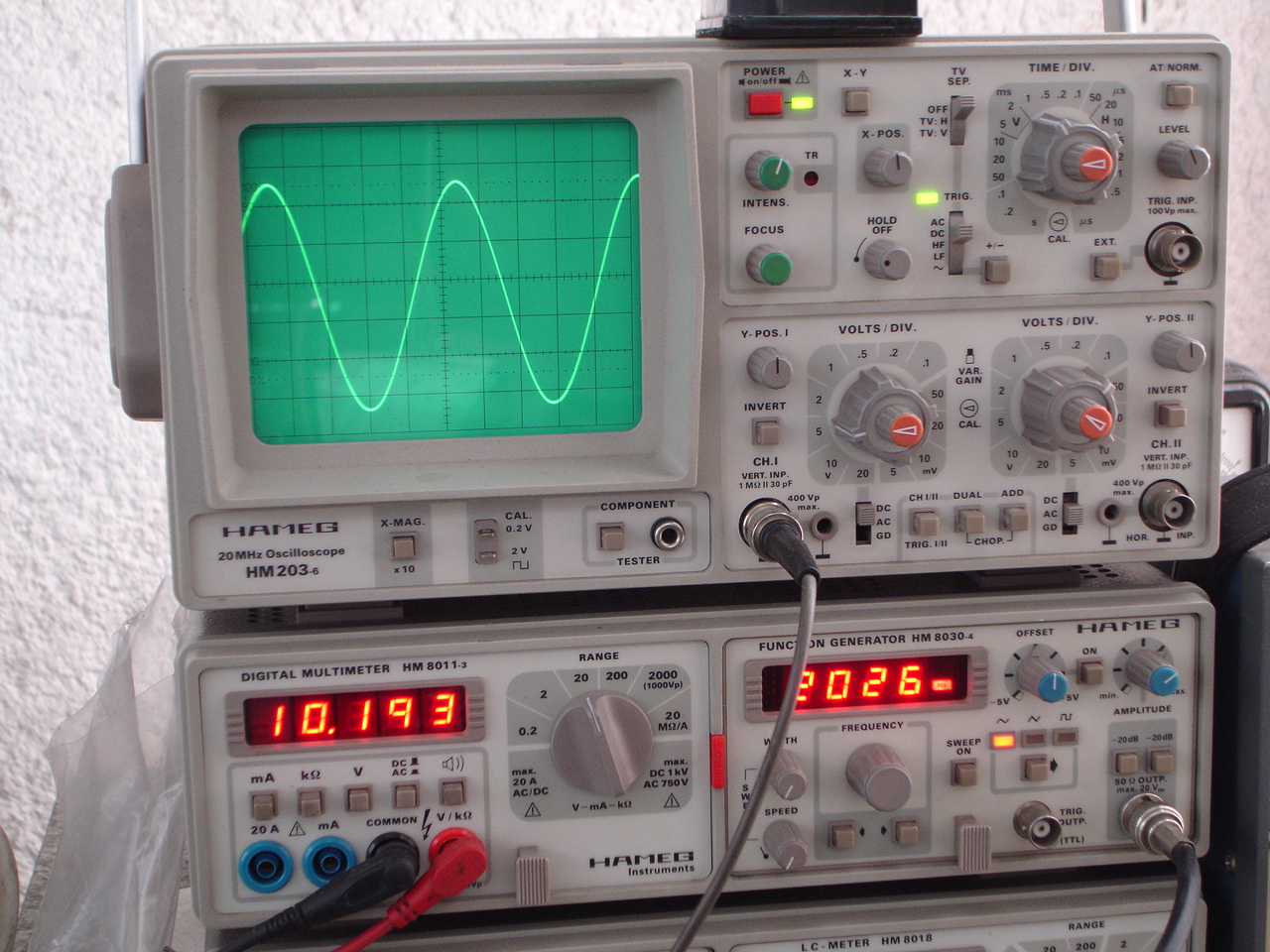

P3A
Square Wave test in these levels(voltages, frequencies) is a stretch test.
Everybody can agree that a stretch test is useful or not.
Post#369.
SINUSOIDAL
1)100Hz/10V RMS
2)240Hz/10V RMS
3)2Khz/10V RMS
4)5Khz/10V RMS
5)10Khz/10V RMS
6)20Khz/10V RMS
SQUARE WAVE
7)100Hz/10V RMS
8)200Hz/10V RMS
9)500Hz/13V RMS
10)1Khz/13V RMS
POST#370
1)2Khz/13V RMS
2)10Khz/13V RMS
3)15Khz/13V RMS
4)20Khz/12.7V RMS
5)30Khz/12V RMS
6)50Khz/11V RMS
7)70Khz/9.8V RMS
8)100Khz/8.1V RMS
Regards.

Your low frequency (100Hz to 500Hz) squarewave signals show significant LF filtering.
What is the passband of the amplifier?
What is the passband of the scope probe?
