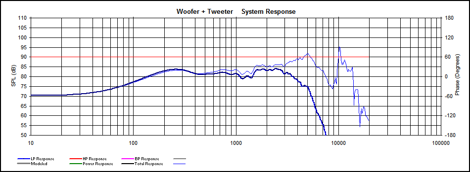

Looking at the response of the woofer is plays at 85 dB/m and the peak at 3k Hz has a sudden drop. That drop is not visible in your simulation. The owner of the speaker complains about a muted treble and missing mid range with the stock crossover. My solution will address these problems.

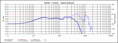

That's not my simulation, that's the designer's simulation, from measurements, with phase. It probably matches reality almost exactly, except for the smoothing of course. Anyway, the mfg. page does show a breakup peak around 3kHz, but everyone else seems to measure it closer to 5kHz. Here's a sim of Paul's low pass using Parts Express' measurements. You can see it's pretty comparable to what he got with his own measurements (that being what I posted before):

Most woofers have two peaks. After the first peak most woofers are no longer usable. The tweeter will have to cover the mid range on its own. My solution will fix the problems. Trust me.
So, this woofer has a second nasty peak at 5k Hz? All the more reason to filter out its mid range all together and let the tweeter take over.

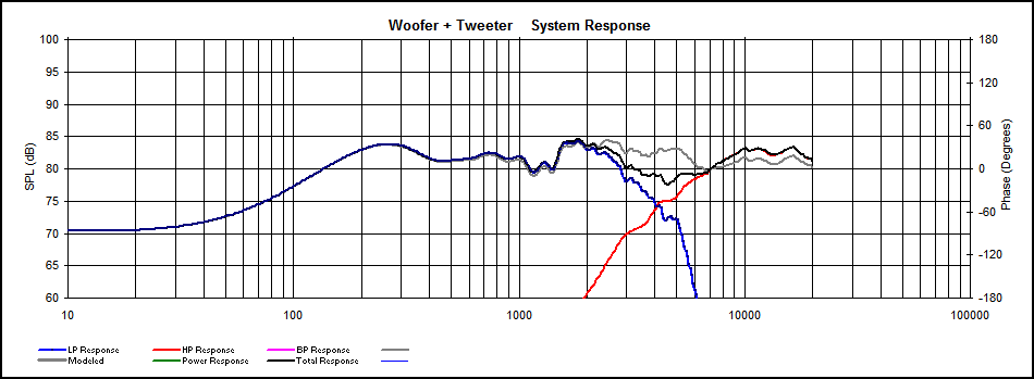

I'll check it out, I guess, but I don't follow what you were trying to describe. Do you want 10Ω + 2.2uF series RC connected in parallel with the 6.8uF in the woofer filter, and then the 2.2uF in the tweeter filter replaced with 6.8uF? That does this (dark line) and also leaves phase about 90° out of alignment at xover:

And remove that back-stabbing 0.22 uF capacitor. The fancy idea is that the woofer should let through some sound above 10k Hz to aid the failing response of the tweeter, but the result is two drivers totally out of phase with each other, mudding up the little sound there is to make the treble an annoying slush of noise.
That's not the idea. It's not like I think this is some kind of incredible speaker (it's designed to be cheap and easy, for goodness sake), but you should really stop spouting out crossover changes as if you know for a fact what they do, especially since all your changes seem to do the opposite of what you say.
The 0.22uF creates a notch that cuts the woofer down harder from ~7.5-14kHz. It's trying to knock down the worst of the break up more. If you remove it, you'll let through more sound in that 7.5-14kHz range, not less. Above that is where it actually lets more sound through and affects the phase, your complaints. It's like -60dB there.
If you're going to make specific technical criticisms of someone else's design, that's fine by me, but back it up.
