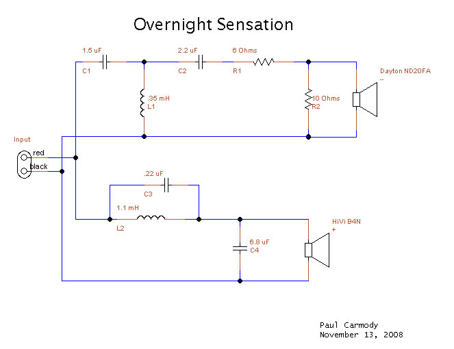

The crossover looks very bad. The woofer cut off looks to be 1.5 kHz and the tweeter 6 kHz. This is from just a glace. It gives me a head ache.
What, it is 4KHz. Research further if you want to give bad credit 😀
I've been looking at this a little bit. You will get better sound if you remove the 10 ohm from the tweeter and change place between the 6.8 uF and the 2.2 uF. You will get further better sound if you get another 2.2 uF for each woofer and make a 10 ohm + 2.2 uF link which you place in parallel with the 2.2 uF. Enjoy.
No, strawberry, please believe me that speaker design is not as easy as it seems to the eyes of a beginner 😉
At "low level design" which is based mostly in trial and error, it probably works to design speaker "by feeling" or calculate "in head". But at higher level, which I believe Paul Carmody is at, it is not like that. You have to measure before you can make such comments.
Okay, yes, in general, a series resistor is better sounding than an L-Pad. But removing the shunt R may affect things which severity we don't know without measuring or simulating.
6.8uF can be placed in place of the 2.2uF, without affecting the design severly, but 2.2uF cannot be placed in place of 6.8uF.
But if you mean 2.2uF and 1.5uF then may be I understand where this came from. I myself have always tried to put the smaller caps closer to the tweeter (with 3rd order filter).
I think you both know more than me. I have been sanding, primering and painting since my last post here, so no listening tests going on, but I will be curious to learn more about the x/o as time goes on. I am curious about the comment Paul Carmody made about relaxing the mids a bit so as to not be fatiguing? Well, maybe I would feel the same way, but I might, for example, want to try the more fatiguing midrange at some point as well.
