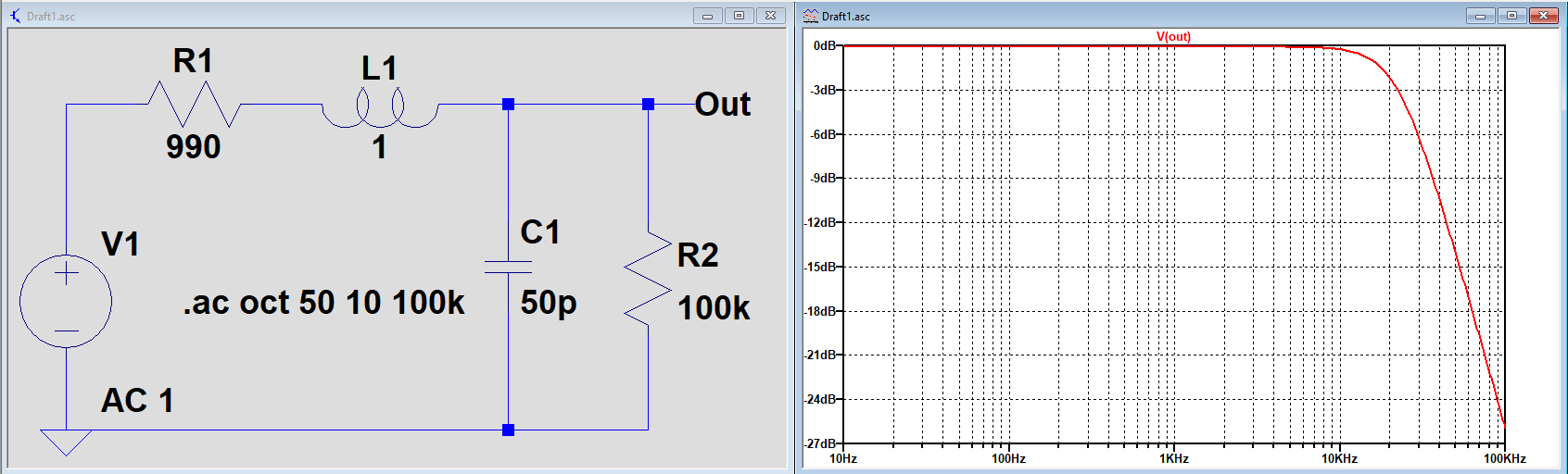

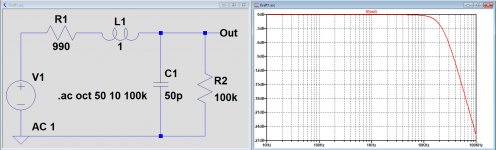

No it's not, because as you must know the cable capacity and the load resistance are taking a very important role in the FR.Isn't that 10 dB roll-off just the normal roll-off of the cartridge inductance and load?
See example below.
Mechanical resonance will also take it's part, but it's obvious that to get an optimal FR, one has to tune the load resistance and the load capacitance in a real life situation.
In that light is making a calculation with an accuracy of 1e-10 rather pointless, sorry for that.
Hans
Your example shows that when you reduce the L/R time constant by using twice the normal load resistance, the -10 dB point goes to 40 kHz. It looks to me like the inductive and resistive effects dominate, although capacitance also matters of course.
I don't see the point in tuning the load resistance, especially not in simulation, when the cartridge manufacturer already recommends a certain value, usually 47 kohm. The manufacturer knows precisely what the mechanical transfer looks like and what effect the frequency-dependent ESR of the cartridge has.
Why don't you simulate your cartridge model with the load recommended by the manufacturer, so you will know what the electrical response (excluding the effect of the frequency-dependent ESR) is supposed to look like?

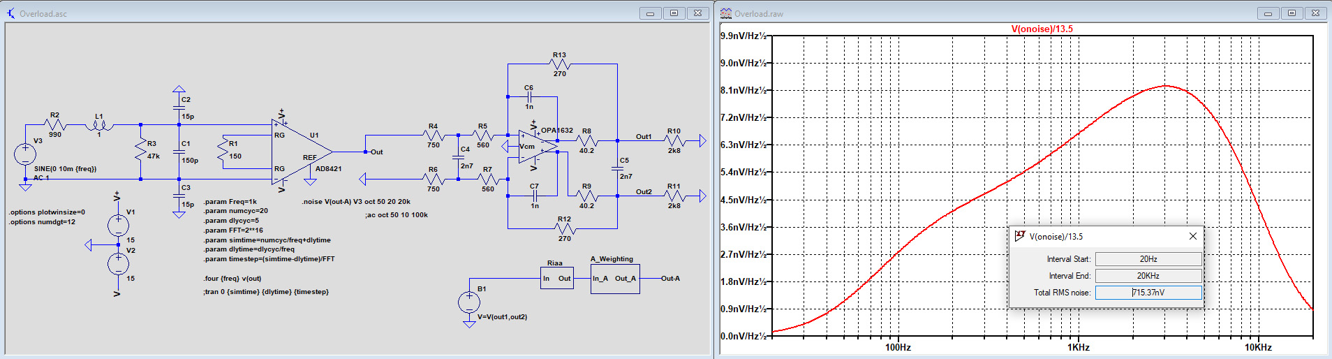

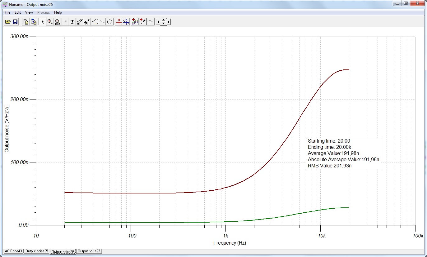

As promised did I try to calculate the S/N for this amp.
Results were disappointing with ca. 68dB-A.
So I looked at the specs of the AD8429 and noticed that the current noise is way too high for a MM amp with 1.5pA/rtHz.
You will have to look for another amp, preferably Fet, but in any case for something below 0.3pA/rtHz.
Hans

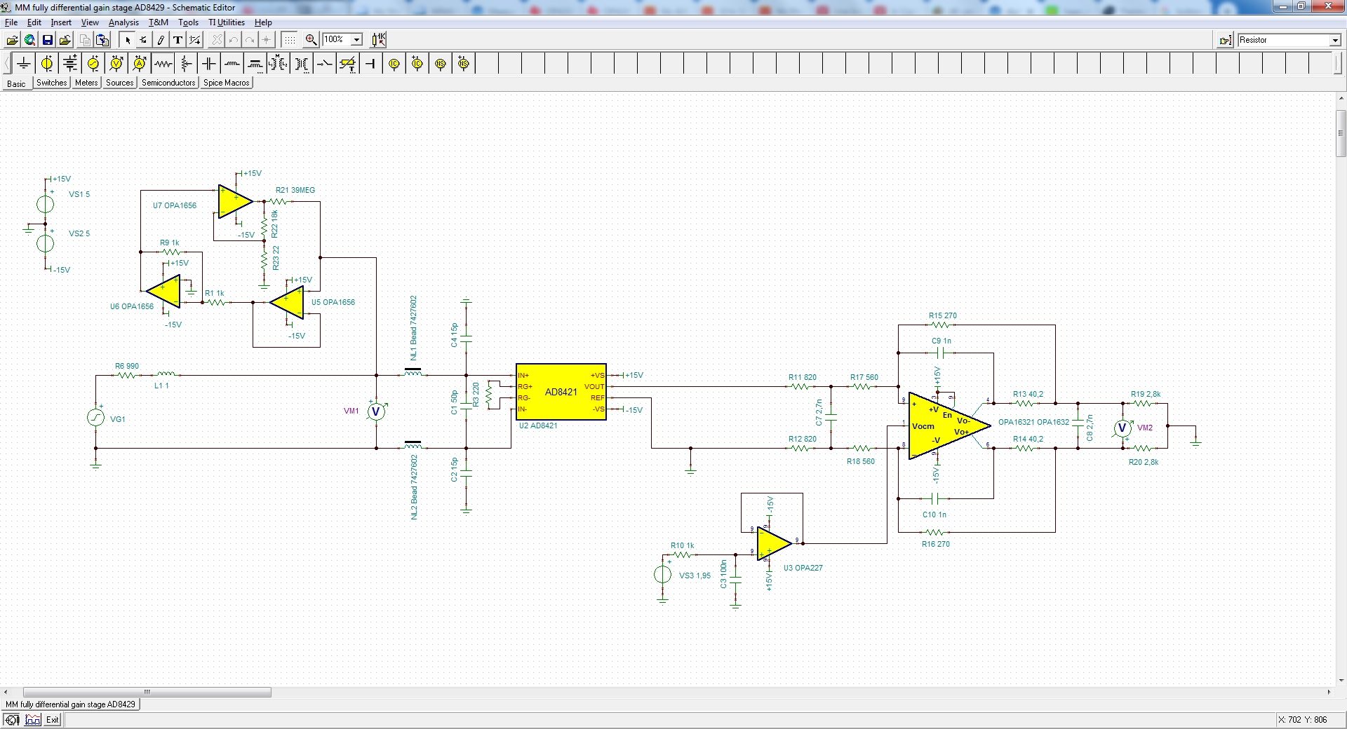

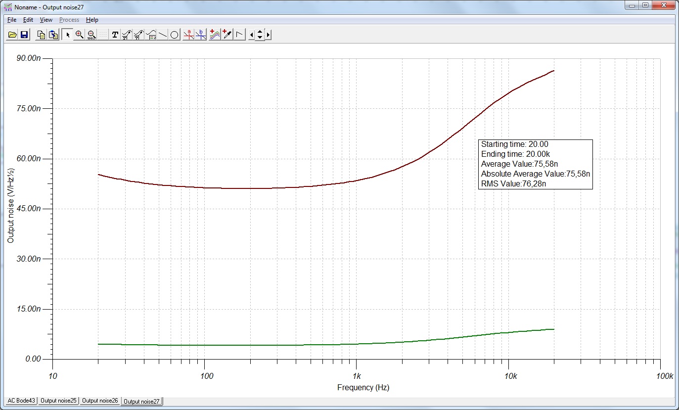

Hi Hans,
Yes noticed that, switched to the AD8421, has better current noise specs 200fA/rHz.
It would reduce the noise current. It also makes it more difficult to make an amplifier that works well with any MM cartridge, because now you have to switch capacitance as well as resistance. Does anyone understand why these cartridges aren't optimized for 47 kohm, like they always used to be?

Mark, just as a refence to compare your amp to commercially available amps.
Many manufacturers and reviewers specify S/N with the input shorted.
This gives of course super optimistic and misleading information, but anyhow a figure of 75dB-A is mostly regarded as very good.
In your case with the AD8421, S/N is 88dB-A with shorted input, showing that with the modern super Op-Amps a high S/N is very easy to achieve.
Hans

Hi Hans,
Thank you so much, I'll update my build with the latest insights.
Right now I`m running with the AD8221, results are dissapointing especially w.r.t. 50Hz and harmonics. Noise is not great either but I think that is due to operating at low gain, should be fixed by the AD8421 circuit.
The 50Hz interferer is about 25dB above the noise floor (with a spray of harmonics visible also), do you think mounting the inamps in a little diecast aluminum box will make a difference?
PSRR is so high at these frequencies that the power supply can mostly be ruled out, so I guess this interference is picked up in the cables and/or on the PCB.

Can you post the exact circuit that you are using at this moment.
Results compared to LTSpice simulations are usually very close.
And at what point did you measure THD and noise.
Maybe you can show the noise spectrum behind the AD8421, that could reveal something.
And you could temporarily try two 12V batteries to exclude eventual ground loops.
Hans

Hi Hans,
Running the AD8221 right now, not the AD8421. 6k8 gain set resistor, 47pF cap on the input and 23k5 from each input leg to gnd. So quite different from the new circuit.
All measurements so far with a focusrite 8i6 and inverse riaa filter, spdif back into the 8i6.
Not behind the PC right now, I'll post the schematic tomorrow
