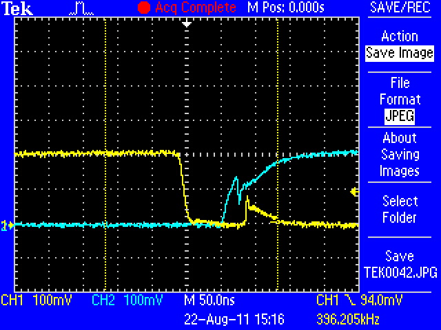

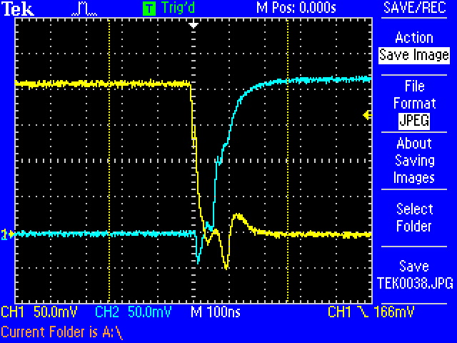

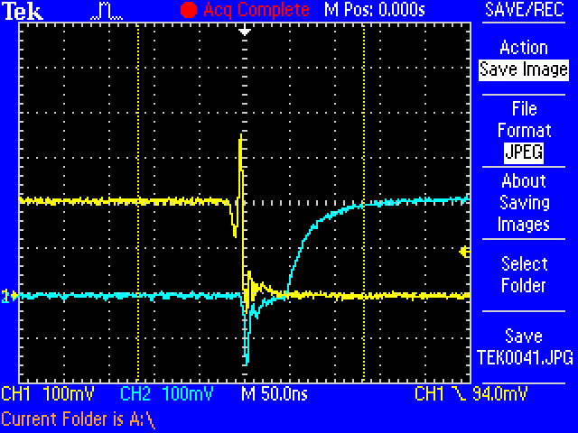

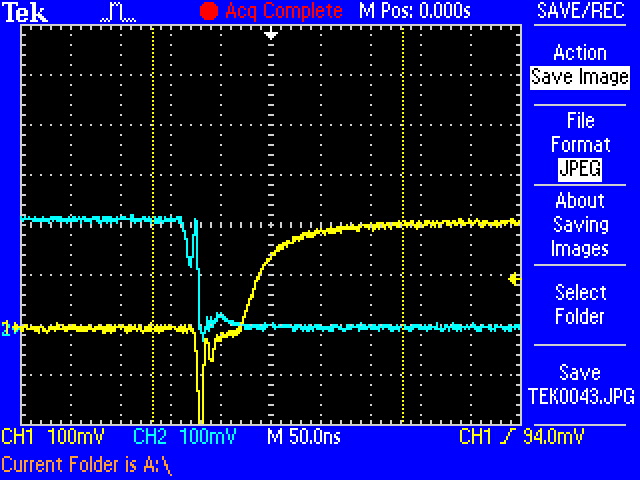

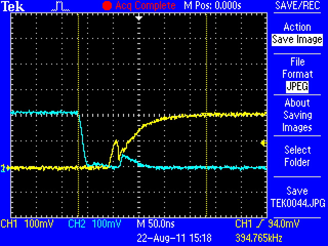

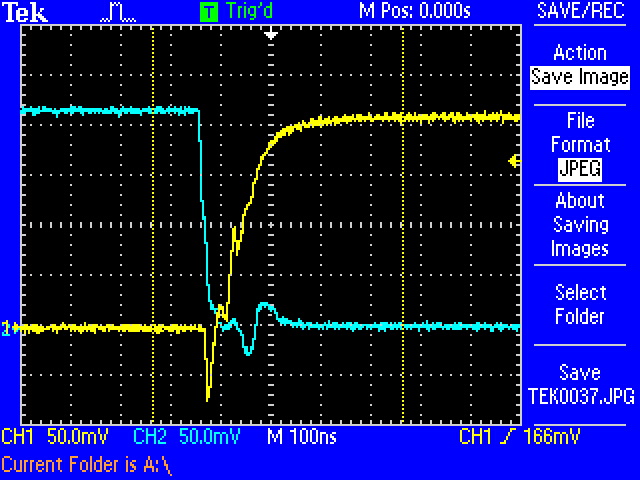

The previous waveforms were perfectly normal (except for the current, which is unexplainable). There is a small sign of turning on again at switched off gates. This is usual, but can cause cross conduction! Harder gate pull down, or increased Cgs may help!
I got the lower gate voltages when the load is resistive or inductive.
when it is loaded resistively small voltage spikes seen on both gate voltage.
but when it is loaded inductively the spikes too high!
Is that normal the gate voltage having high spikes with inductive load?
A little spike is expected but this much more than expected. Also as you can see the behavior is not the same although at the same edges of the signals!?

Cgd injects charge to gate while Vds is increasing. The opposite impulse also can be seen at negative Vds edge, when it is not caused by the FET itself.What is the reason of that turning on again?

A small capacitor (~330pF) directly at gate to source terminals can tell if that's really miller Cgd problem.
This capacitor slows down di/dt phase but leaves dv/dt basically same fast, and paracitic capacitance divider Cgd/Cgs will hopefully divide enough now to stay below Vgs threshold.
Try it now just for fault tracing
