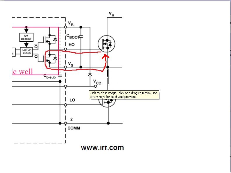

because the FETs heating without the loads already
No wonder: high-side transistor has nowhere to pour out it's gate charge before low-side transistor opens, and this is the shoot-through reason.

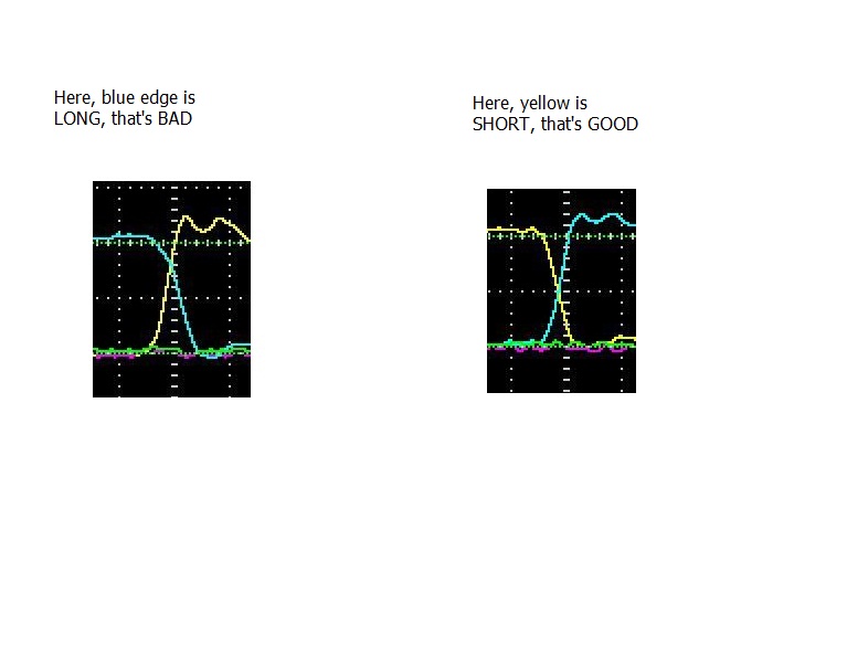

And I would add: You've got BAD input front(s) - as I mentioned in my previous post - make them GOOD.

It is not plain difference that matters, but LONG (bad) rear-edge as itself.
Make it SHORT (good).
correct me if I'm wrong but gate charge of the high side FET can pour out through the fet driver IC it has source and SINK! capability. I dont think this is a shoot through reason. can you explain im more detail..?No wonder: high-side transistor has nowhere to pour out it's gate charge before low-side transistor opens, and this is the shoot-through reason.
forgive me to make you explain everything twice. but I couldn't understand wht do u mean by "LONG","SHORT"..?
Off course. Look at the attachment.
Red line is the sink (or pour-out) way. So, without load, gate charge goes through lower-side transistor.
In Your case, without load, charge has no way to go unless lower-side transistor is opened.
Later, when lower transistor gets opened, higher one is still opened either. What is the concequence? Right, shoothrough.

Unfortunately... But not the deviation, a BAD edge as itself can result in undefuned states in logics followed by driver output's "faultstarts".
the reference of the bootstrap circuit is not ground. So why the current chose the way to gnd? the discharge path according to my knowledge:
