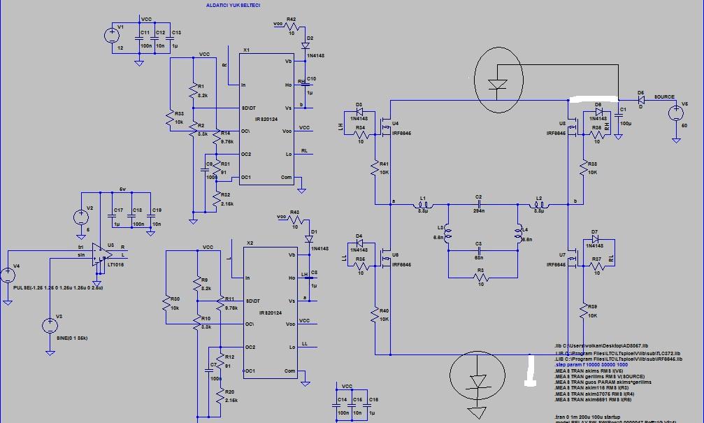

guys...
I tried something today. I cut the reverse current way. as seen in the attached image below. I'm currently testing it in lower frequencies and it seems OK! before putting the diodes at the same conditions the transistors were extremely hot but now it is stable at about 45C degrees..
my question is that, do you see any probable problem or any side affect of this configuration..?
thanks

Well done!
Congratulations, Volkantr!
What frequency and what added diods are in Your design now if it is not a commercial secret, off course?

It is operating about 100KHz now.
I thought diode will be under big stress because of the inductors high voltage.
I use UN5408 diodes, it is the most though,powerful diode I have for now (may be faster and more powerful one can be find).
As I said, I'm currently testing it in low frequencies most likely UN5408 will be inadequate at higher frequencies.. I need faster and powerful one.

This is an extremely confusing experiment.
First of all, as long as now I thought nobody questions the neccessity of reverse current path.
Secondly: the result of the experiment is unexplainable. Not like it were impossible, but we don't know any relevant parameters.
Basicly this circuit is fully wrong. But between some certain circumstances it can operate well. But these circumstances are not appropriate for normal operation.
From a well defined and controllable situation (spice simulation) you're going towards the chaos. I don't want to follow.

The standard recovery 1000V diode in series here is not a diode, it simply won't switch in above 1kHz range.
Putting a zero ohm resistor with some 40 to 80nH series inductance would result the same, actually what's been done is slowing down the switching speed and di/dt.
P.S. Volcantr, you've already experienced two of the major drawbacks of these directfets: high thermal resistance and low inductance.
I would recommend to start prototypes like this with TO220 parts with some heatsinking and internal inductances and swap into directfets only if you are dead sure that you can take advantages of low inductance ultra fast switching and will not exceed the dissipation.

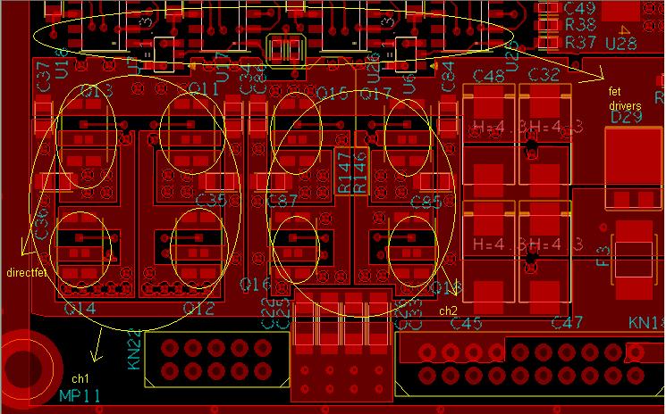

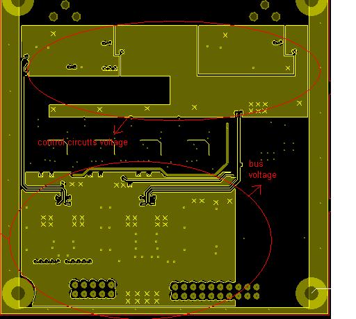

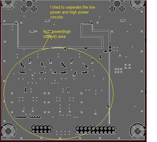

High thermal resistance is not neccessary. As you said also, it depends on the layout, but it seems to be secret...
no! its not secret. it is a 4 layer pcb 73x75 dimensions.
I used seperate ground and VDD layer. I designed that for only the output transistors and fet drivers on it. no modulators. because I'm trying to see which modulator is the best for me so I'm setting up the modulator circuits seperately (I tried only PWM so far).
I also upload schematic file (one of the channels only). I can upload the input and power stages (actually there is nothing) it its needed.
I dont know what to say. I hope the images are clear. I'm here to lighten any dark point.
thanks again..

I tried the ways you offer. As you said, shunt diode harmful at high frequencies because of its capacitance.
Trimming the gate resistors and dead time turn into a trade off, between body diode loss and switching losses..
so it seems only using mosfet itsself with its body diode on and with suitable dead time is the best choice among..
I verified that both in practice and in simulation.
it seems, I must use a heatsink..
Turning on exactly when it's needed requires variable dead time depending on output current! This is why I said it's not easy!
You can verify it only at DC output, and continuously trimmable dead time. Did you do that? And this is not satisfactory condition, just required.
I can't give you more then some random hints, because most of the basic informations about your project are still missing. Freq, supply voltage, filter inductance... and there are no measurements (exept for the temperature, which can not help in analysis), actual waveforms.
And for now my time has also gone.
