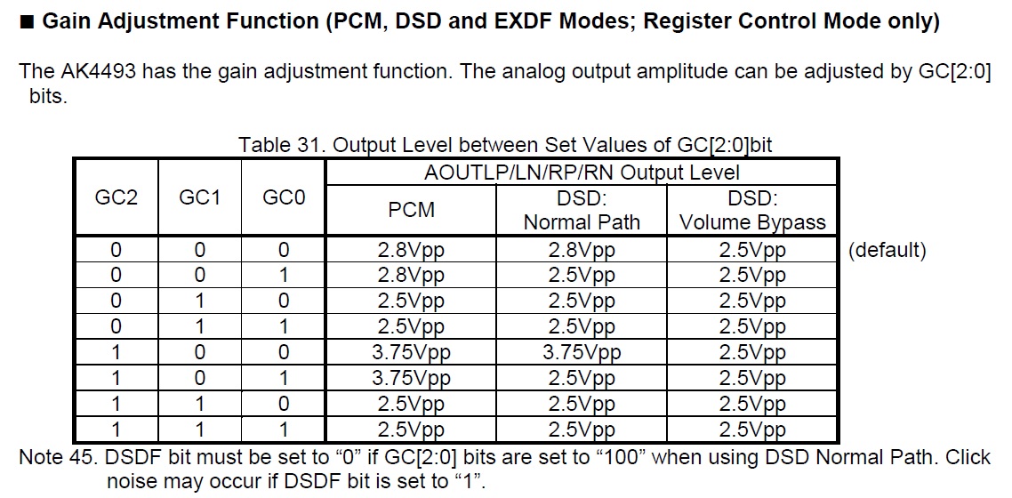

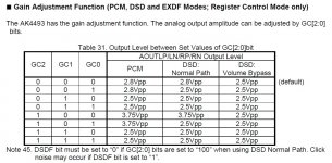

Hello Ivan;
In 4493 there are couple of output voltage/gain options. Is it matters?
Note 14. The analog output voltage with 0dBFS input signal when GC[2:0] bits = “000” is calculated by the following formula:
AOUTL/R (typ. @0dB) = (AOUT+) - (AOUT-) = 2.8Vpp * (VREFHL/R - VREFLL/R)/5.
This expression is equivalent to 5.6Vpp and is differential and irrespective of ground reference or the Vcom bias voltage.
Note 15. The analog output voltage with 0dBFS input signal when GC[2:0] bits = “100” is calculated by the following formula:
AOUTL/R (typ. @0dB) = (AOUT+) - (AOUT-) = 3.75Vpp * (VREFHL/R - VREFLL/R)/5.
This expression is equivalent to 7.5Vpp and is differential and irrespective of ground reference or the Vcom bias voltage.
I use the AK4493 in a few different DAC's I manufacture & it works very well with a 1:1 transformer which Ivan can supply. For the record his transformers sound excellent.
Using the AK4493 in hardware mode a 0dB signal will give you 2v rms out - perfect!
With the chip in software mode you also have higher output level option which gives 2.65v rms out.

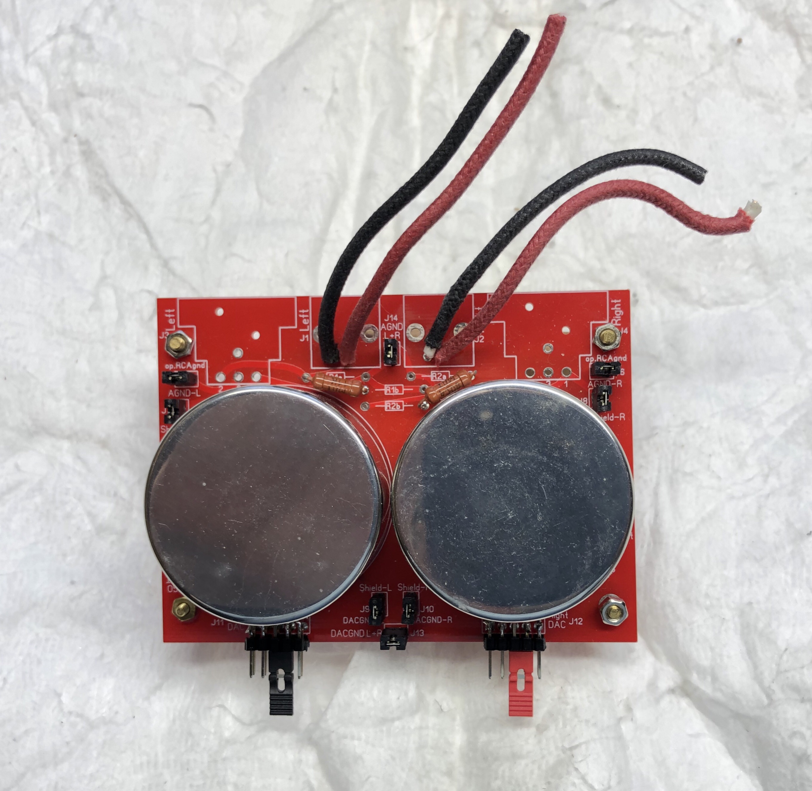

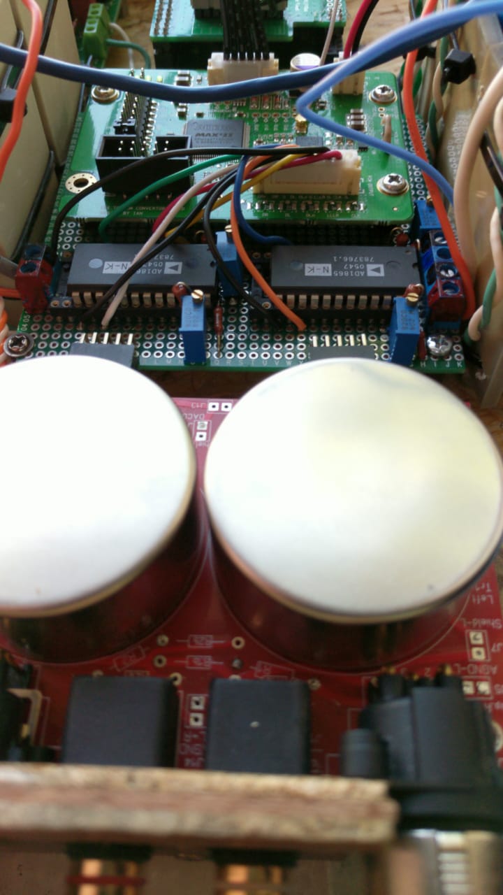

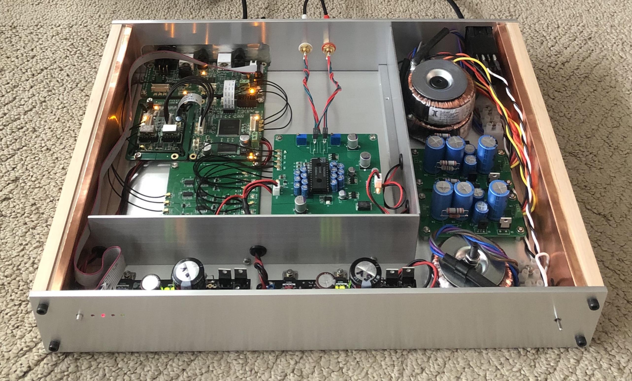

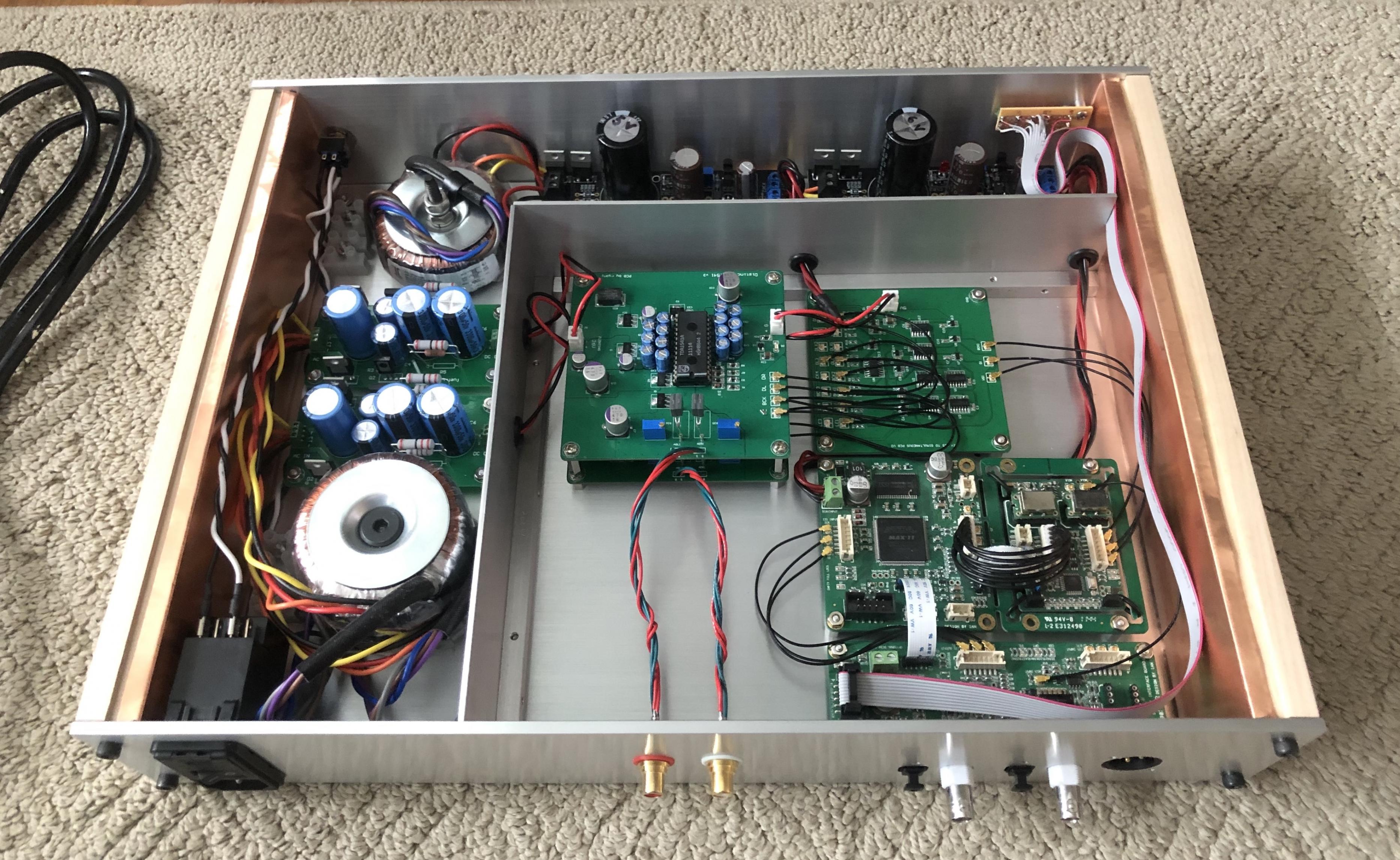

Hi Ivan
I finally have my D3 TDA1541A DAC up and running in my system.
I have two D3 boards with TDA1541A running in dual/mono configuration using only some Caddock MK132 of about 110 Ohms as IV resistors.
It sounds very good, but I was wanting for the possibility of some more gain as one of my efficient horn speakers was recently knocked over and damaged. I have temporarily resorted to using a less sensitive open baffle speaker which I feel might benefit from some more gain.
As I contemplated a build of the CEN IV stage or ordering transformers I noticed Tubo had put his entire D3 project up for sale. I now own the transformers that you made for him.
I have been trying to figure out how to configure the transformers to use with my DAC.
I saw your schematic and related information in post #430.
To be honest, it is over my head. There are some electrical schematics that make sense to me, but I am not an electrical engineer and I simply don’t understand how things should be oriented for my application.
You mentioned that these transformers could be wired in a single ended application like mine to take advantage of differential output without having to worry about nulling the offset from the TDA1541A?
I really need an illustration of some sort showing how the jumpers, connections and any resistors (iv or otherwise) should be installed.
I have attached a picture of the transformers and board as I received them.
I’ve also attached a picture of my DAC so you can see how I currently have the outputs wired.
I was considering wiring the inputs to the transformer board to some RCA plug pigtails so I could just plug the transformers into the RCA output sockets on the back of my DAC as a test.
My IV resistors are mounted in dip sockets which allows me to change them out or even bridge the sockets so that they could be placed before or after the transformers. I was going to experiment with making some of my own wire wound IV resistors.
I am open to your suggestions as to what would be the simplest/best way to arrange things.
Any help you could offer would be greatly appreciated.
Regards
Kevin
