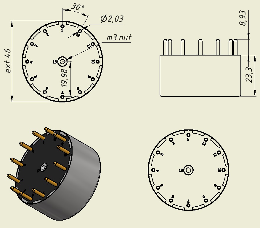

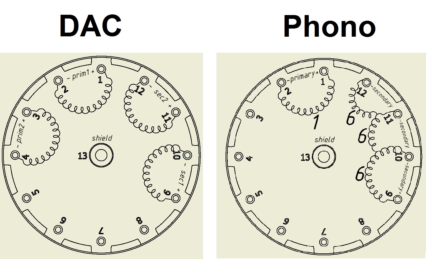

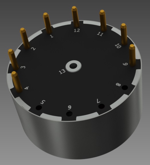

I have updated a little the design of bottom part in my transformers:
Pin 13 is replaced to internal m3 nut. M3 screw can be used for secure placement on the PCB. Plastic screw can be used if galvanical connection of the shileding is not needed. The safe maximum M3 screw length inside the transformer can be 6 mm.
All the pins are longer now for ~4mm and a bit thicker (was 1.96mm, 2.03mm now). Pin allocation remains the same.
zip-file: CAD, drawing and gerber files (PCB was made in Sprint LAyout 6, Circuit in Splan7)

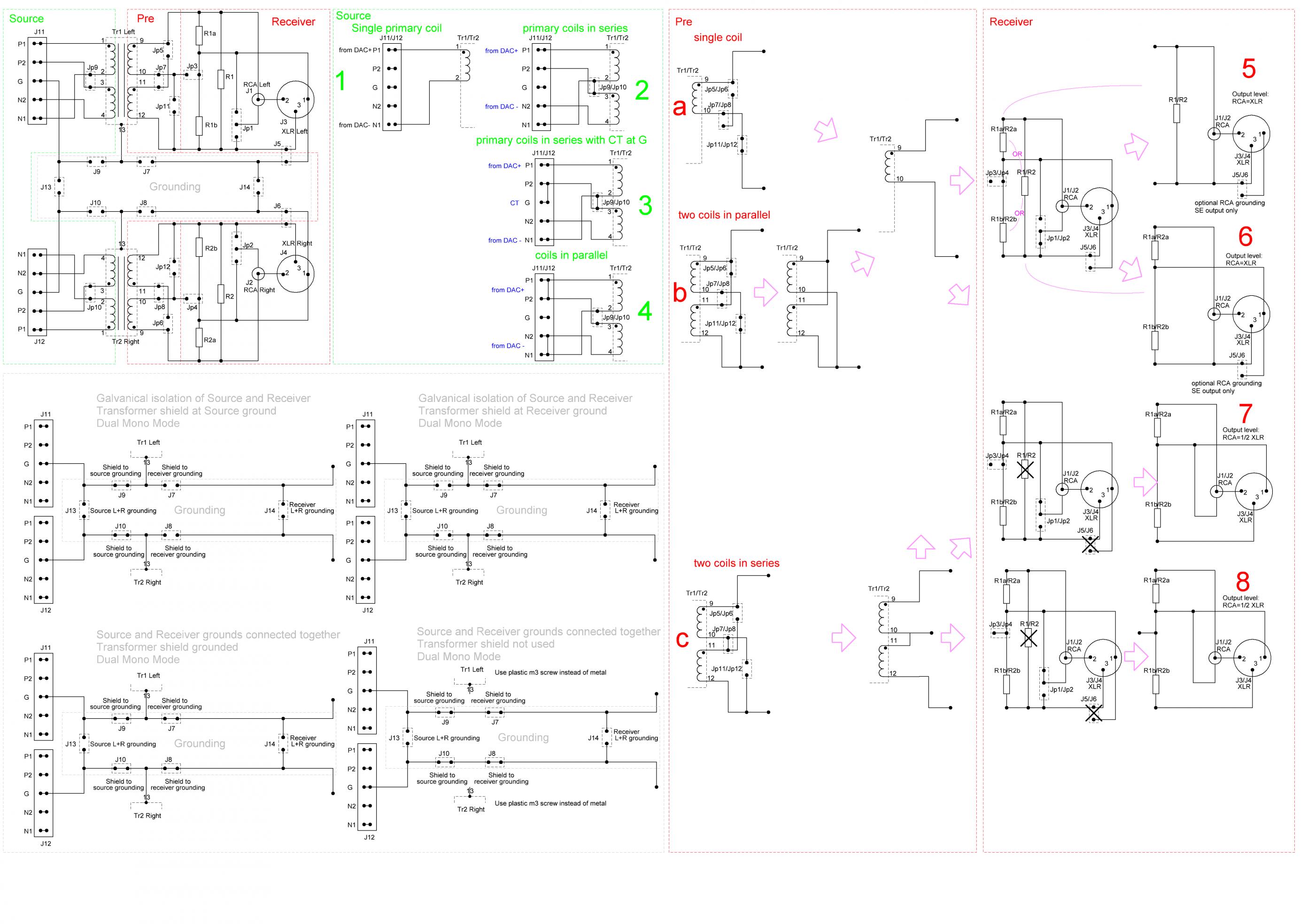

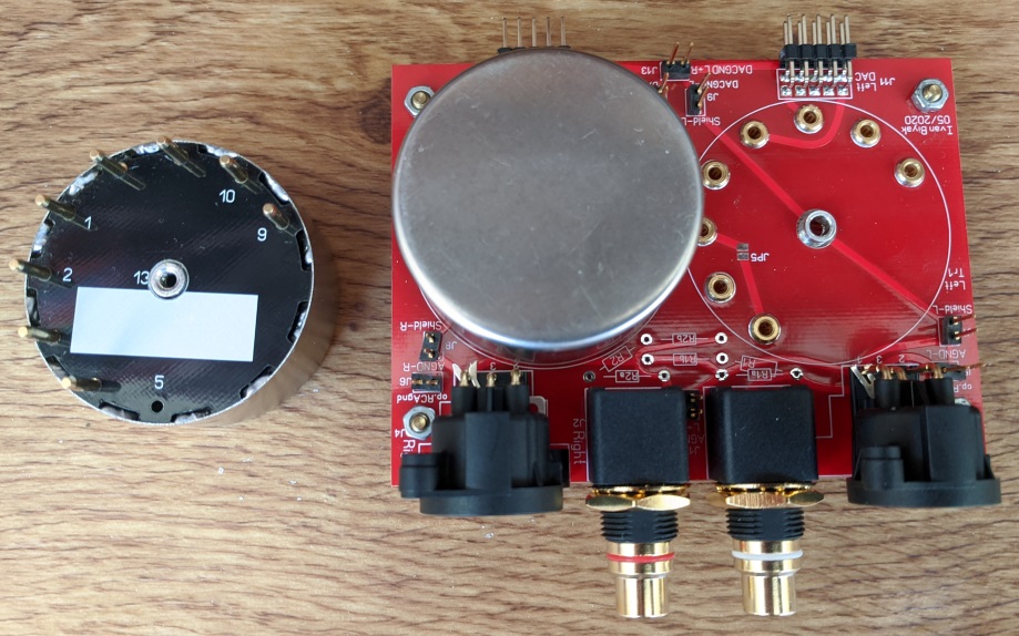

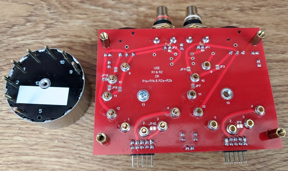

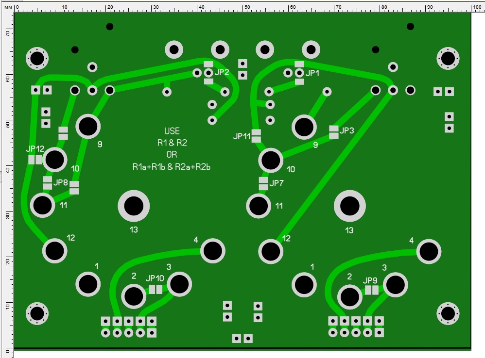

Another update. I have made another universal printed circuit board. Thanks too a banch of jumpers it is possible to use different number of primary and secondary coils, and various circuit connection are available: paralleled, in serial, diff\balanced, SE.

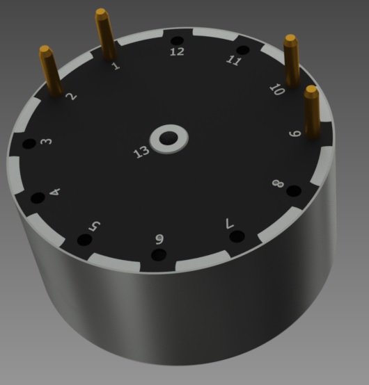

Update.
Another step-up version of transformer have been developed.
Turns ratio: 1:6+6+6 (1:6 or 1:12 or 1:18)
Frequency response (source 40 ohm, 10 K ohm load, 1:18):
-3dB points: 2Hz & 115kHz
-1dB points: 3Hz & 75kHz
Application: impedance matching for moving coil phono cartridges

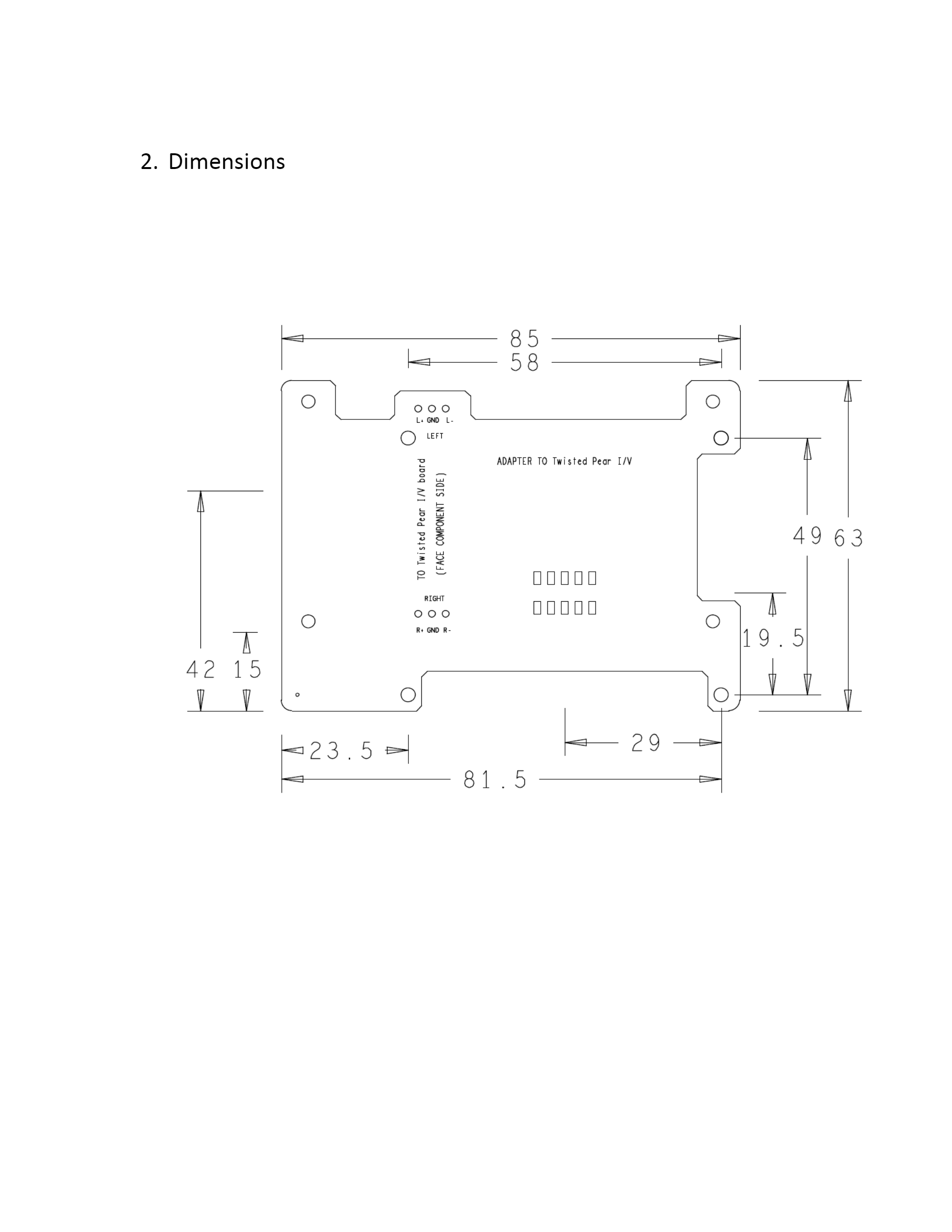

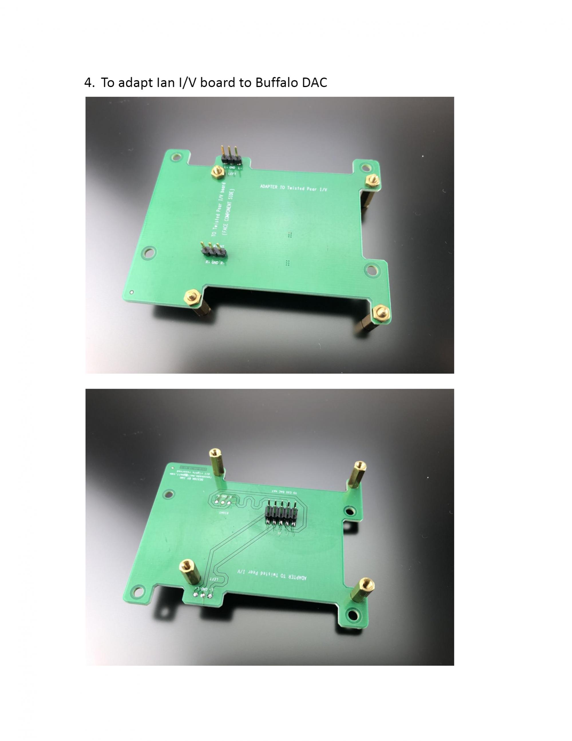

I mean an IV PCB that can be used with the Buffalo-IIIsePro38, such as the PCB designed by Ian.
In fact, you only need to follow Ian's design to increase your transformer installation position. It can be applied to both Buffalo and Ian's DAC. You don't need to design two boards.
Nice upgrade, bisesik!
Very useful pdf schematics.
The female pins accepting are the same as before or they are differente?
