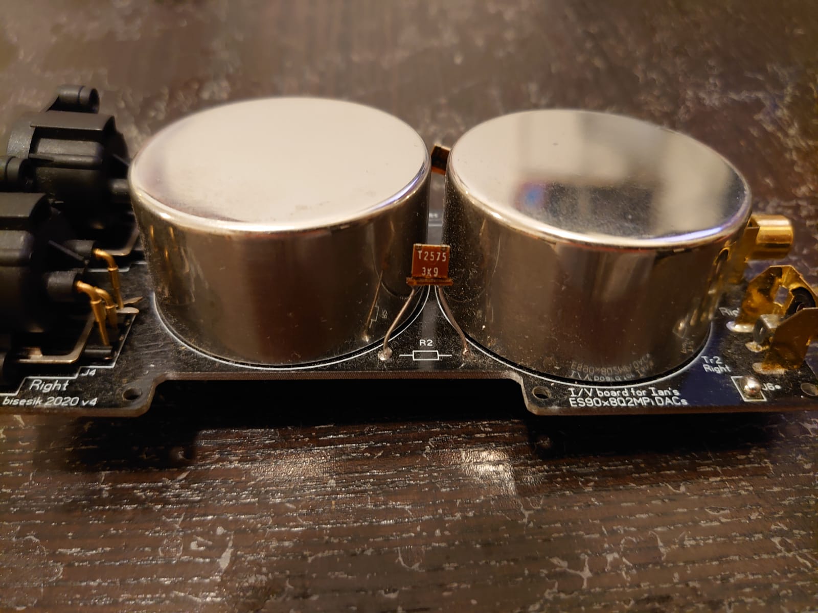

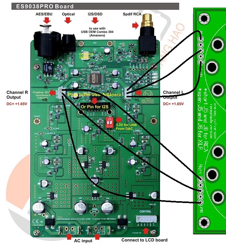

For the newly designed PCB, can you draw a picture similar to the one below for beginners?
Rows in 2x5 headers are connected in parallel (just for better header fixation on the board). All the other jumpers are pre-installed for correct functioning.

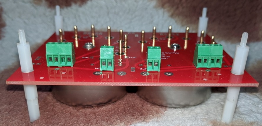

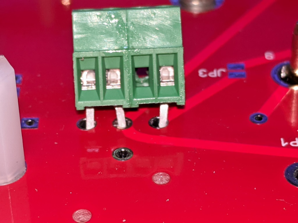

Regarding terminals. I suppose it is possible to use terminals instead of XLRs\RCAs using existing thruhole pads, somehow this way:
based on that terminals:
Blocked
But definitely it is possible to correct PCB for regular terminals at require in the next orders (will take extra time of course for manufacturing).

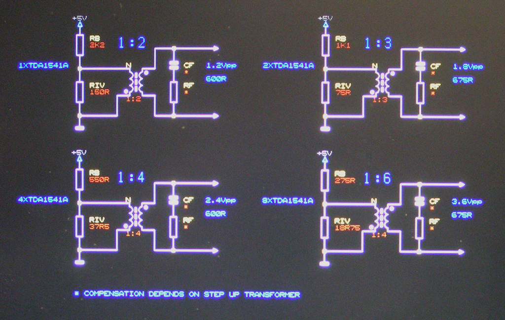

I am working on a TDA1541A DAC based on Ryan’s D3 boards.
The first version is a single D3/TDA1541A. I will simply be trying it with a iv resistor to see how it works with my system. However, I’ve already put things in motion to try dual/mono TDA1541A in the future.
Ryan already purchased a set of your transformers for use with his boards and gave a good review.
If I want/need a pair of your iv transformers...do they have to be wound specifically for either a single TDA1541A or the dual/mono?...or is it possible to use the same transformers with either arrangement?
Also, can you post the dimensions of your current PCB for the transformers so I can make sure I have space allotted in my case?
chromenuts, Myint67
There is a problem with TDA1541 in original SE connection mode is caused by the DC-offset presented at the output. I can make suitable transformer in general, but the special type of the core is needed then, which I haven't now (and do not want to order a batch due to low demand compared to other non-DC-offsetted DACs). There is another way to solve the offset, to make the additional compensation coil. First, it is more expensive to manufacture, but it is more complicated for the end user in addition as the separate power source will be needed.
Taking into account all aboved, I prefer to avoid DC-offsetted DACs. But the differential mode of 1541' connection allows to use my transformers in a regular way - all you need is just to use center tap at GND (two primary coils) - two DC-offsets should be selfcompensated then and cores will not be oversaturated.
Lets wait for Ryan's report (transformers are still on the way to him)...
chrome nuts, Myint 67...
Thanks to your posts, I have renewed my "investigation" on the TDA1541A (which is inside my Marantz CD65 CDP), which was paused during the last 2 years many times in attempts to find the needed approach of winding. As a result just today I have found the way to make transformers, suitable for TDA1541 in SE mode without need of DC-compensation.
FR 20-20k: -0.3 / -0.8 dB (1.8Vp-p)
