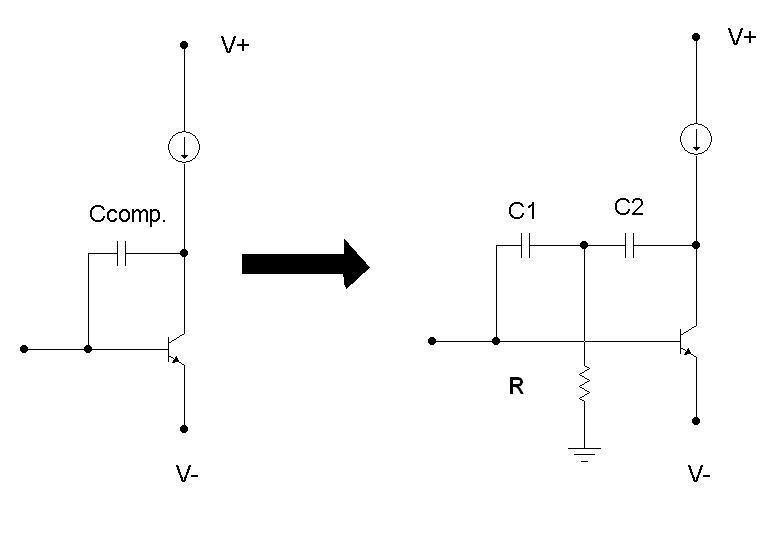

the figure below represents a typical transadmittance stage with first single-pole miller compensation, and then two-pole compensation.
..if the two are to give the same Wt, and hence identical maximum slew rate, then:
C1//C2=Ccomp.
where,
C2>C1
By the way, the location of the zero restoring single-pole roll-off is straightfowardly given by:
Fz=1/{2*pi*(C1//C2)R}
The two pole network reduces the current demands on the first stage below the zero by more than an order of magnitude compared to ordinary miller comp.
This causes a drastic reduction in so-called slew induced distortion for the same maximal slew....
....which indicates that you need not have a vast maximal slew in order to have low gm input stage nonlinearity in the audio band......

...Therefore Andy...
........your summery is only valid for the single pole compensation, and then only if your compensation capacitor has to swing relatively large voltages.....say,...>>50V peak to peak.

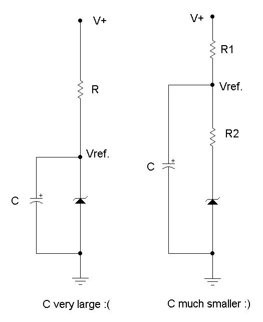

Basic electronics
Yeah great - we can use a smaller C by degrading the LF impedance of the reference dramatically. Not much cop as a DC reference now, unless feeding a high impedance input.
I guess this never matters
Re: Basic electronics
The idea that an appreciable reduction in DC resistance accrues by merely capacitively shunting the zener is illusory.
.....think Giga farads...🙂
ALW said:Yeah great - we can use a smaller C by degrading the LF impedance of the reference dramatically. Not much cop as a DC reference now.
I guess this doesn't matter![]()
I don't get it
I never said it was, but you've raised it by the value of R2.
think ohms law...
think ohms law...

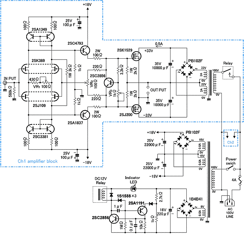

mikek said:........nother thought provoking example of an output stage with gain....complementary common-source, (from japan):
P.S: The driver bJT's, (2sc4793/2sa1837), are excellent!![]()

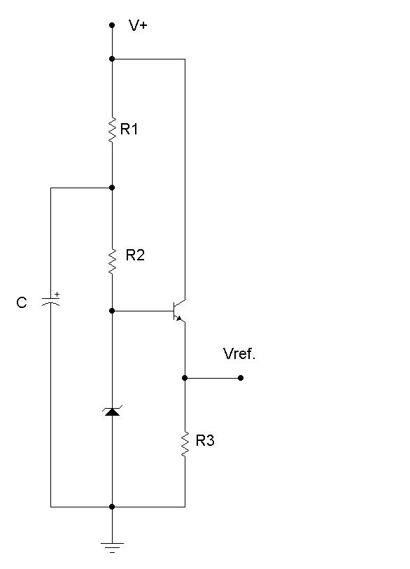

Ahhh...i see what you mean........ there is an error in the second figure...Vref. should be across the zener diode, and not the zener+R2...apologies for any inconvenience caused....🙁
....However, C cannot be used to lower the DC output resistance of the reference.....
infact this can never be achieved by merely capacitively shunting the zener.....
...the idea is to improve the regulation of the voltage drop across the zener by diminishing power supply ripple in the current established by the resistors R, in the first figure, and R1, R2 in the second, where it can be assumed that R=(R1+R2)
Connecting C directly across the zener as in the first figure, is sub-optimal, as a commensurately larger component would then be required for the same time constant.
Should you feel an overwhelming compulsion to lower the zeners output resistance, then something along these lines is recommended:
