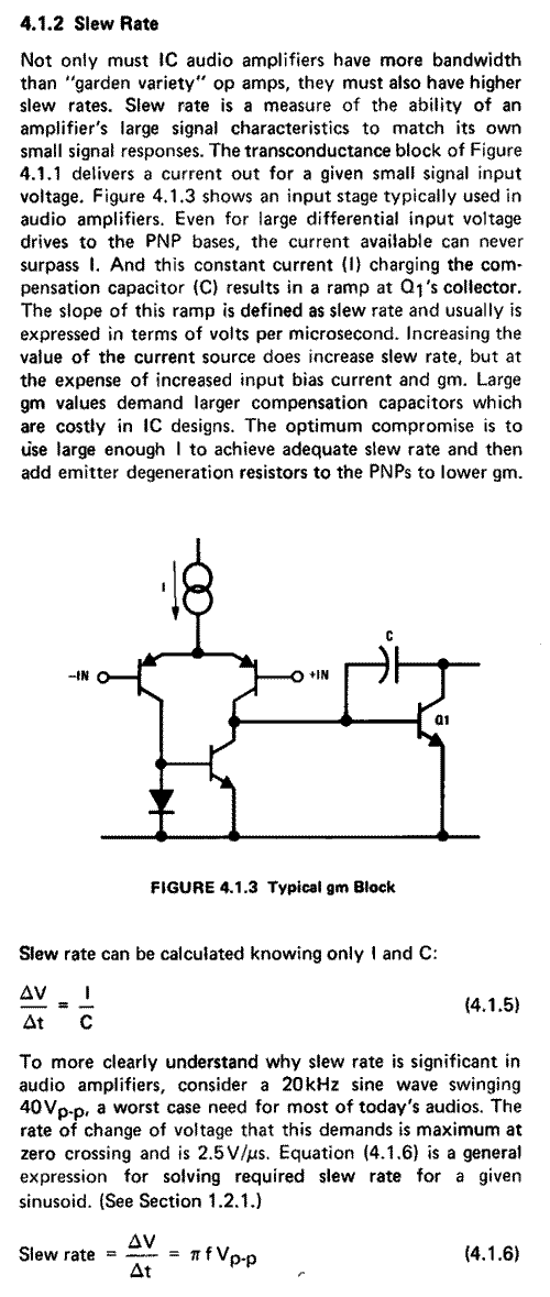

Jocko Homo said:....Amps with gain in the output stage are a pain to stabilize. And most people know better than to make one....Jocko [/B]
It is not provocation, bub........
Prof. Leach wrote a JAES article in the early 80s or so explaining how to size the input degeneration. Right after that, the egghead Ph. D.s from "down under"savaged him. Don't believe me??? Go look it up.
No, you do not increase increase offset by degenerating. And the noise of a system is determined by the first stage, and unless the subsequent stage has gross noise, it will not increase the noise figure.
Go read National Semiconductors explanation of slew rate enhancement with degeneration.

Your knowledge of practical electronics is truly lamentable...🙄....your degeneration resistors are unlikely to be matched to better than 1% in reality...therefore....the larger they are, the greater the imbalance...an imbalance which is expressed in increased DC output offset...🙄...
As for noise.....get off the juice...or whatever you're on...😀....of course first stage noise predominates...where are these degeneration resistors located...?....the input stage...🙄...
Truly lamentable!.....degeneration does not of itself increase slew rate...🙄....Hellllll......Nooooooo!
Such degeneration reduces first stage transconductance, which lowers the open loop gain, and unity gain frequency of your amp....{Ft=gm/(2*pi*Ccomp.)}...slew rate is only increased if you take advantage of this reduction in overall open-loop gain by reducing the size of your compensation capacitor to return Ft to its original, (presumably stable), location wihout degeneration. Elementary.

Jocko Homo said:Go read National Semiconductors explanation of slew rate enhancement with degeneration.

Jocko Homo said:This is from the valued "Audio Handbook", put out by National Semiconductor back in '76. Hope it is readable.
Jocko
Hi Jocko,
I have a copy of this very book...😀...have you noticed that their op amp. designs do not provide for an input DC path to ground? just thought....🙂
At any rate the info you scanned is actually incomplete......
....degeneration does not of itself increase slew rate.......
Such degeneration reduces first stage transconductance, which lowers the open loop gain, and unity gain frequency of your amp....{Ft=gm/(2*pi*Ccomp.)}.......
.......slew rate is only increased if you take advantage of this reduction in overall open-loop gain by first increasing the tail curent, and/or reducing the size of your compensation capacitor to return Ft to its original, (presumably stable), location wihout degeneration.
I am sure you'll have no further difficulty this basic material... 🙁
