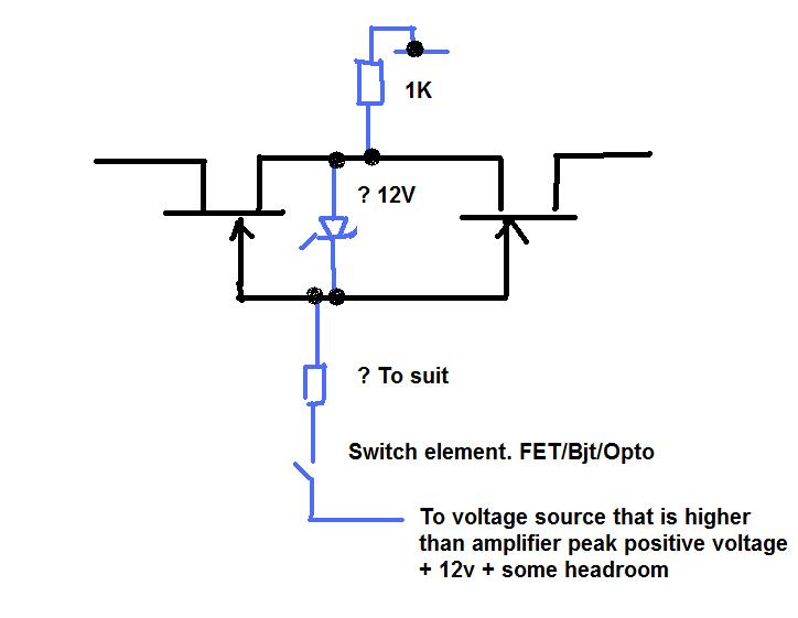

I think it would be difficult to come up with a way to turn the MOSFETs on with a non-isolated voltage source, remember the MOSFETs gates must be made a few volts more positive than the source terminals to turn them on, so the driving circuit will be connected to whatever is being switched, so if one of the drains is at ground, then the common source terminals cannot be grounded. I think in the long run it's just easier to use the optoisolator.

The problem is interrupting high current DC with significant series inductance. This principle is used in arc welders... but doing some math with 5.1mH speaker+xover inductance, a 75VDC/8ohm fault is about 224mJ of avalanche energy for the mosfets.
PVI's have an internal depletion-mode mosfet (IRF AN1017) to speed up switch off times, PVI5013 is 0.25msec@200pF and the Avago ASSR-V622 seems much faster: 0.03msec@1000pF (I'm not sure why the LED current spec is not zero).
Low Rds on mosfets have high capacitance and I would expect them to take longer to switch off under avalanche due to Ciss.
The IRFS3607 is rated for 120mJ avalanche over 0.04msec single-pulse, so more than one is needed but with Ciss=3,072pF each I think they would get beat up during a fault due to slow switch-off times.
Firstly let me just say the photovoltaic method seems ideal... but I wondered about this.
It's the same FET arrangement but drive for the FET's is from a fixed voltage source derived from say a doubler off the PSU. The current could be in the milliamp or less range so easy to implement.
The FET has Vgs limited to whatever the zener is chosen to be.
The 1k (not even sure it's needed) is to allow the switch to initially close. I think if a load were connected it wouldn't be needed as the zener current would flow either into the amp or load via the internal diodes in the FET's
The drive for the FET comes from a source higher than the max output of the amp plus the zener volts. So no matter what the output of the amp is (- rail or + rail), the drive voltage is significantly higher and the FET's are always on. Maybe a constant current diode rather than a resistor would be better. Also a high value resistor across the zener to define an "off" condition i.e. never floating. The zener hold Vgs constant.
Any thoughts... 🙂 Would it work ?

Maybe... 🙂
I think many want a SS relay that will physically fit where the original is though with no PCB redesign work. That's the beauty of the photovoltaic design. You can make a drop in replacement.
Mines a bit more complex to implement (if it works), but could retain the original relay placement.
