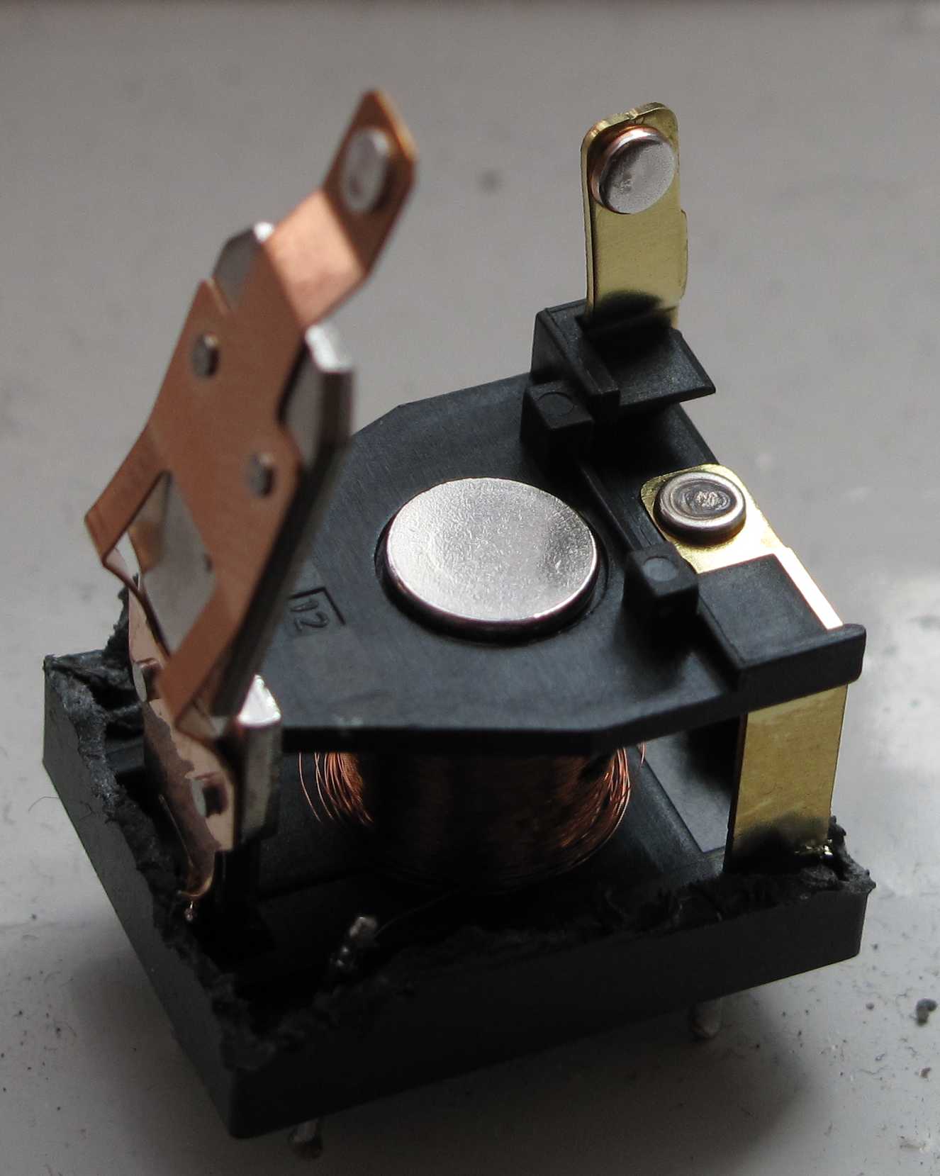

Seems like I wasn't alone in having issues with relays! It's nice too that there's an easy and pleasing way to solve this. It makes sense that a high RDSon FET would create non-linear distortion. If the FETs effective resistance is going to change as the sinusoidal voltage changes, then that would obviously give rise to mechanism that would create distortion. It's good to see that using low RDSon FETs completely renders this insignificant.
These were the cheapest OMRON relays I could find that fit the application. As they were sealed and contained the same contact material I figured they'd be pretty much the same as any other similar spec'd relay, little did I know that the switching action can be quite different from one to the other.
I popped the lid off one of the offending relays and indeed no sweeping action to be found. What surprised me was the state that the relay contacts were in, black with a layer of something that quite obviously doesn't conduct well! In comparison the contacts that should only pass current during a failure were clean as a whistle.
Have a relay.
Here I've bent the relay contacts out of shape but the way it works is quite simple. The signal enters the large arm on the left and then the relay action moves the arm up and down between the two contacts on the right.

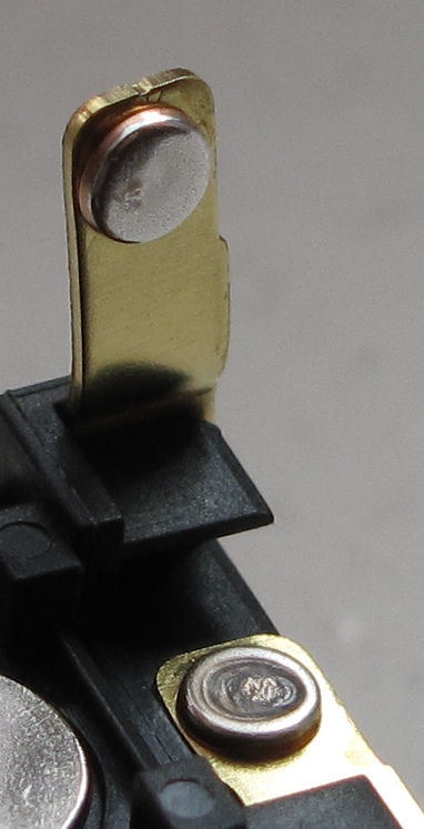

Have a close-up of the contacts.
As you can see the upper contact is clean, whereas the bottom one... it's not a surprise that the relay was acting up, with the amplifier giving gross amounts of distortion.
What surprises me is how quickly this happened. I tended not to turn the amplifier on with a signal going through it and I also don't listen at particularly loud levels. The other part is that the system is entirely active so any crazy reactive loads, as created by a crossover wouldn't be present either. The most reactive part of a un-cross-overed loudspeaker is what happens at resonance too and I've always actively crossed over way before that, so perhaps the degradation could have happened a lot faster given different circumstances. I don't think I'll bother with mechanical relays again.
When relay contacts make, they do so with a wiping action. If they just close without a proper wiping action, they behave like this.

I'm no real expert on properties of relays but seem to remember reading about this blackening of contacts being caused by atmospheric polution reacting with the contact plating and causing oxidation. In the same way that silver tarnishes. But yours is only one of the contacts... maybe as the film appears some "electrolytic" action occurs as a minute voltage is developed across the closed contacts. Just guessing there.
Again like you, I never turn my amp on with music playing and never turn off either with it playing.

Mine were sold as fully sealed and would switch a nominal 10A AC load. As can be seen the unused contacts were clean so I don't think standard corrosion was an issue.
