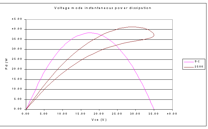

Load line
At last made some time to address the load line issue under reactive impedance. Attached is a PDF with the derivation, and in the next post a simple spreadsheet to plot results both for current mode drive and for voltage drive.
Feel free to mercilesly point mistakes and observations😀 .

Re: Load line
I think you'll find your Ic Vs Vce plots are in significant error....
Instanteneous device dissipation will have either two maxima, or one maximum and one point of inflection depending on phase shift between Ic and Vce....(BJTs assumed)...
With a reactive load, the device is expected to deliver substantial current at high Vce....Your characteristics contradict this....

Re: Re: Load line
Thanks for taking the trouble to provide feedback Mikeks.
I was puzzled by your comments. Both in the current mode and voltage mode drive, the posted graphs show significant current at peak voltage. To make it clearer I included for the voltage mode case, power dissipation graphs for the DC and 2500 Hz situations, where the contrast is obvious as shown in attached clip.
On the other hand I had previously checked and found a mistake in equation [4], the sign for the sum within square brackets should be + instead of -, but it does not change significantly the overall graphs shape.
