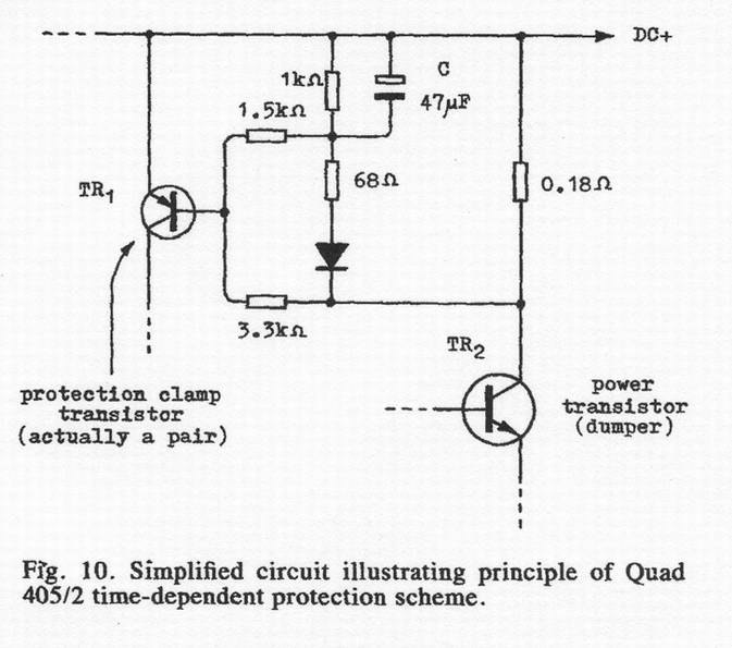

Can you, please, point to few schematics with short circuit protection realizations which may be called as "good from mikeks's 🙂 point of view"?
anli said:
mikeks,
As i have just stated, plain short-circuit protection is 'not good'....
I don't mean plain (current limiting, for example) protrctions. But the problem exists, and, I hope, concrete (indirect) decisions (with schematics) exist too 🙂mikeks said:As i have just stated, plain short-circuit protection is 'not good'....

... as an example:
Jan Didden
Edit: I'm not sure this meets Mikeks approval, although I guess he would give an imperceptible nod..😉
Jan, thanks!janneman said:... as an example
And what about trigger output short circuit protection? Are there known well-proved decisions here?
