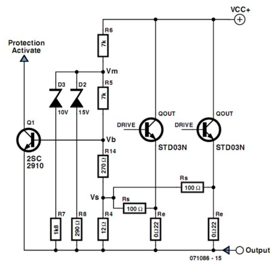

Output protection
It should be pointed out that a very simple supply discharge circuit may be made with only a very few parts.
If you use an SBS it will turn on two triacs, one for the positive supply, and one for the negative supply, with a single trigger part (the SBS). It can do this better than an SCR as the triac will trigger with either polarity signal at the gate in all four quadrants of operation.
So with the SBS you only need a resistor and a cap as the DC integrator, a series current limiter resistor feeding the SBS, and two triacs, that's it.
The intergrator cap will charge up to the firing voltage of the SBS, the SBS will go to a low voltage state, and the cap will discharge into the gates of the triacs, the series resistor will protect the gates from excessive gate current. The cap is usually around 10µF, the resistor forming the integrator is usually set to allow full power operation down to 8hz~10hz, and the series limiting resistor to the maximum gate current of the triacs. Because the 10µF cap can dump a pulse of several amps (when the SBS switches states), any triac may be used, you don't need a sensitive gate model.
Other than the triacs, only four parts required.

you asked about protection for the output stage and presumably also the speaker load.
The only reference in your last reply to protection is that you repeat you are not using fuses.
Anything else you want to add?
AndrewT, I'm interested in how to protect the amplifier. I cited data on supply, transistors ... My main concern is to protect the output transistor. I do not know whether to look at the graph of 100mS SOA at Tc = 75degC or SOA DC Tc = 75degC, which graph should look? When to get an answer then I will know if amplifier can work at 4ohm in all condition off phase angle. Looks like he can not

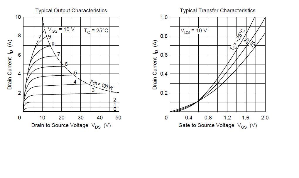

I looked at datasheet. Here's a picture. Sorry but English is not my native language. I do not know to which current limiting zener diode. I do not know what you're trying to say but does that mean that these output transistors do not need external current protection?
As i said before, Fischer SK47 150mm, around 0.56K/W.
Tc around 75degC max.

yes,
look at where Vgs=7Volts goes.
Id starts very low when Vds is very low.
Id rises rapidly to ~5A as Vds goes towards 5Vds
Id then flattens off to just under 6A as Vds reaches 17Vds.
Looking at the slope of the Id vs Vds curves one can see that the maximum current that the FET can ever pass with Vgs=7V is <7A.
This means that if the Vgs is limited to 7V then the maximum current that can pass the FET is <7A.
There is your current limiting in event of a short circuit. = protection.
Now look at what happens if Vds is >17Vds and Vgs is limited to 7Vgs. The power dissipated is over 100W. The FET needs further protection in the medium term otherwise it will burn out. Fit supply rail fuses after the smoothing caps.
The Vgs can be limited with a Zener. But it also has a diode in series. The diode drops ~0.7V so a Zener ~6.3V will limit the maximum short circuit current to <7A
Now to temperature de-rated SOAR.
For Tc=25degC the Derating Factor (DF) is 1.
@ Tc=75degC the DF= [Tjmax - Tcoperating] / [Tjmax - 25degC] = [150-75]/[150-25] = 0.6
This tells us that the 100W FET must be de-rated to 60W and all the curves shown in the SOA must have the current reduced to 0.6*plotted current.
At 48V the FETs can pass 100W/48V * 0.6DF = 1.25A
A pair of parallel FETs can pass 2.5A when Vds=48V and Tc=75degC.
Similarly when driving a resistive load of 4r0 to 40Vpk, the Vds ~7V.
Now the FET can pass 100W/7V =14A. No, it is limited to 7Apk, a pair of FETs can pass 14*0.6 = 8.4Apk when Vds is <=14.3Vds (total dissipation is 120W split between two FETs).
Let's go back to
"At 48V the FETs can pass 100W/48V * 0.6DF = 1.25A."
This is a DC or continuous rating if one can keep Tc<=75degC (heatsink ~<65degC)
For a 100ms transient pulse (that happens once with time before the next single pulse to cool down) the pair of FET can pass 200W /48 * 0.6 * 2 = 5Apk That's the maximum current that a reactive load that lasts for 100ms can demand from the pair of FETs.
If the 10ms SOA is use then a fast 10ms transient can allow up to 7Apk demand into a very reactive load.
All this is in the datasheet, but it takes quite a bit of arithmetic to find all the limits that you might need.
That's why I adopted Bensen's SOAR spreadsheet.

Thanks for the explanation. Nice you wrote, if Vds> 17V DC and Vgs = 7V power dissipation is over 100W and transistor needs extra protection.Reading books, fuses negatively affect the performance of amplifiers and that fuses are not quick enough to react.Is it smarter to put overcurrent protection instead of fuses? In any case I have upc1237 or other protection, so I think not to put fuses but the overcurrent protection react to rescue transistors.
I said Use the Zener as the current limiter. This is the short term protection.
eg. when the output is flashed with a short for a few ten's of milliseconds.
The Zener prevents extremely high currents passing through the FET if you select the Zener voltage appropriately.
