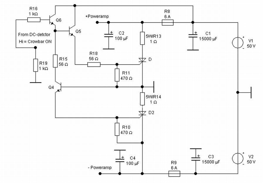

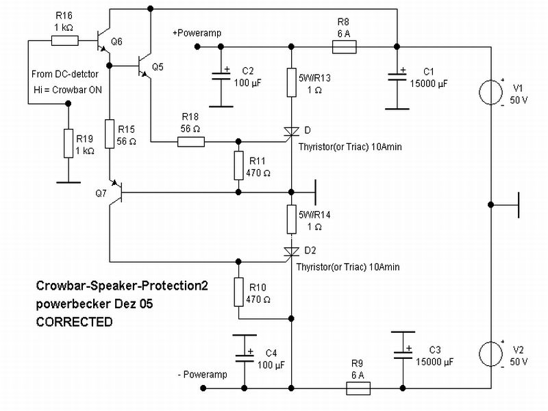

Hi to all!
This thread shall never ending.😉
So back to the beginning : the search for a speaker-protection, when the amp fails and try to kill the speaker with high DC-output.
The question seems not to be the actual DC-detector but
which is the best way to take away the DC -voltage from output.
I always prefers a kind of crowbar.
I have for this 2 propositions.
The first use 2 thyristors (or triacs) which shutdown both supplyrails after the supply-fuses to ground at the same time.
Thyristors are cheap and robust and can carry high peakcurrents.
Neverless this it will be good practice to limit the current with a small resistor in serie which should be also very robust.
One example for this kind I show in the attachment.
There is also a simpel circuit, but the steering-part is not tested!
Regards
Heinz!

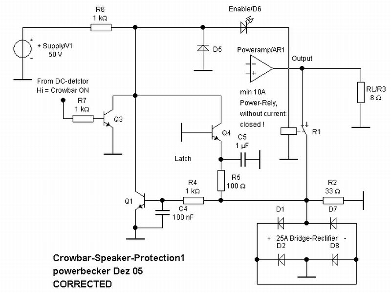

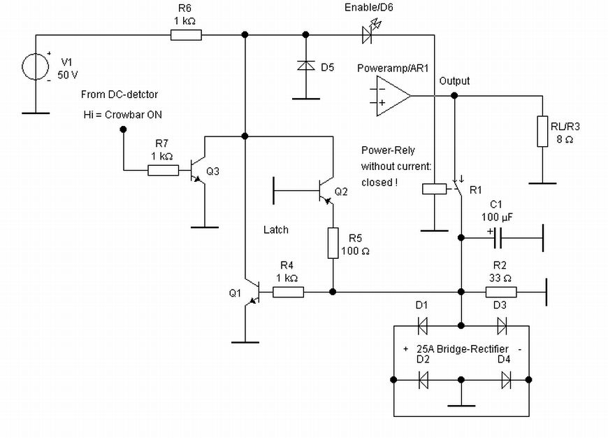

Hi
The second crowbar works with a strong relais which shut down the output without current in his coil.
The shutdown is not direct to ground because there are some diodes in serie. So a shortcut for the amp-offsetvoltage is avoided. As the thyristor-circuit 😉 it also latches.
The 4 diodes one can get simply from a big (25A) bridge-rectifier.
In the attachment the circuit, also not tested!
Regards
Heinz!

Hi Power,
protection2 shows a pair of crowbars. What Triac do you recommend?
Protection 1. How does it operate? What does the bridge rectifier do?
The bridge is drawn wrong.
Correctly hooked up it will give two diode drops in either direction.
AndrewT said:Hi Power,
Hi Andrew
1. the biggest You can get cheap!😀
TIC 263D : 400V 25A 2,10€
TYN416 : 400V 16A 0,90€
2.
all is Ok :The relay gets current from R6 , contact is open.
The amp fails : the detector-circuit put a H to R7 and Q3 takes the current from relais : output is now switched to D1/3.
So outputvoltage is max +/- 2V and a big current flow through
the bridge.
Voltage on R2 (+/-2V) switch, dependend of polarity either
Q1 or Q2 on.
So for the case that Q3 is already off the relaiscoil don`t get current and held the outputvoltage down till You switch off the whole amp or the DC disappears.
A benefit can also be that the normal working amp never "sees"
a direkt short-cut, also the relais gets from one reason no current.
Regards
Heinz!
djk said:The bridge is drawn wrong.
Thank You I see it!
Hi Heinz,
Using the right polarity for the transistors make the circuits easier to understand 😉
In your thyristor circuit, I think Q4 should be PNP and collector/emitter reversed. Furthermore R15 and R18 seems to me to have a too low value for up to 50V gate drive. Well, it depends on how high is high for the DC detector.
In the relay circuit, I think Q2 should be NPN if you want to switch it on by a negative voltage (-2V) on its emitter. Maybe use a bipolar cap for C1; you never know what the polarity will be. Or put it somewhere else in the circuit.
Steven
Steven
Hi Steven,
thank You! Sorry I was tired.
snip
How true!

In your thyristor circuit, I think Q4 should be PNP and collector/emitter reversed. Furthermore R15 and R18 seems to me to have a too low value for up to 50V gate drive. Well, it depends on how high is high for the DC detector.....
and also from the necessary current for shure switching the thyristor/triacs.
I have done a correction
Regards
Heinz

Steven:
Steven, also right!
Thank You
Heinz!
