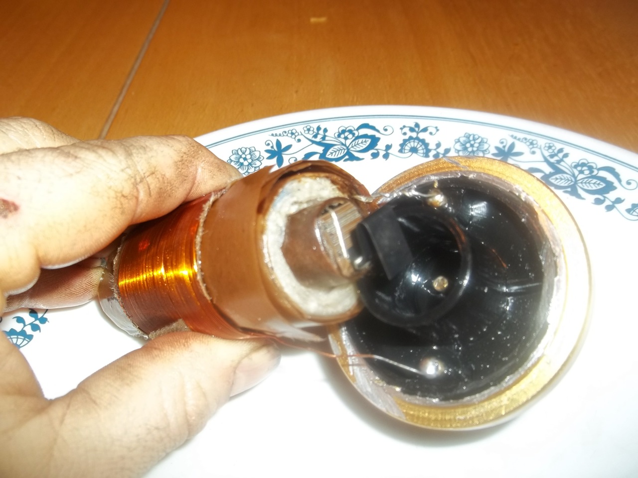

Decades ago, I took the coil/core assy out of a standard car ignition coil.Yes, getting anywhere near a speaker cabinet increases the field intensity a Lot. I watch the meter dancing to the music beats.... Largest peak levels are with bass (highest current), of course. Behind the equipment where there are a bunch of wires... ac power, signal lines, speaker and digital is going to be interesting.
I built a portable amplifier box with meter, speaker, and headphone out.
The coil was mounted in a length of pvc pipe and connected via length of coax.
This made a really good tool for sniffing out radiated aether disturbances, and taking a listen to these disturbances....much better than just a meter display.
This setup was sensitive enough to pick up the driver pole pieces radiations from the seated listening position 😱.
Interestingly the magnetic signal sounded better than the acoustic signal, and seemed to arrive earlier.
I feel that focusing the drivers directly at the listener does more than just focussing the acoustic output.
Sensitive enough to pick up electric rail pantograph supply lines variations from 80m away also 😱😱.
The 'throttle' being applied by the driver was perfectly audible.
I could monitor the station arrival and departure times and compare to the published timetable.
The modern world is full of these kinds of aether disturbances.
Living as I do in the northern most parts of Perth, I have ample opportunity to spend time in radio/ac power 'quiet' places, and note the difference.
I should build an updated version....it would be re-educational and fun.
Alarming too probably, to acoustically listen to the junk magnetic disturbances throughout the modern home/workplace/test bench.
Switch mode supplies would be worth a close listen and correlate to acoustic damages in audio gear.
Cassette tape heads make a useful pickup coil....it's interesting to listen to the internal currents of an amplifier stage.

I also live most of the time in remote area where it is rather quiet in all respects. No noise coming in on the ac utility lines but plenty of noise generated within the home... more so now with digital and smps in many items used.
Your idea to use a cassette tape head is a good one. I have used a VCR tape head for wider bandwidth pickup. Epoxied to a BNC allows a cable to be attached to it and other end to test equipment (spectrum analyzer). It is how and why I developed ac line filters for everything. In this case of learning about the amp/spkr interface, the 'probe' is small enough to get inside the amp without direct contact and see how effective shielding, Common-Mode and Diff-Mode coils and RC filters on the OPS effectiveness can be.
Pls go ahead and try it again. I'm in S.E.Asia for a little while goofing off. WoW! Fireworks over by the river.... great view from my 30th floor!
THx-RNMarsh
Yeah, that's what I was alluding to.I also live most of the time in remote area where it is rather quiet in all respects. No noise coming in on the ac utility lines but plenty of noise generated within the home... more so now with digital and smps in many items used.
Thanks.Your idea to use a cassette tape head is a good one.
Good idea/implementation, what sensitivity do you get...VHS heads have only a few turns iirc.I have used a VCR tape head for wider bandwidth pickup. Epoxied to a BNC allows a cable to be attached to it and other end to test equipment (spectrum analyzer).
Btw, the ignition coil pickup I described had a laminated iron core, with 300 or so primary turns, and 5000+ secondary turns.
I removed the primary and used just the secondary.
The straight rod core made the pick up very usefully directional.
Good info. These are the kinds of areas that I intend to revisit/explore.It is how and why I developed ac line filters for everything. In this case of learning about the amp/spkr interface, the 'probe' is small enough to get inside the amp without direct contact and see how effective shielding, Common-Mode and Diff-Mode coils and RC filters on the OPS effectiveness can be.
Yes, for now I figure my D&N test set can perfectly easily give me balanced input up to 80dB+ amplification, plus metering and monitoring/measurement output ...I can try a range of pickups, including your video head idea.Pls go ahead and try it again.
Another battery portable version would be especially handy.
