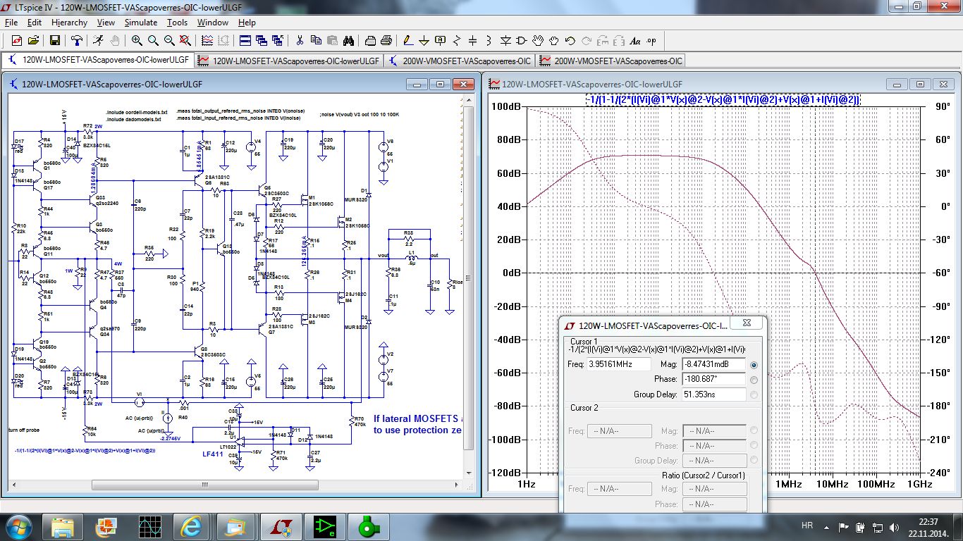

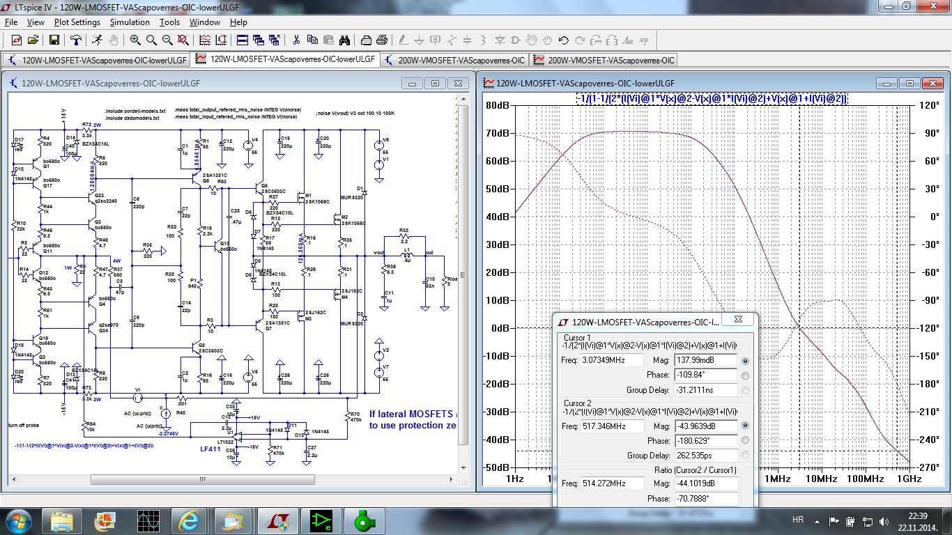

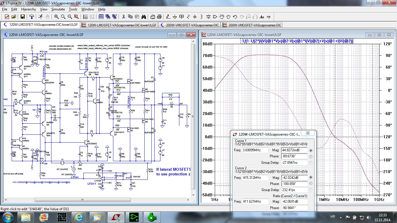

It is quite easy to simulate how an amp with exceptional PM of 90degree and GM of 42 dB can became unstable with no inductor, even with quite modest capacitance at the output. Adding small inductor of 0.5 uH parallel with 2.2 ohm put the amp back in safe stable behavior.
first - no cap at the output
second - 53 nF at the output
third - 0.5uH inductor and 53 nF cap at the output
Damir
