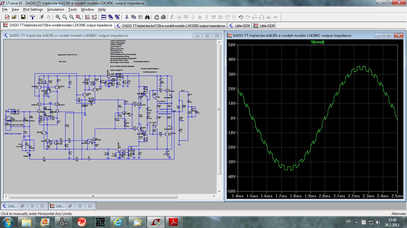

David... look the post #7 Damir
Yes. I noticed that Antonio's post #15 seems to be inconsistent with your #7.
If I understand Antonio's chart correctly then the outboard capacitor circuit results in a much lower input into the feedback network. This is makes sense to me.
I don't understand your result where a low value shunt added across a source makes no difference. I suspect there is some issue, perhaps with how the cable source is handled, but I have not yet checked and did not want to comment prematurely.
Best wishes
David
Is current source a reasonable model?
I have no RF model experience. How should cable capacitance and inductance be handled?
Best wishes
David
Antonio simulation shows output voltage before an inductor(.ac sim) only. Certainly it shows an influence of the cap connected after an inductor influence, but the same influence shows on the voltage after an inductor. I was trying to show the difference between output voltage(or in my case, impedance) after and before a inductor, actually a speaker line garbage suppression by showing V(out)/I(I1)/V(vout)/I(I1) in dB. Could be that my result are not good enough, I did not include any cabel resistance/capacitance, but I think it was not importand.
Sorry but it not easy for me to express my self in English technically correct.
BR Damir

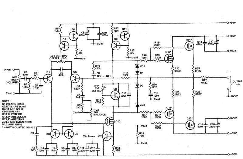

It is reported more than once that application of output inductor may lead to higher distortion and less (!) stability with some amps. I remember that some John Linsley Hood amps disliked it and Alexander current feedback amp deliberately avoided using it because he noted that harmonics are more pronounced. Also, Rod Elliott's P3A with CFP output stage dislikes output inductor.
Its not that JLH amp disliked output inductor, just JLH used output resistor instead and thus decremented a dumping factor.
Dadod,
JLH designed many amps. The amp that showed some instability with output inductor was one of his MOSFET amps.
Do you mean this amp? I never used it with output inductor so I can't tell.
