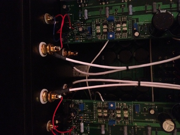

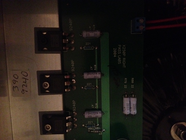

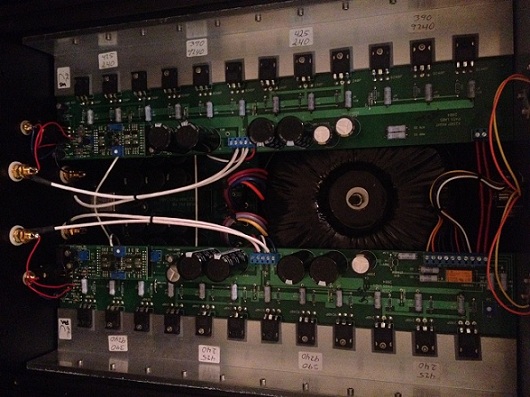

here the pics. Hopefully it explain why I was saying it is exactly like the X250.5
As far as I can see is on the UGS module and there are 3 power resistors instead of 2 at the front.
so - conclusion - they aren't the same 😉
your X250P is mix between X250 and X250.5
newish hardware and pcb organization but - X250.5 is having newer UGS module , along with newer bias gene , and some SE bias , while yours is having older UGS , mosfet bias gene , no SE bias
bummer - if you're going to search another one to buy , you must look for exactly the same (transitional ) specimen
yeah I know, it is a bummer and I was thinking of that yesterday 🙂 .
I am going to buy another one a little later and I have to make sure it is the same late production.
Just thought aside: at first you thought they had different number of MosFets, but now you can see it is not the case.
Also, boards look identical BUT if you look at the first generation they are different not just in layout, but it is missing some BJTs and other little stuff.
I agree, the UGS module is different, but if you look closely the only difference I can see is that it is using the dual Toshiba instead of single lower quality FET.
Strangely, Pass uses the same UGS module on the 250.5 and 350.5 but then the 160.5 100.5 and other models use the UGS with TO220 instead of SOT BJTs which is marked as UGS5.0 (note that on my revision the UGS is marked as 6.0).

you know - even if I know answer to your questions ( except why particular UGS generation is used where ) , it's really up to Pa to reply
btw - no odd number of mosfets , so no SE bias based on Mosfet CCS
generally - one can make SE bias establishing CCS in several ways - using either simple resistor , or mosfet or BJT based CCS
if your UGS is marked as 6.0 ....... then you don't have any reason to worry ... except need to triple check potential amp you'll gonna buy
how is your amp having UGS generation , which is chronologically later than amp itself , is puzzle for me
