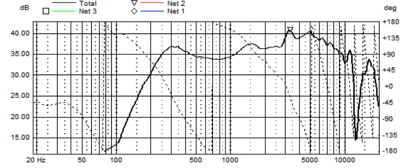

Oh I agree with you, but if you look at the white paper written for the development of the 800D you will see on page 13 in the bottom right hand corner (img 14) a measurement of the FST without a crossover and it too shares the same 5dB peak at about 3.5kHz. Yet in the measurement for the driver in the cabinet with the crossover (img 12), the peak has suddenly vanished. Where did the peak go?
Now here

If you say it's only accurate down to 1.2kHz then how come all measurement programs, that show you the accuracy cut off for the given gate length, say different? ARTA says this is accurate down to just below 300Hz providing I've set the gate accordingly, as does Holm. They ain't gonna lie about something which is presumably calculated mathematically.
Besides what makes you choose 1.2kHz?

The graph posted looks heavily smoothed and i can tell from the reflective trace to where it starts to smooth out that the software is fudging the results.
As I wrote in the previous post, there is no smoothing applied whatsoever in that measurement. That's ARTA specific unsmoothed analysis. I can show you what it looks like with smoothing if you wish, but I don't really see what the point of that would be.

5th did not post up the impedance magnitude and phase , interesting to see if there were any wrinkles present
Wrinkle at 3.5kHz, no surprise there.
attachment.php
Frequency response + phase without the crossover.
I don't really see why the phase angles through the impedance are important though. I didn't make any impedance measurements of the driver myself because the entire system is active, so I have no absolute need for them.
attachment.php
Yeah that's a pretty nasty wrinkle , is that in cabinet or free standing ...?
