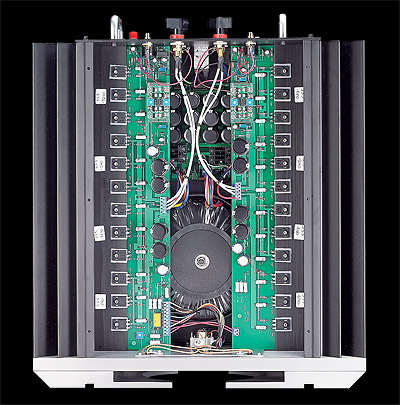

Anyway looking at pictures on the net of the X250 and X250.5 looks like they have same number of output devices.
They really look identical, at least from the pictures, for the exception of the UGS which looks like it is using instead of single lower qualuity input devices, uses the SJ108/SK389, which should make up for the sonical difference.
Last I checked my UGS module doesn't even use two devices from the same family...I can't say more as it is a propreitary thing ahahahahaha

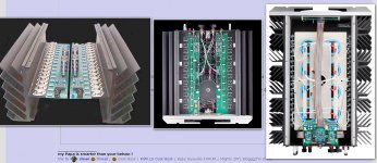

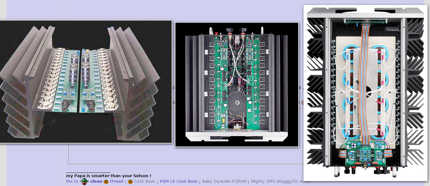

X250 - older generation UGS based FE , follower style OS with mosfet bias gene , 4 mosfets in OS quadrant,no SE bias , 2x38-ish Vdc PSU
XA200.5 - newer UGS based FE , follower style OS with shunt reg bias gene,7 (or 8) mosfets in OS quadrant,SE bias , 2x34-ish Vdc PSU

for the number of MOSFETS I have just checked pictures of the inside on the web, counted the number of output device and concluded they are the same number.
Maybe there are hidden devices don't know, but it's unlikely.

anyway look at this , X250 :
X250.5 (which I didn't commented ) : (attached)
XA200.5 :
conclusion - none combination of these (X250 , X250,5 and XA200.5) is having same number of outputs ........ and , just to repeat , none of them is having any resemblance of Aleph OS
disclaimer - my (secret spy) little bird at PL is sometimes tricky , maybe because I'm asking silly things all the time

Said that, to complete your thoughts on the X250, your picture referes to the first prodcution.
On mine, the latest one, I don't have TO3.
Mine looks EXACTLY like the last picture you posted which is the X250.5
I will attach some pic tonight if you want me to, that will help clear out this little debate 🙂

previous post (to quoted one) was maybe little confusing; anyway - look at my last post - one picThis is a cool picture BTW 😎
amps are - from left to right - X250 , X250.5 , XA200.5
regarding your and mine spks - there is no use in trying persuading ZM in liking modern speakers ....... I'm completely on romantic side of speakers
I'm pullin' your leg , and really not saying that your speakers aren't great ( even if I really don't care for them ) , so - it's completely irrelevant what's my reference .
so - you're having transitional model , between X250 and X250.5
probably even Pa can't remember all variations during all these years .
what's important - you're having great amp , it doesn't matter which generation it is ......
