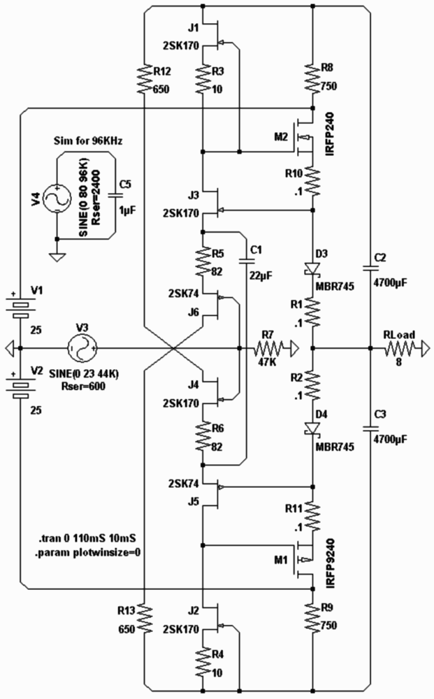

In my mind: two emitter coupled Alephs in compliment, as
one giant voltage following diamond buffer... But Pass said
it looked to him more like Hawksford or Cordell...
At that time, both my input buffering and error comparing
transistors were bipolar. Which was stable reference for
comparing and correcting an error, but not great in other
ways (like bandwidth).
So now we have JFETs as source coupled gate followers?
Theory of operation hasn't really changed all that much....
Only the components chosen somewhat better. You might
have to tweak the little resistors in the middle to balance
the diamond. Use of matched pair JFETs 2SK389/2SJ109
would probably help.
Don't know if its good enough to qualify for your purpose,
but I was thinking to follow up after an Aikido...
Its biased into Class AB with a real smooth crossing. If you
bias with intention only for Class A, then Schottky nonlinear
resistances in the output can be omitted.
C1 seems necessary to quench oscillation? It may just be
LTSpice, but maybe it stores energy equal to the MOSFET
gates? I'm not really sure why it sims so much better with....

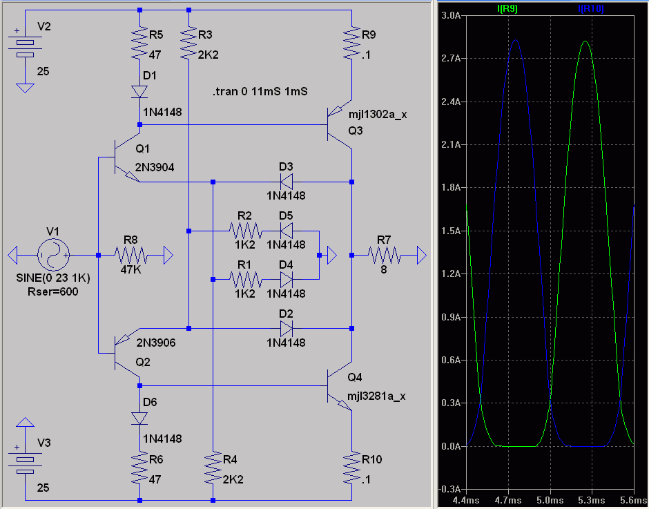

Yes, probably similar. Hard to tell without working values to plug
into the sim. Where exactly does yours smooth the AB crossing?
kenpeter said:Yes, probably similar. Hard to tell without working values to plug
When diodes start conducting to the ground. Actually, when one opamp goes to class B due to increased (through diode) current in LTP tail, the complementary opamp stays in class A region.
Values depend on transistors. Values in current mirrors depend on Rbb of output transistors and selected ratios. Values of "short" tails are selected to deliver peak output current divided by a mirror ratio. Values in "long" tails again depend on mirrors' ratio, but supply enough current until long tails start supplying the current.
In reality, I had 4 trimmers in tails. But for IC trimming would not be needed: geometry works instead.
Class B working fine, but no luck finding a bias point for AB.
What am I doing wrong?
Silicon diodes not shuting down quiet as I'd like either...
If its not merely the symptom of my improper bias, I think
a series pair of Schottkys with similar voltage drop might
be smoother...
I throw in the models that I used for output transistors.
I've hacked my default library, if your LTSpice can't find
the needed model, I may have pointed the wrong place.
Decrease long tail resistors (to rails, with no diodes in series).
Also, try Shottkys in class B tails (with diodes to ground), so less class A bias current will be needed. Increase mirrors' ratios for higher OL gain.
kenpeter said:OK, after playin with it a while I kinda got AB to smooth out...
Are these resistor values closer to right?
Looks right. Try load on twice lower resistance and see what happens. It should turn into a current output stage instead of voltage output one.

kenpeter said:And here's what my circuit makes of the same signal....
Blame the smoothness on Schottky...
Yes, your amp turns into class B smoother.
Mine was designed as a bullet-proof guitar tube amp output: it protects itself against overload (shorted output or wrong cab connected) refusing to provide more current: it turns into a current output amp when overloaded.
Two stage MOSFET input buffer. It has quite high input impedance, even more than 100kohms.
