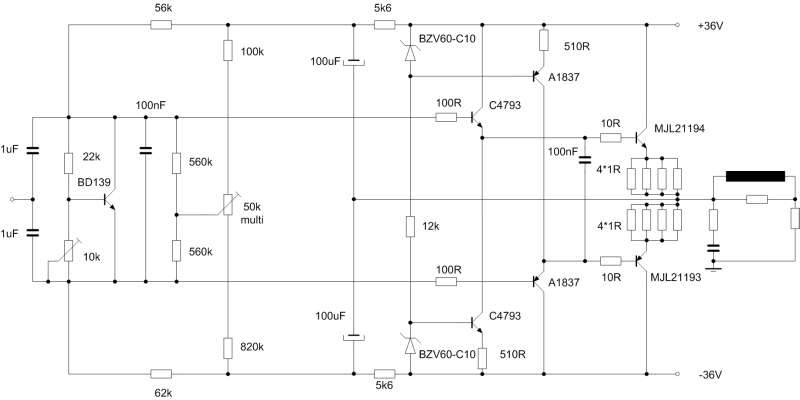

sajti - i am really tempted to drop my idea on using the ccs's in the driver of the transistors for some project where they would suit better and to try your buffer.....
hmmmm.
when You would be able to tell a bit about the sound or at least to give us some measurements.....
thanks....

sajti - can You explain me if i would have those spikes i can see on simulator also in the real ciruit..... probably not - but i would like to know why i have them there (on simulator)... THNX...
this is the schematic and in the next post will be the instrument measurement....

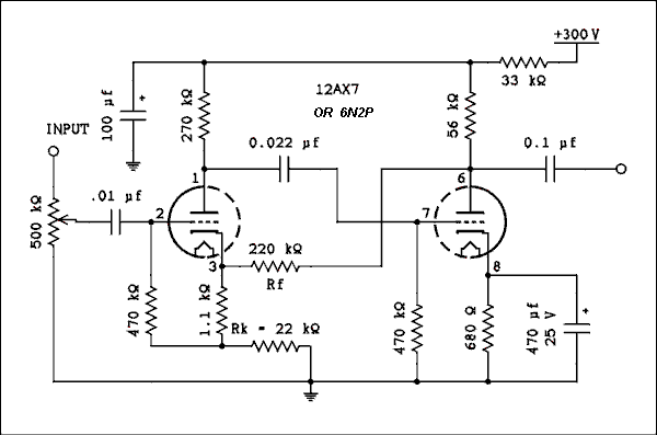

Hello Sajti
How much warm the predrivers are being ?
Have you try it with a higher value emitter resistors, like 0R33ohm or 0R47ohm ?
Here is the a tube circuit, but I'm not sure it could work with your
Triple darlington circuit ?
Thank
Bye
Gaetan

sparkle said:insturments are here....
I have no spikes on square waves. But my amplifier use MJE15032/33 as predriver, NJW0281/0302 as driver, and 8 pairs of FJL4215/4315, as output.
So try to modify the base resistor values, or add some 10-100pF C-B capacitors.

sparkle said:sajti (or anybody else)... how about this - regarding the bootstrapping of the resistor divider.... 🙂
That looks OK for me.
Sajti
in my first version, I use BC639/640 as predrivers. They can handle 10mA without any additional cooling. The rails are +/-35V. So BD139/140 can handle 10mA as well.
Higher emitter resistor means higher distortion. So I try to keep it as low as possible. (The minimum value depends by the thermal runaway)
This circuit can be OK, but with other tubes. I recommend E88CC, or ECC99. And higher bias. 6-8mA would be OK.
Sajti

i'll do that later today... my sims are at my home pc...

sajti - how about an idea...
looking at your schematic - would it be nice to put a ccs in each emiter of the predriver tranistors (like i have suggested for driver transistors)... or maybe to do that on driver transistors in Your schematic??....
what do You think ???

It's possible to do. I don't use it, because I use no PCB, so I always try to keep it simple...
