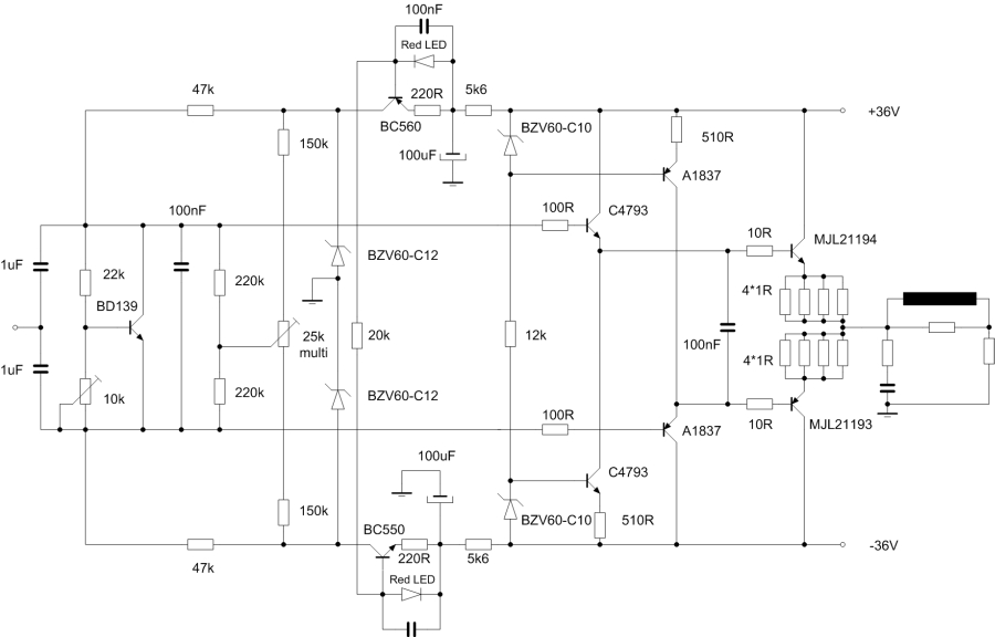

looking at the page http://www.wimdehaan.nl/hybrid/6463hyb/index.html i came on the idea to try the dc correction circuit like proposed there...
it seems to be working - and the bandwidth of the amplifier increased a lot - don't know f i can trust that .. (i tried that in the sim and as we all know thy are not so perfect and accurate) ....
so here it is - the next version of the amp from the post no16.
NSCA is still under consderation - if it might work it will be also nice to get the output transistors not to switch of.... oh well.....
opinions please....
thnx...
opinions please....
thnx...

Originally posted by sparkle the other thing that is bothering me with all the designs proposed here is the dc offset correction... it is usually made by using a trimmer in the positive rail, over the Vbe multiplier or biasing diodes and with that resistor we correct the dc offset.... i am affraid that this method is MAYBE not good enough....
My friends hybrid also uses this scheme, the problem is that way it is implemented means the output stage bias and dc offset are not independent controls and you have to fiddle with both of them when setting it up. However, it does work and he was able to get a very low dc offset (you have to set it up when the amplifier is at normal operating temperature)
I like the NSCA idea, I tried to make a design like this a couple of weeks ago but couldn't get it to work and gave up. I didn't have the NSCA design as a starting point though. I have no idea if it's proven to improve sound quality.
i know - it is a bit complicated to set the bias and dc offset - but it should work.... i think that the dc offset network in post no. 31 is a bit more "relaxed" way to do it... i was playing a bit with it and found the correct values of the resistors with no problems ......... i will post that sch tommorow too..... 😀

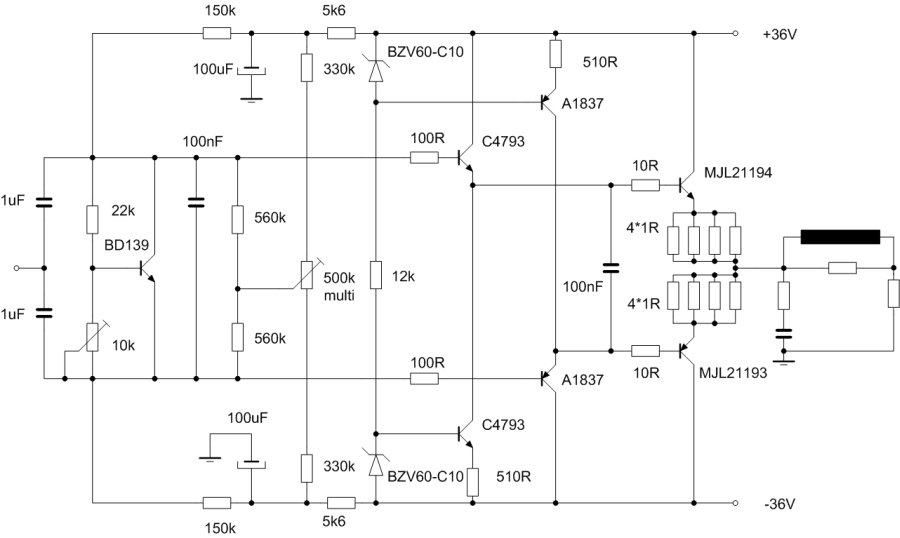

sparkle said:i played a bit with noise cancelation CBS240 proposed...
i still think that post no.16 is better way to go....
in attachement of this post is the sch. i was playing with..... 😀
The idea is not do much noise cacelation, but correction of the non-linear components that are related to the Darlington output devices. The error amplifier transistors or rather one of them, Q3 or Q5, can be mounted to the heatsink with the outputs to control thermal bias changes.

sparkle said:and also this version is here too...
opinions???
The input iimpedance of this buffer is less, than 20kohm, without any load connected. So it's not useful for tube driver.
What I found:Bootstrapped bias resistor string easily set the output close to 0. My amplifier has less, than 20mV offset with hot or cold heatsink. The input impedance is approx 70kohm, with 2ohms load.
Sajti
i also don't like that one... to complicated..... however i do like your output and it is still in the game.... ... just checking all the options to better decide... thank You for info....
