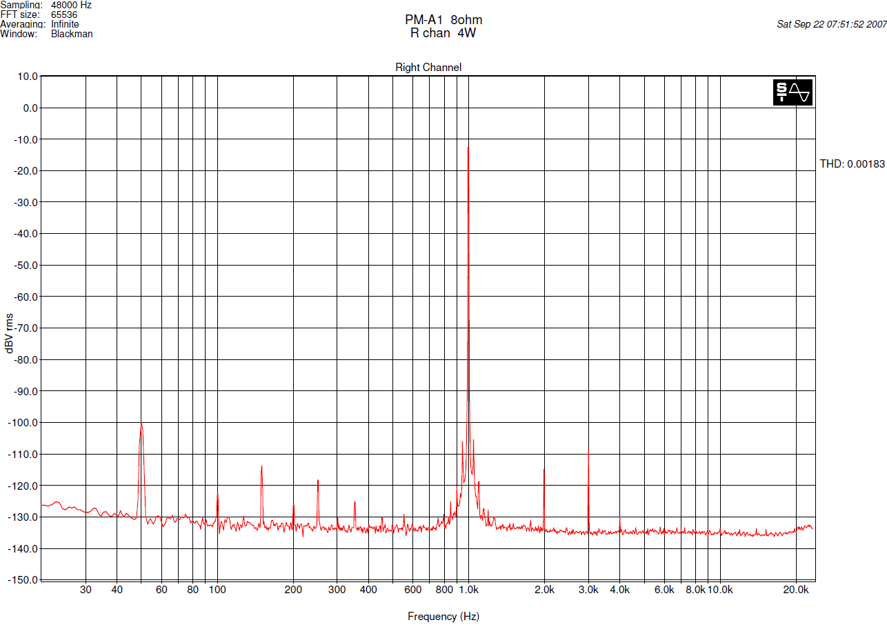

I have plenty of old measurements, like this one 4W/8ohm (Y axis dBVrms is wrong designation, it is not calibrated). The buffer keeps only low order harmonics at lower power like this. Focusrite in your plots created the high orders.

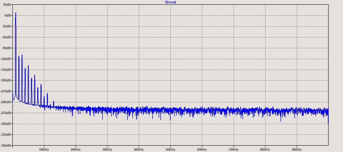

Simulation is small step for some, but big step for me, it's essential, I can change and try many things before I go por prototype.
Look attached plots, simulated and measured on the prototype buffer. That buffer was exactly as in simulation, no changes yet.

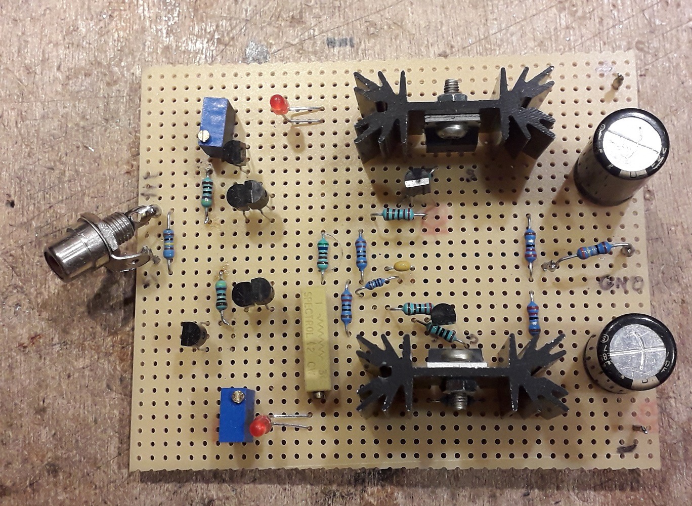

Buffer was harassed for stability and performance, followed with some tweaking, schematics changes and more measurements. I’m now satisfied with overall performance and stability.
Goal of this whole exercise was to check if simple low dissipation and output power pure A class amplifier with no GNFB, which measures and sounds excellent, is feasible. Results say that it is. Simple buffer can provide an excellent performance.

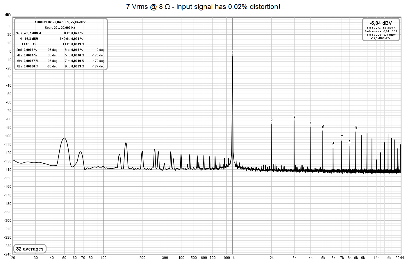

Distortion, as seen on previous posted measurements is less than 0.002% at 1W and remains fairly low at high levels. Here is attached measurement at 7 Vrms output, what is max. output of signal generator. At that level signal generator is declared to have 0.02% distortion. I actually measured signal generator output distortion as 0.016%. So, amplifier distortion is 0.012%. Harmonics distribution is from the generator, not from the amplifier.
